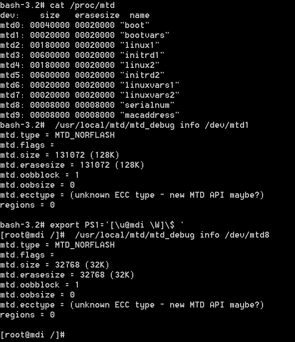

Has anyone yet figured out why the serialnum and madaddress partitions error out with the doesn't start on an erase block boundary -- force read-only error? I am wondering if this can be fixed easily and the ability to change the serial number using serial or by the testmode webpage can be recovered..
I haven't yet but I am planning on trying to read the kernel messages of my genuine mdi and comparing.. don't know if it would be worth the effort?

I'm going to keep on researching this, looks like it might be different hardware? can you even change the erase block size? lol..
edited to add.. This is from a genuine MDI where it's very easy to change the serial..

ok.. I really have no idea what I'm, doing, but....
the test below is part of the kernel messages of a genuine MDI..
Jan 1 00:00:07 (none) user.notice kernel: cfi_cmdset_0001: Erase suspend on write enabled
Jan 1 00:00:07 (none) user.debug kernel: erase region 0: offset=0x0,size=0x20000,blocks=127
Jan 1 00:00:07 (none) user.debug kernel: erase region 1: offset=0xfe0000,size=0x8000,blocks=4
Jan 1 00:00:07 (none) user.info kernel: KARO flash: CFI device at 0x00000000, 16MiB, 16-bit
Jan 1 00:00:07 (none) user.notice kernel: 10 cmdlinepart partitions found on MTD device flash0
Jan 1 00:00:07 (none) user.notice kernel: KARO flash: using dynamic partition definition
Jan 1 00:00:07 (none) user.notice kernel: Creating 10 MTD partitions on "flash0":
Jan 1 00:00:07 (none) user.notice kernel: 0x00000000-0x00040000 : "boot"
Jan 1 00:00:07 (none) user.notice kernel: 0x00040000-0x00060000 : "bootvars"
Jan 1 00:00:07 (none) user.notice kernel: 0x00060000-0x001e0000 : "linux1"
Jan 1 00:00:07 (none) user.notice kernel: 0x001e0000-0x007e0000 : "initrd1"
Jan 1 00:00:07 (none) user.notice kernel: 0x007e0000-0x00960000 : "linux2"
Jan 1 00:00:07 (none) user.notice kernel: 0x00960000-0x00f60000 : "initrd2"
Jan 1 00:00:07 (none) user.notice kernel: 0x00f60000-0x00f80000 : "linuxvars1"
Jan 1 00:00:07 (none) user.notice kernel: 0x00f80000-0x00fa0000 : "linuxvars2"
Jan 1 00:00:07 (none) user.notice kernel: 0x00ff0000-0x00ff8000 : "serialnum"
Jan 1 00:00:07 (none) user.notice kernel: 0x00ff8000-0x01000000 : "macaddress"
Below is the messages from a clone.. I got the genuine messages by cd'ing into the folder and using cat to display them.. On the clone I used dmesg.. They look like the same messages??? Anyways, the clone has the erase regions backwards?
<5>cfi_cmdset_0001: Erase suspend on write enabled
<7>erase region 0: offset=0x0,size=0x8000,blocks=4
<7>erase region 1: offset=0x20000,size=0x20000,blocks=127
<6>KARO flash: CFI device at 0x00000000, 16MiB, 16-bit
<5>10 cmdlinepart partitions found on MTD device flash0
<5>KARO flash: using dynamic partition definition
<5>Creating 10 MTD partitions on "flash0":
<5>0x00000000-0x00040000 : "boot"
<5>0x00040000-0x00060000 : "bootvars"
<5>0x00060000-0x001e0000 : "linux1"
<5>0x001e0000-0x007e0000 : "initrd1"
<5>0x007e0000-0x00960000 : "linux2"
<5>0x00960000-0x00f60000 : "initrd2"
<5>0x00f60000-0x00f80000 : "linuxvars1"
<5>0x00f80000-0x00fa0000 : "linuxvars2"
<5>0x00ff0000-0x00ff8000 : "serialnum"
<4>mtd: partition "serialnum" doesn't start on an erase block boundary -- force read-only
<5>0x00ff8000-0x01000000 : "macaddress"
<4>mtd: partition "macaddress" doesn't start on an erase block boundary -- force read-only
<7>PM: Adding info for No Bus:usbmon0
<7>PM: Adding info for No Bus:mice
Is this what's causing the issue of the serialnum abd macaddress partitions not starting on an erase block boundary? Is this fixable? I am enjoying the challenge, lol.. but boy is this outta my league...
