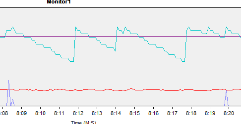

I ran into this with 12P a while ago (http://pcmhacking.net/forums/viewtopic. ... =60#p31620), I could see the knock retard in the logs but not the knock counts, eg here (blue = knock counts, aqua = knock retard):
The knock (which was simulated in my test) was in short bursts, and the counter was being cleared before the next log message was being sent so I saw knock related retard, but no knock counts.
I ended up ignoring the counts trace and just watching the knock retard, that gives a good indication of when knock events happen.

If you look at the log pic I posted earlier at around the 8:12 mark, you can see the amount of timing being pulled is decreasing until 8:14 when there's another knock event detected so it jumps back up to the max knock retard.
Then it starts decreasing again but almost immediately jumps back up because of knock returning.
