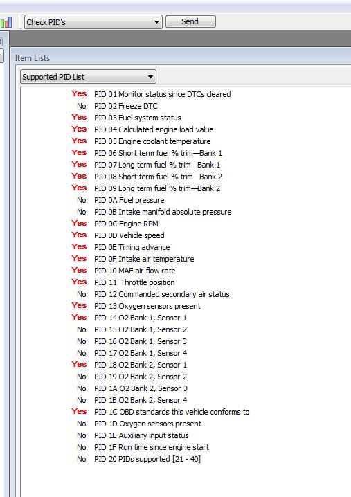

Anychance you can post a picture? Im not seeing it haha
Posts: 2585
Location: North Coast, NSW
Re: Software On ELM Street - OBD2 Software Development
Post by Jayme »
start by going view> toolbars > make sure data acquisition send command is ticked. then in the toolbar you will see the drop down box and send button shown at the top of this photo:

The supported PIDs are: 1,3,4,5,6,7,8,9,B,C,D,E,F,10,11,13,14,15,18,19,1C,1F,20
I think Im actually missing a few of those SAE PIDs in SOE. Will have to actually look into adding those.
