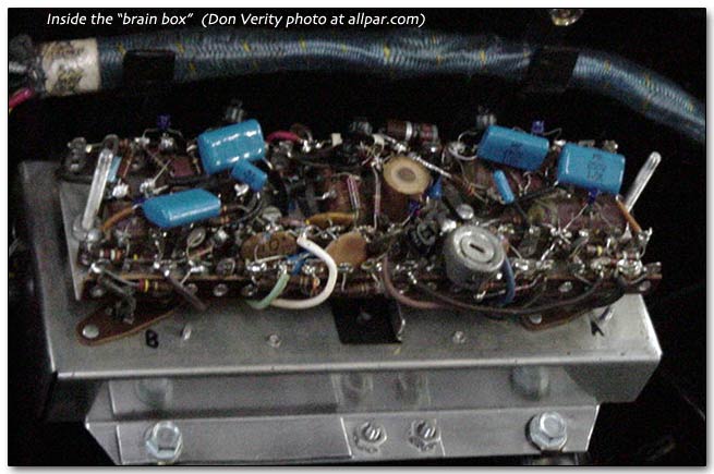

Ok next In line in this series is the 1957 Bendix Electrojector.Available as a $400us option on some pretty expensive metal - $4000+usd in 1957 for a vehicle is pretty heady money..
Depending on which sources you believe It was fitted to some 20-50 chrysler vehicles.Unfortunately the combination of shaking under an automotive bonnet and waxpaper capacitors in the ecu caused a callback of most systems from the field and replacing them with carbies.Two or maybe three systems survive in the wild with one being restored back to working order.
The system was a very simple map based one, crude but kinda backtothefuture likeImage

Here's the pic of the Bendix "ECU" minus the hotlink protection.
Re: Historical electric/onic engine/body management
lol looks very 50s
I feel so much better about my home made PCB's and electronic projects now :D
