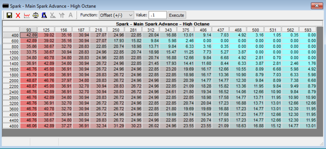

Re: tl866 programing a vs stock memcal
noobish question but what do i do to advance timing would i add or subtract from the values in the table
im sort of confused about that
