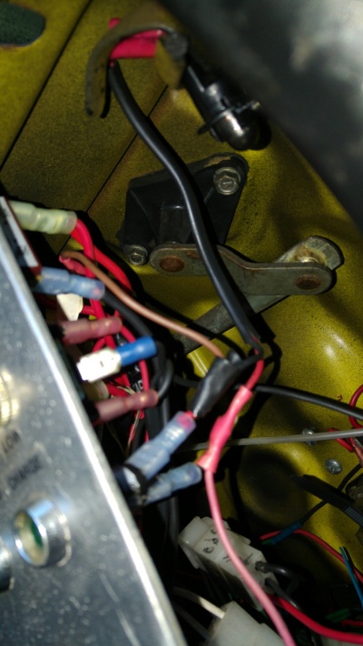

So it looks like the bulb is in parallel with the led, and no resistor. I am assuming this is an automotive led that takes 12v straight up and has a resistor built in, so this works as is.

I did actually go to the local auto elec they have set up alternators with no charge light before just a diode between an ignition source and the L terminal. They did think the LED woud be worth a try with no resistor as the later model one need only a small amount of current to start charging tbey thought.
The one we have fitted is very similair to the one Antus linked and has red and black wires potted into the fitting it's made for automotive use. It may well have a Resistor internal already which would be great if it did. This engine will be starting in the coming weeks so I think I will try it with just the LED in the circuit. Black to alternator and red to an ignition feed.
