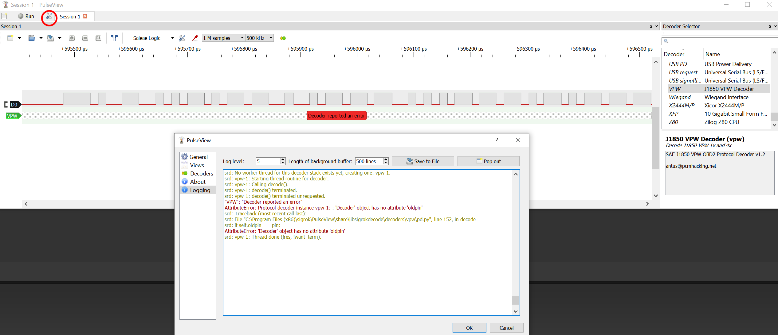

I managed to get it loading in pulseview, but I cant figure out why the debug level switch -l 5 produces no output. Or if it does, where that output goes. The decoder throws an error so its not full ported yet, but its closer. It ended up just needing whitespace fixes, and a reset function which calls init.
https://bitbucket.org/antuspcm/sigrok-v ... ea125ad974
Edit: Found it! In the gui
