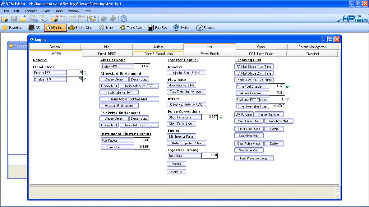

Wonder if it covers all the extra parameters EFI live has mapped out compared to HPT?
Re: VCM Suite now accesses EFI Live tunes
one would expect if its a HPT definition then no ?

Dylan wrote:Wonder if it covers all the extra parameters EFI live has mapped out compared to HPT?
The VCM editor with respect to 1290005 which is the one I have looked at covers the most important ones Boost spark Nitros spark and the NA VE table and the 3bar boost VE table plus all the VE verses TPS tables. With the boost spark being of particular interest to me because it is not accomodated with a VCM Suite operating system which I am currently using.
One that comes to mind that is not covered by VCM is the octane scaler tables which from my point of view is not needed anyway and there maybe others.
The VCM Suite editor coverage for the 1290005 when compared to the 2 bar VCM Suite operating system the only difference is those I have indicated.

Does HPT have injector dead times etc defined?

Dylan wrote:Does HPT have injector dead times etc defined?

Looks good
