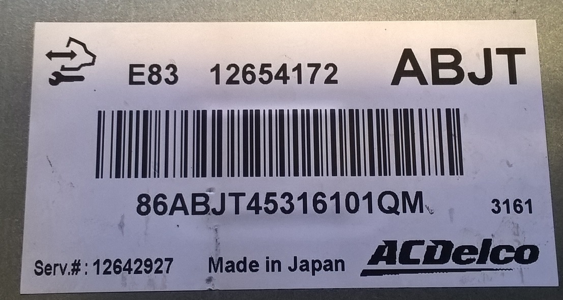

that may have been the case before i fucked with it, i dare say they wont want to touch it now for free!
also here is the image of the current PCM.
