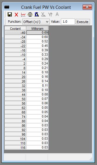

im looking at this table
- crank.JPG (41.17 KiB) Viewed 7381 times

I'm not seeing that one at all.
I'm using VX_V6_SC_$A5K_Enhanced_V1.3e
And looking at this table

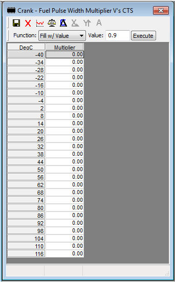

OK, been looking at the VT V6 SC $A5G XDF which has the above table, comparing the data to the VX V6 SC $A5K XDF and that table seems to labelled as the table I referenced in my post above?The1 wrote:im looking at this table
Re: Adjust injector pulse for coolant temp
ok didn't know which A5 you both were refering to, have fixed and updated VX VY S/C with Crank and Cold start Items.
