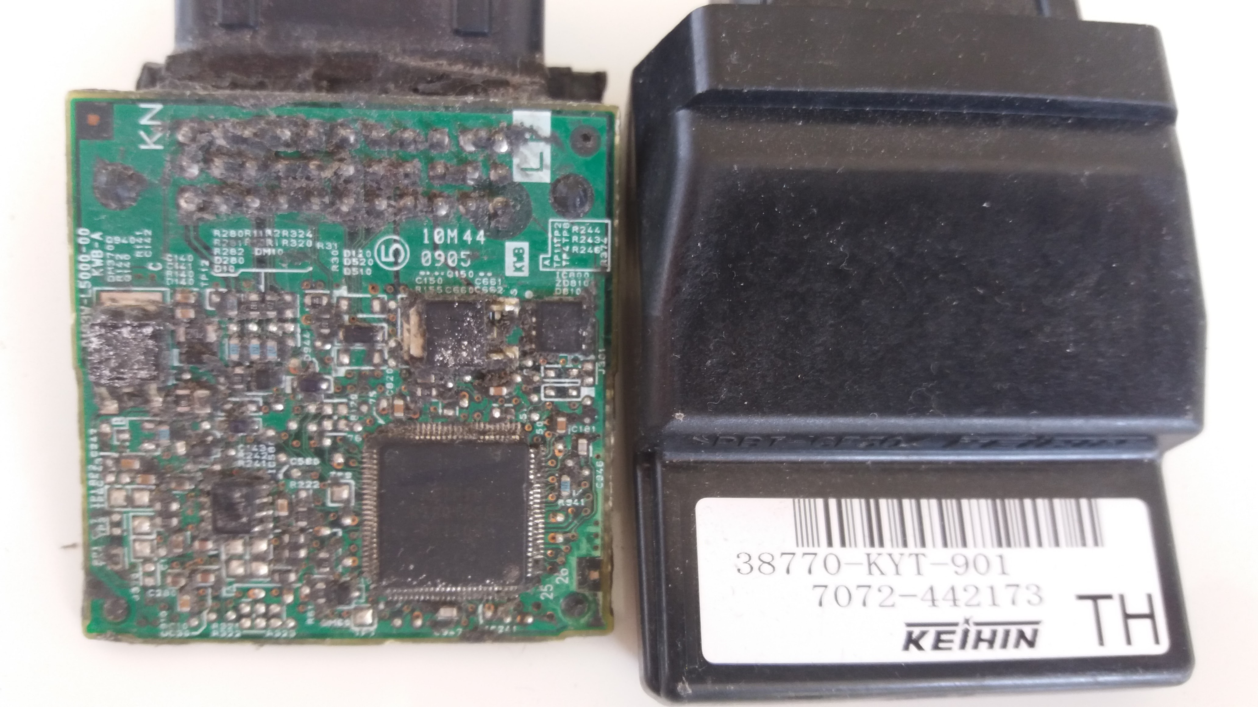

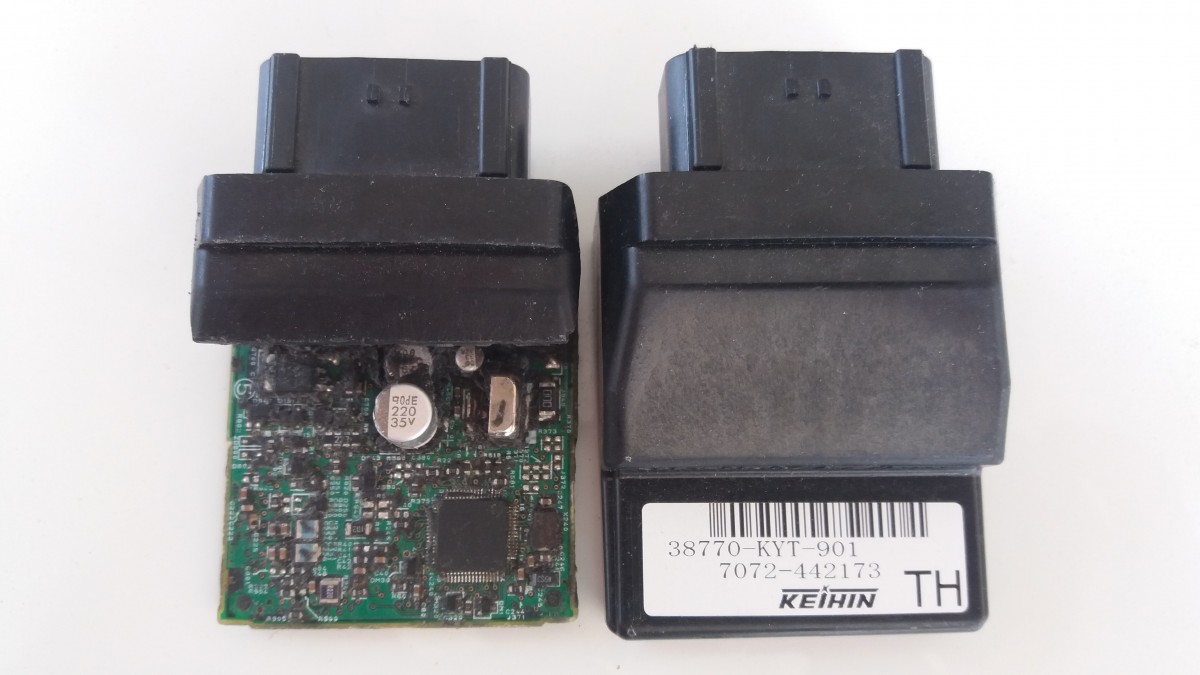

I will up load some pictures of the Honda scoopy ecu I have later this weekend. I have one with most of the potting removed.

is the potting on your ecu hard? like an epoxy sort of deal? mine looks like it's been sealed up with silicon, or polyurethane. something rubbery anyway.

Sorry forgot that it is only a long weekend in W.A. I will try to organize some better lighting so the pictures are high quality. The material is not hard it is just tricky to remove without damaging something. Google ECU potting material removal and you will find some advice on different methods . I do not know of anyone who has provided information on using a cheap tool to read the flash from the processor. I am assuming the pads on the lower left side of the board are for a BDM or a similar tool.

I am not sure what the material is, I will try some nail polish remover tonight and see how it works. I am not sure how it would work as the whole inside of the case is filed with the material. It must be close to a 1cm think in places. I probable should try and work out which pins the pads are connected to. It may be possible to read the chip using a cheap tool. I am not very hopeful based on my lack of talent and the difficulty I have seen others have had on similar projects.
