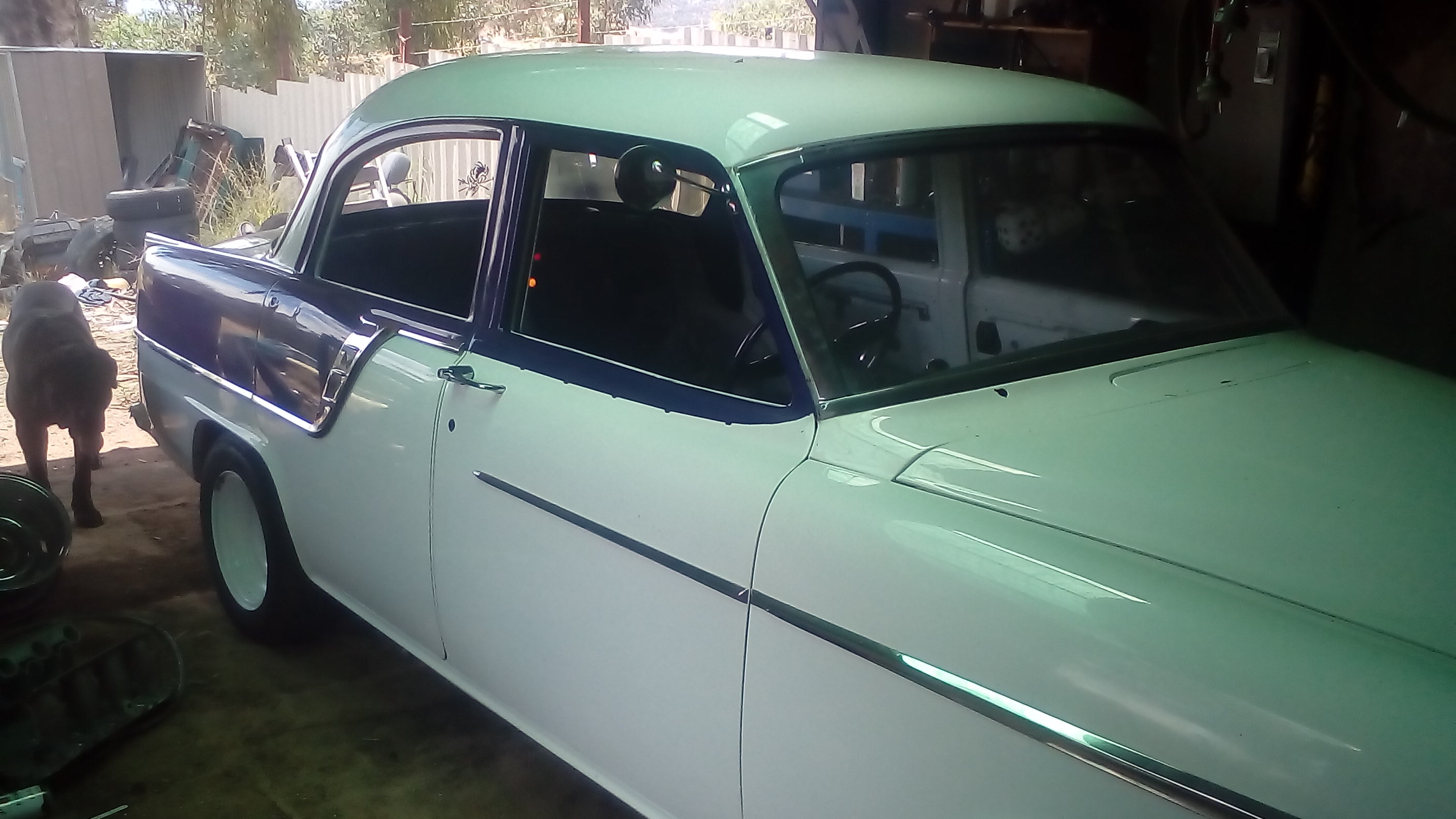

Re: royal plum hx kingswood, daily drive, 355
In the meantime, here's a couple pics of my other toys/projects
