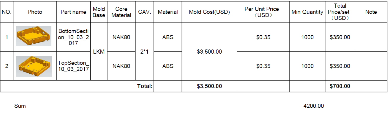

Well.. Iv found the cheapest option.. well in the long run.
Technically its ideal.. but.. f**k me... that mold cost.
Figured this might be interesting to others that ever look into it.. as theres not alot of info out there about it.
So.. $4200usd.. is about $5558aud. So the initial 1000 cases will be about $5.50aud each
Going to have to go with 3D printing for the time being I think. Simply too much outlay straight up.

Right so, going to get 50+ units made via professional 3D printing using the mob that quoted the injection mold. Its going to be a few hundred, roughly $8 per case. Based on the examples, looks like their high grade 3D printer does some pretty good work.
Going to have to save every penny to put towards the mold. Just makes you realise the magnitude of manufacturing, everythings done in multiples of 10's of thousands of units!.
