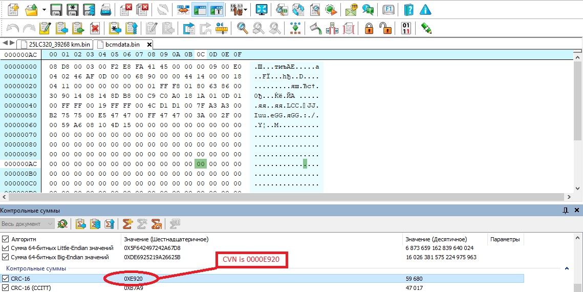

04colyZQ8 wrote:I can segment swap certain GM BCMs. I have a educated guess as to certain booleens are for, trouble is I can't figure out how to calculate the checksum (CVN) I've tried flashing without updated checksums and it bricks at 98%, but then is recoverable with GM SPS. The bins I have to don't show the CVns from GMs website? So I don't know they are calculating the checksums? It's likely some kind of CRC-16?
Here is a 2006 hummer H3 BCM stock lighting segment bin file. F2 E8 FA = the segment part number (15919354) Gm says the CVN is 0000E920 but I can't find that in the code, and I cannot calculate that value using 8, 16, CRC, so what gives? I'd guess the 08 D8 to be the checksum location (first 2 bytes) but I also can't figure out how that's calculated.
08 D8 00 03 00 F2 E8 FA 41 45 00 00 00 09 00 E0 04 02 46 AF 0D 00 00 68 90 00 00 44 14 00 00 18 04 11 00 00 00 00 00 00 01 FF F8 01 80 63 86 00 30 90 14 08 14 8D B8 00 C9 C0 A0 18 1A 01 0D 01 00 FF FF 00 19 FF FF 00 4C D1 D1 00 7F A3 A3 00 B2 75 75 00 E5 47 47 00 FF 47 47 00 3A 00 2F 00 00 59 A6 08 10 4D 15 00 00 00 00 00 00 00 00 00 00 00 00 00 00 00 00 00 00 00 00 00 00 00 00 00 00 00 00 00 00 00 00 00 00 00 00 00 00 00 00 00 00 00 00 00 00 00 00 00 00 00 00 00 00 00 00 00 00 00 00 00 00 00 00 00 00 00 00 00 00 00 00 00 00 00 00 00 00 00 00 00 00 00 00 00 00 00 00 00 00 00 00 00 00 00 00 00 00 00 00 00 00 00 00 00 00 00 00 00 00 00 00 00 00 00 00 00 00 00 00 00 00 00 00 00 00 00 00 00 00 00 00 00 00 00 00 00 00 00 00 00 00 00 00 00 00 00 00 00 00 00 00 00 00 00 00 00 00 00 00 00 00 00 00 00 00 00 00 00 00 00 00 00 00 00 00 00 00 00 00 00 00 00 00 00 00 00 00 00 00 00 00 00 00 00 00 00 00 00 00 00 00 00 00 00 00 00 00 00 00 00 00 00 00 00 00 00
