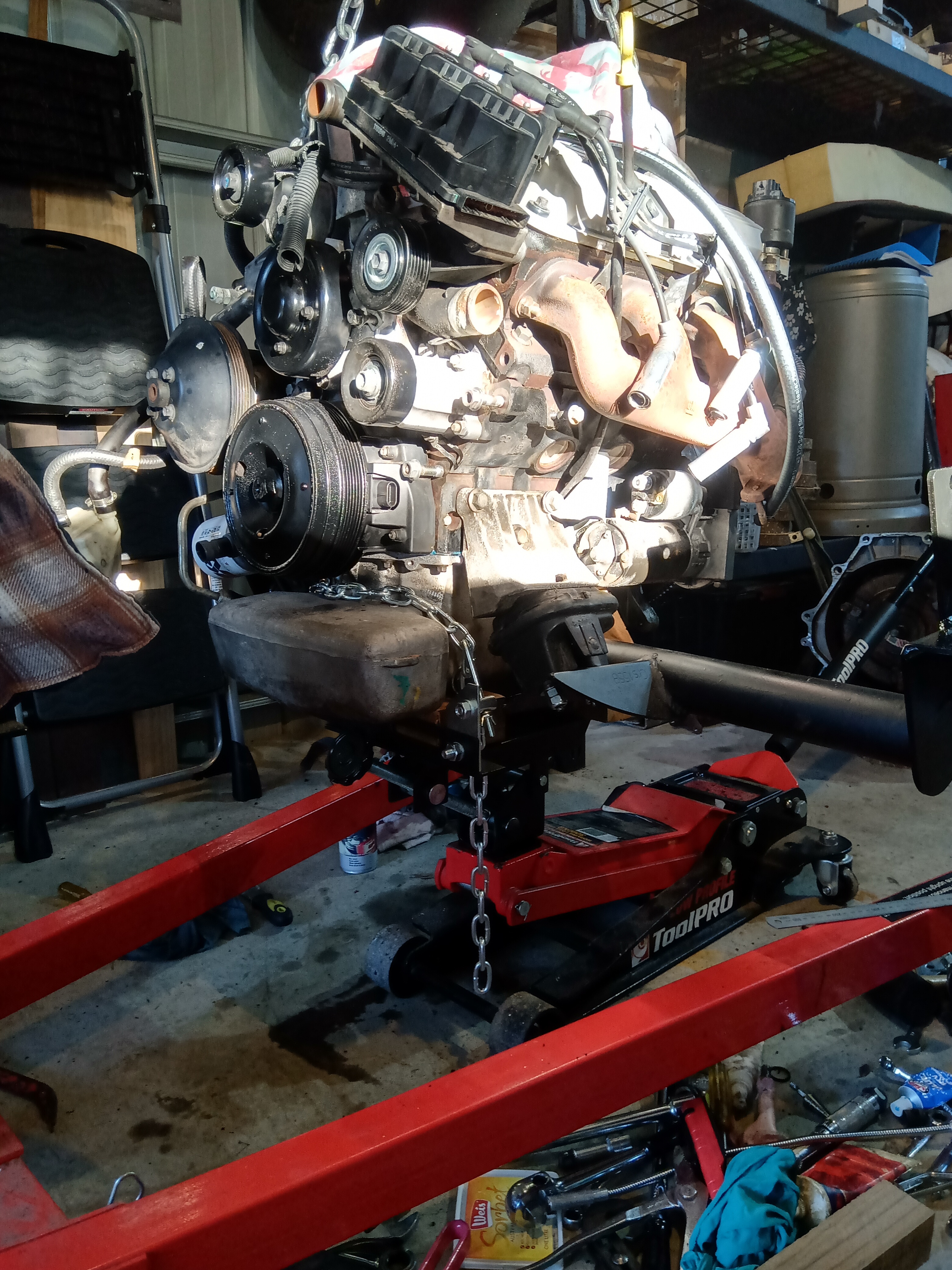

Yes, looking forward to the loom getting back to me as I cannot fit the engine without it due to the engine sitting so close to the firewall and under a cowl section. Installing the engine will also be difficult as the cowl means that I cannot use a crane, the engine will have to come in from the front an up into place. So I have modified a transmission lifting jig to hold the engine onto my jack. I will be fitting out-riggers to the jack to stop it from tipping over. The transmission will have to come under the van from the side and then be man-handled onto the jack and then lifted into place - my worn out back and shoulders are already aching in anticipation of that saga. LoL

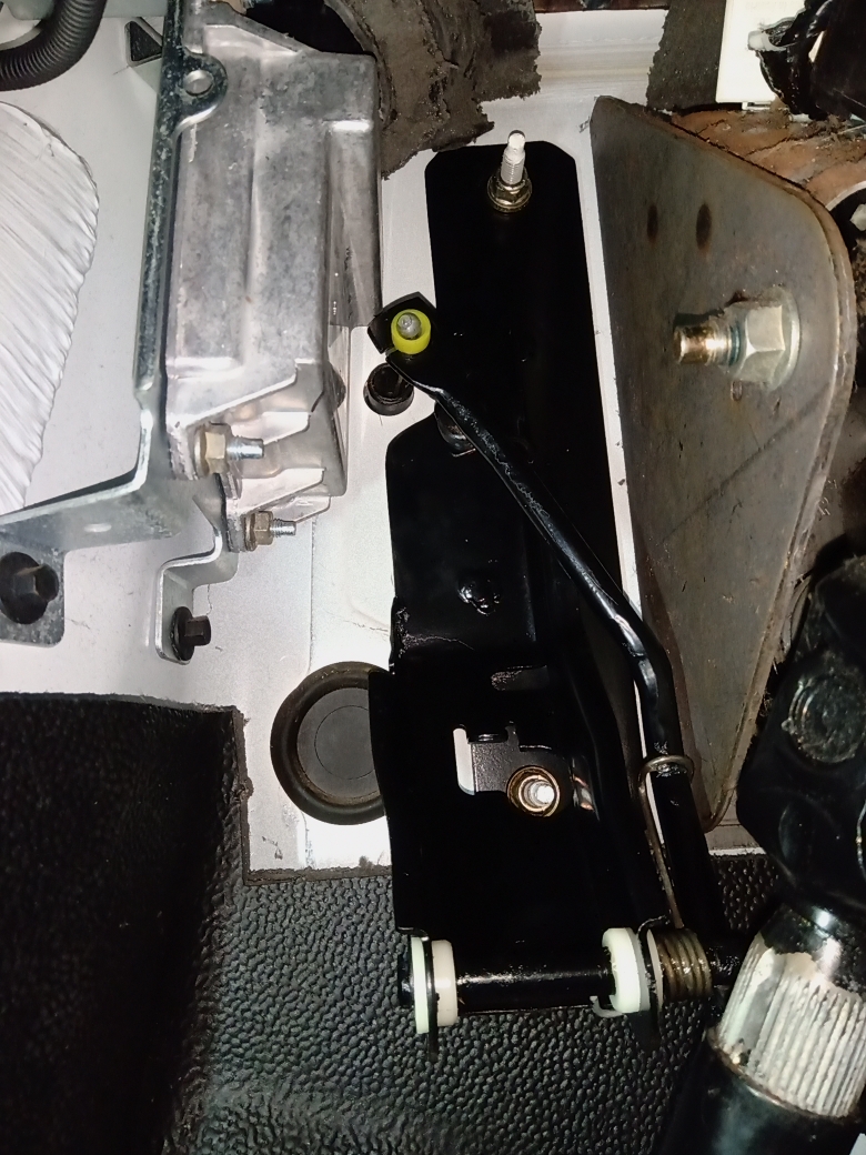

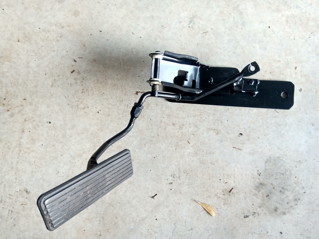

I had to change the throttle pedal assembly from an electronic to cable operated version. So I modified the original VY Commodore assy and managed to fit in to the left of the steering column on studs already fitted to the firewall. Also was able to use an existing hole for the cable to run through. The pedal shaft was modified to allow for a custom pedal height - flat with the brake pedal. In the picture it looks like a funny angle but in practice is really comfortable and easier to modulate than the Ford item.
