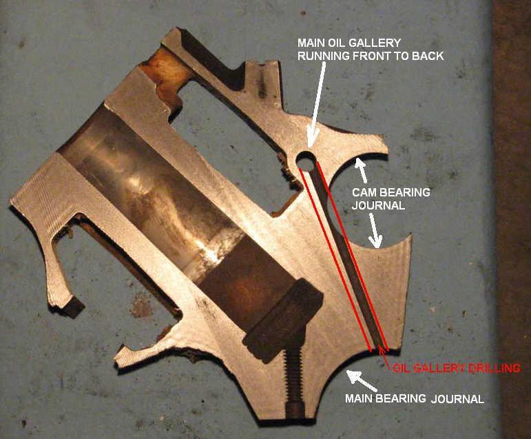

As for the core shift issue a common mod is to drill the galley a bit bigger to fix the issue. I have head its drilled to 10mm. The stock size apparently is 7mm or so.
I checked one a few buick blocks. the sizes go from front to rear iirc 10mm,9mm, 8.5mm 10mm so they are pretty substantial for these engines at least.
I got this pic from a vs which is pretty interesting.

By that pic it would only take a small bit of crud to starve the bearing.
I've drill main gallery tunnels front to back on chev small blocks because some of them have misalignment issues but never any others on chevs or other blocks. It may be something I start doing as a common mod from now on.

Ha ha yeah that is my pic I posted up some years ago. The originator of the pic is a guy named James over on the 3800Pro forum. He cut up the block into lots of pieces & posted them to a thread we were both posting in about the GM(H) 3800 Series II oiling system.vlad01 wrote:I got this pic from a vs which is pretty interesting.
I have done the drilling on a block of my own. But whether it is necessary I am not 100% sure. I figured it can't make it any worse.
