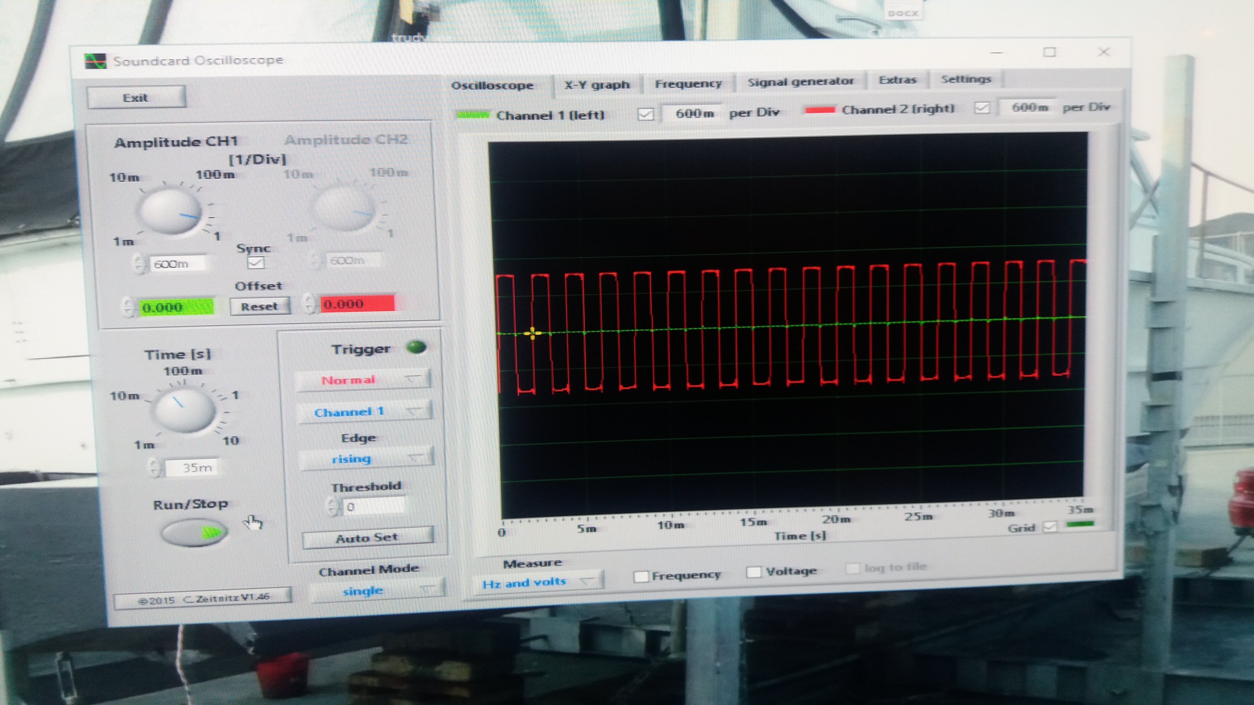

Where's that from?

Im not sure what that is - it doesnt look like an engine signal simulator like a jimstim. It looks more like an oscilloscope but doesnt really include any useful details as to what its intended for.

Just built a circuit to turn the pc soundcard into an oscilloscope to tune in the thing simply 2 voltage regulators and 2 resisters to make 2 channel scope.the generator is powered off the pc cause it needs a -12v rail 12v and 5v

Pretty good effort actually.delcowizzid wrote:https://m.aliexpress.com/s/item/3274350 ... &#autostay
I play with this Electronic {crap} myself and have been following this thread with interest.
Wouldn't a programmatic DDS be better ? ie something with the same Generator but then linked to some logic behind the scenes ?
I have an older Osciliscope.
So are you attempting to generate camshaft/CAS signals with that DDS ? is that the point ?

Maf I spose you could use another one of these for all the rest of the signals can be trim pots.i used to use my sound card with a signal generator to do rpm but it didn't have the grunt to do it well.im looking to see if I can mode the file on the at mega so I can step up the frequency while it's all ready sending the signal currently you have to stop it step up the frequency and press start again
