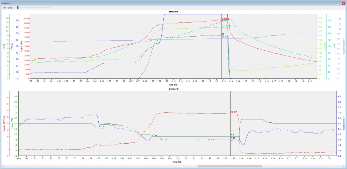

ok I've obviously done something wrong here ?
The injectors are 2200cc ... but I've divided by 2.3 for methanol ?

i updated the sheet for the "Dyno Based on Injector VY Auto Ecotec Comp Cams Stage3 15psi Turbo 81LB Denso injectors v1.1.xlsx" on the previous page, interesting vs yours. What RPM is that dyno graph starting at on yours? From the results it looks like maybe 4500-5000
Posts: 10436
Re: Dyno Graph from Injector Flow Rate & Datalogs
yeah back when I did that the converter was too loose, flared to 5500-6000 as soon as it got on load, so the dyno run was just as best as it could be from there.... and I used the ramp up to that point to get the numbers for 3500 onwards, but they are not WOT till about 5000.

the other thing to keep in mind too, if your tune is rich it will be showing more fuel going in than is technically needed, which would mean its going to look like more HP than its actually making ??

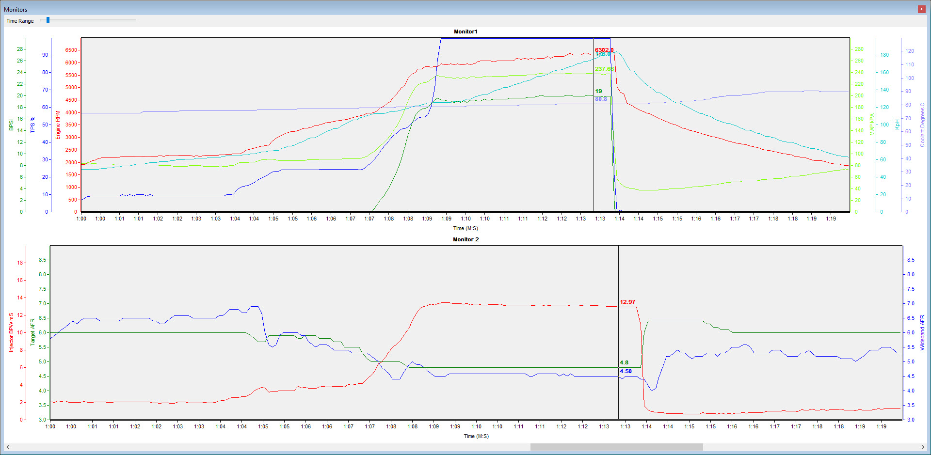

this is the log of the dyno that I used to get my numbers for above ... the road speed gives you a fair idea of where the converter stops until the run actually starts and the actual AFR is a bit on the rich side, but in the case of methanol it doesn't really kill power like it would with petrol.
the interesting thing from this graph compared to when we recently took the gemini to the dyno, it has a totally different converter in it, same gearbox ratios, same diff and tyres, but it was showing approx. 30kms more road speed, we were struggling to understand how this was possible, then I had the thought of my slippery converter, I think its pretty safe to say the above converter is wasting a lot of HP, who knows, left at 6500rpm for long enough it would probably almost catch up, but its pretty bad.
I did get the converter adjusted but I haven't put it on the track or dyno since doing so, but at least we have the dyno logs to prove it now.
