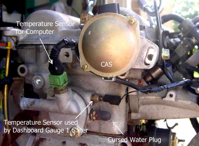

This is image showing the wiring for the Mzada CAS. Its a 4 wire setup like you mention the Delco needs. What specifically does the delco need as such? Does the above diagram offer any cluse as to what the mazda outputs?
I can post over at the Mazda forums to ask for their technical advice.

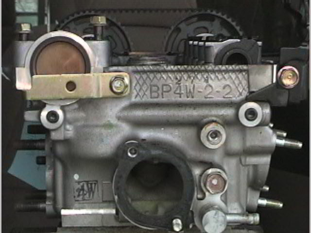

This image shows the back of the head with the CAS in place for reference

The cas is not going to be compatible. The delco modules have a fat +12v for coils, +12v for signals and grounds. Then the 4 wire interface is + and - (high and low) for a 5v square wave for RPM and one called EST and called Bypass. The module provides its own spark trigger below a programmable RPM (450 from factory) to get the engine moving. Then above this rpm the ECM sets the bypass signal and sends the variable spark trigger out the EST line. This signal is the same for 4, 6 and 8 cylinder, commodore or american hall effect, and distributor reluctor. The different ignition modules themselves convert the differing input signals in to this '4 wire' (2+1+1, not counting power) signals. If the mazda is runinng coilpacks there is very little chance you'll be able to use it but if it has a distributor then a signal similar to a sine or square wave might be able to feed that in to the pulsar ignition module. Getting the reference angle can be a pain (and wear out your starter) but you can ground the diagnostic mode pin on the ecm and you'll get a static 10 degrees of timing. If its close enough to start on whatever degrees you get from the ignition module (not programmable), then you can realtime the ecm reference until you can observe it idling at 10 degrees and your set.
the tl;dr of that is unless its a distributor, plan to set up your own trigger. There are a couple of threads where this has been done, and there is a lot of info the first thread I linked above.
