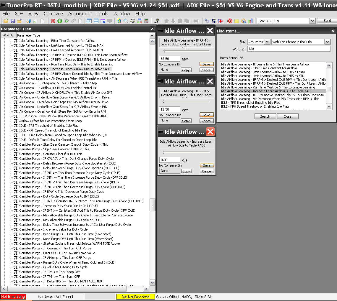

And although I would never dismiss the effort & time that people here have put into making these xdf's, I have found 2 different items pointing to the same hex address, & in studying these 2 pics below, I'm thinking there may be others.
I'm thinking the Getrag.xdf started out as the auto one..
I know what it's like sitting in from of a monitor typing hours of text/script etc etc, you can look at something a hundred times, then come back to the code some months later, & wonder A:how the heck you missed an error, & B: how the heck did it even run..
Looking at these 2 pics below has me wondering if there's a byte offset in the xdf's pointer just in these few items..

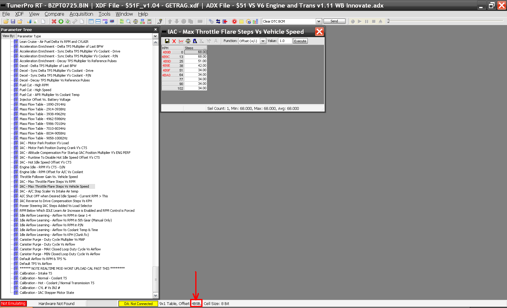

In taking a good look, I can see for sure that the areas I'm meant to be editing to reduce / stop the throttle flare are being pointed to the wrong address via the .xdf.
I'll have to investigate this when I have more time over the coming weekend..
You can see by the pics posted below, the 2 sections of code required to do what I'm attempting to modify, actually overlap each other, I've put the hex address of each of the parameters, on the left of the parameter in red writing, & put a red square on the bottom of each pic, that shows where the .xdf is pointing to..

This might be a case of changing one value in the vehicle speed side to see whether there is any difference in vehicle attitude.
I know that it is definitely overlapping BUT it is very hard to decipher which is the incorrect one. I would suggest the width of the tables will be correcta nd only the offseet/start will be incorrect. short of manually mapping the XDF manually it will take a little bit of time to find the actual incorrect table. If you could find the next logical table then it might give you a heads up as to which is wrong.

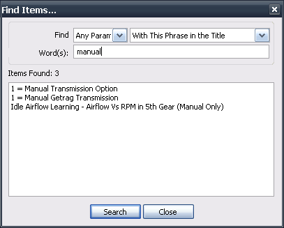

15/1600+ throttle flair got me looking at this again over the weekend, got to wondering if there's something else I could alter in tunerpro to stop the flair, turns out there was, I noticed that there's 2 flags set in this binary for manual, the first is the usual "manual transmission option" flag, then another below it for the getrag, so I took the tick out of the getrag option, reset the computer and went for a drive, turns out the flair is gone 100%, though I get a check light after about a minute of driving if I plant the right foot down, otherwise it's faultless.

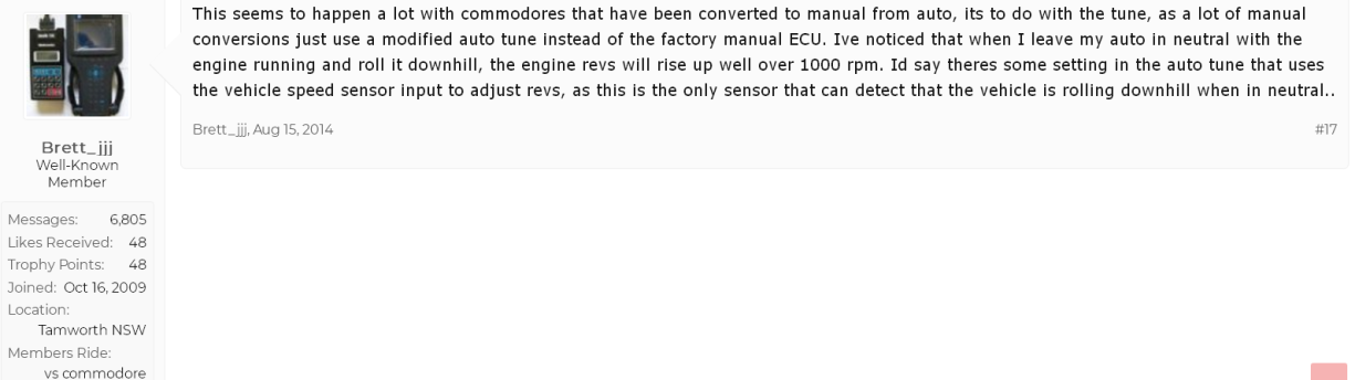

Also seems that other people have found this to be an annoying feature, found a post regarding the issue on some commodore forum, though I don't agree with his opinion of why it does it.
