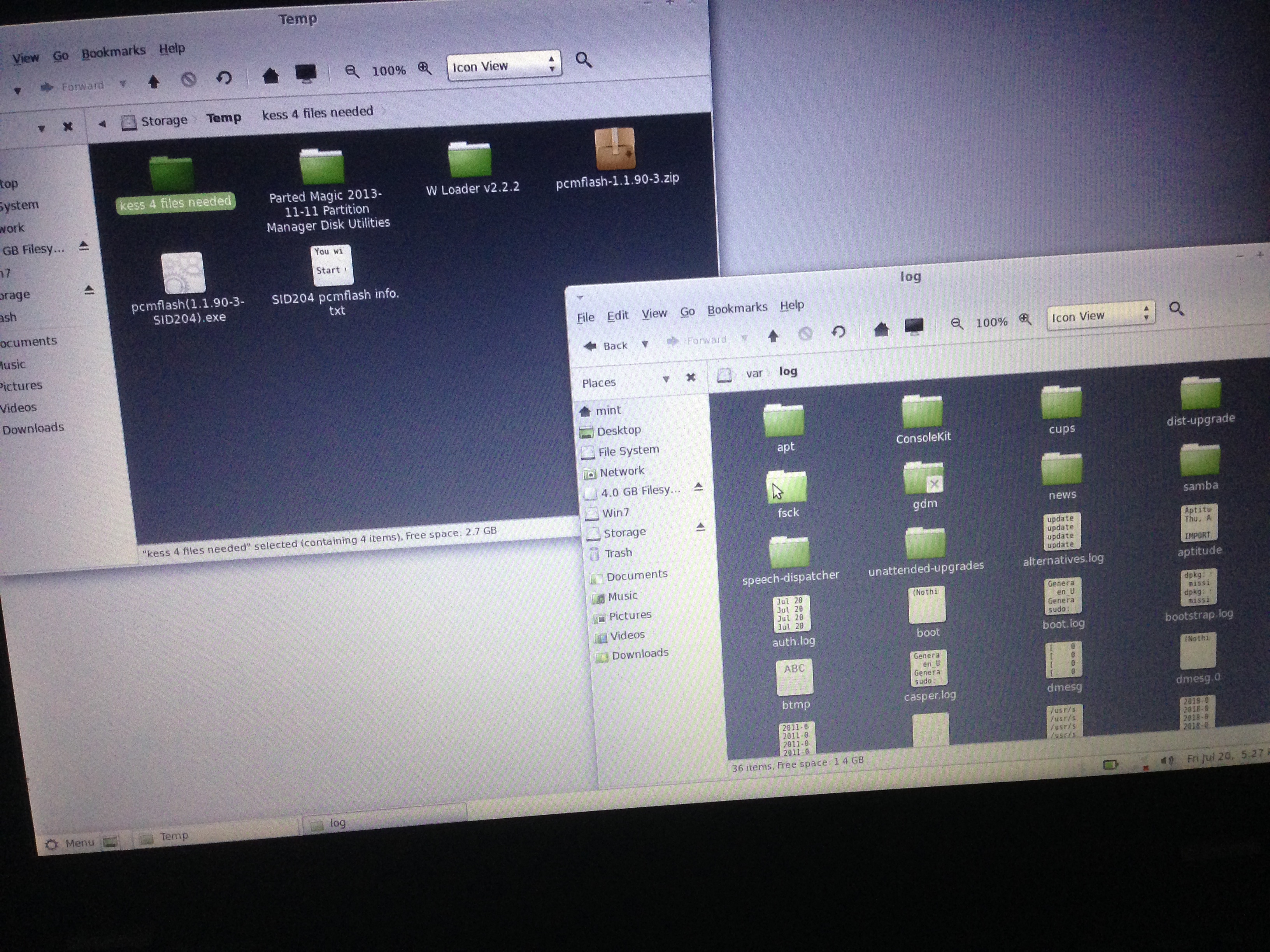

Ok so I tried all the windows programs & just does the same as normal win7 formatting I even tried the cmd(as admin) diskpart full clean but no good.
So I went & grabbed the old Linux mint11 disc(I actually found mint12 kbe too) & to my surprise it actually boots from disc without installing.... sweet!
But I can't find the way to Antus's instructions... attached is the closest I can get to any of it.

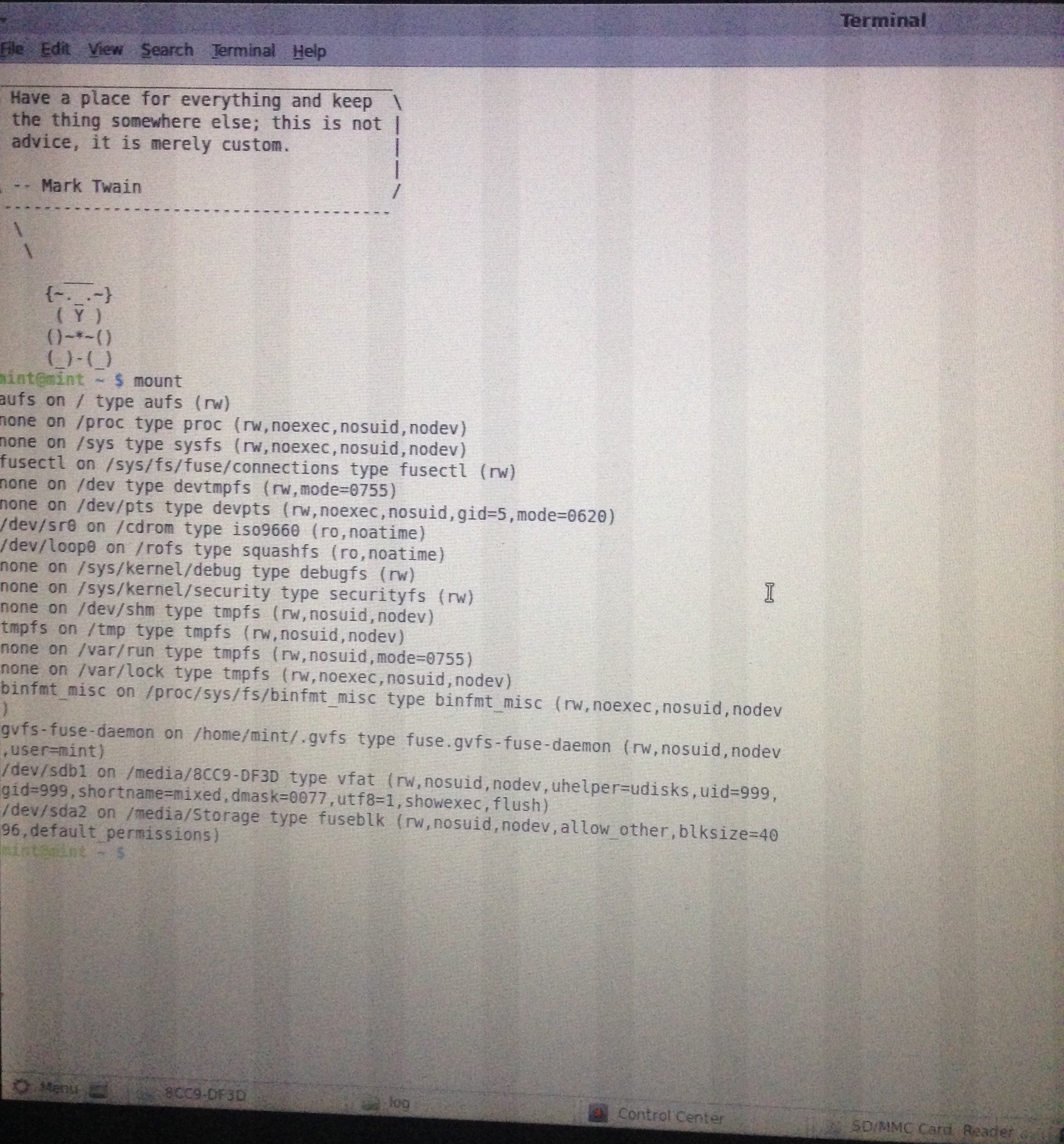

- Posts: 10111
Re: Micro SD card registry(NEW)
Open a terminal and run "mount" and post up the results
- Posts: 2971
Ok here that is but not sure what it means?

This would seem to suggest that the format of the sd card is vfat.

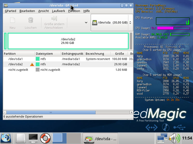

If you wish to know in a GUI look at using the parted magic application in your first post. This will give you a proper idea in gui if that helps you.

yes I agree it might be that the card started out as fat32. I am expecting that the system reformated the partition. Run parted magic and have a good look. it has a similar outlook on systems as disk manager in windows.VX L67 Getrag wrote:It was definitely fat32, but maybe rather than running Linux Mint off the cd I need to install it onto a hdd to get the result I need.
your other option is download gparted which is a partioning linux iso that boots live without install and does awesome work. I have used it for partition changed on SOE prepared remote systems when I was involved with a major grain corporation. Just works.

the other option is... to completely erase everything... (which very few cards ship from the shop like). You can erase the partition table. You can see in your screenshot that is device /dev/sdb1 mounted on /mount/8CC9-DF3D which means files under that location are on the first partition of /dev/sdb. You can become root (administrator) with:
sudo -i
Then unmount the card (eject, windows term) it with:
umount /dev/sdb1
At this point any open file windows you have for that drive should disappear.
Then run this to erase the card:
dd if=/dev/zero of=/dev/sdb bs=2M count=1
This is very destructive. It'll write zeros to the first 2Mb of device /dev/sdb
If you have the wrong device it'll trash the wrong disk. For example if its your computers hard disk... uhoh. Be damn sure you have the right device.
You can see the SD card serial number when you type mount. We can see its "8CC9-DF3D" because its 4 digits of hex, hyphen, 4 more digits of hex which is normal for sdcards. It'll always mount on /mount/8CC9-DF3D. We can see from mount that its device is sdb1 where SD means scsi disk (pretty much everything talks scsi protocol theses days), and b means the second logical disk in the system, and 1 means partition one. Were targeting the disk, not the partition so we target /dev/sdb
The outcome will be a disk with no partitions and no usable space because its got no partitions. If the tool cant use it like that (and you cant either) use windows or gparted to create a partition and format it at which point it'll show up like a normal drive again.
