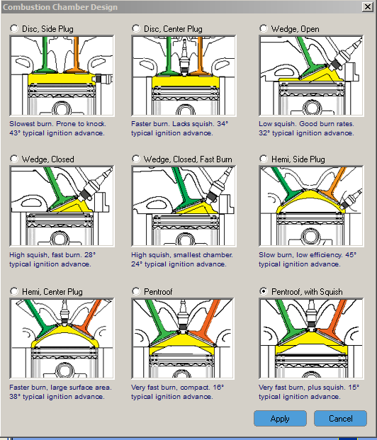

delcowizzid wrote:Vt heads take a lot less timing too
please don't take this as offense as I'm just asking the question but how do "heads" decide what timing it can take?
I know you're work & appreciate it, so I'm just asking not having a go so PLEASE don't take offense!
Posts: 8125
Re: Interesting VR V8 ECUs
combustion chamber shape and size.
Posts: 5639
The vt heads have a much more efficient chamber design with a faster burn rate much like the ecotec heads compared to buick.both designed for a faster more complete burn for emissions reasons .gm did a lot of fast burn heads on the state's too on there v8 stuff they have a way different timing requirement to the normal heads.they employ a lot of swirl and Tumble and quench pad shapes .also tricks like the angle of the chamber walls that act as an extension of the top valve seat angle to help the air stick and keep flowing to the edges of the cylinders
Posts: 8125
This is also reflected in the chamber models in Dynosim.
