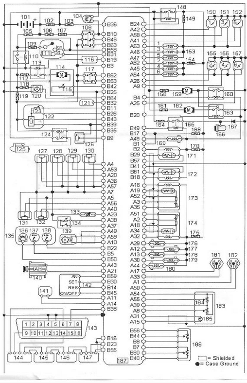

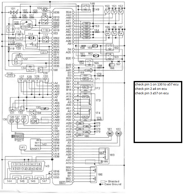

I'm going to check wires see picture
What else could be the cause :? the only wiring that is original is the loom from ECU into cabin if that helps :hmm:

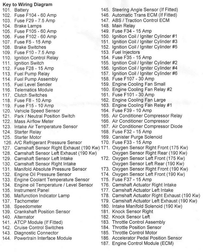

I've been reading around a bit more, is this possible? :idea: looking at wiring diagram sensor 132 (oil pressure sensor ) runs on the A7 connection, same as cam sensors.
the reason I ask is some one had a similar problem here https://forums.justcommodores.com.au/th ... ump.87114/
can (oil pressure sensor ) cut the fuel or mess with the sensors. I noticed on the old motor it was a little different. one the sensor plugs right in near oil filter, other one has brass bit between near oil filter and plug.
the car never actually starts with the cam sensors in, I have to unplug them to get it to start. then plug them in.
