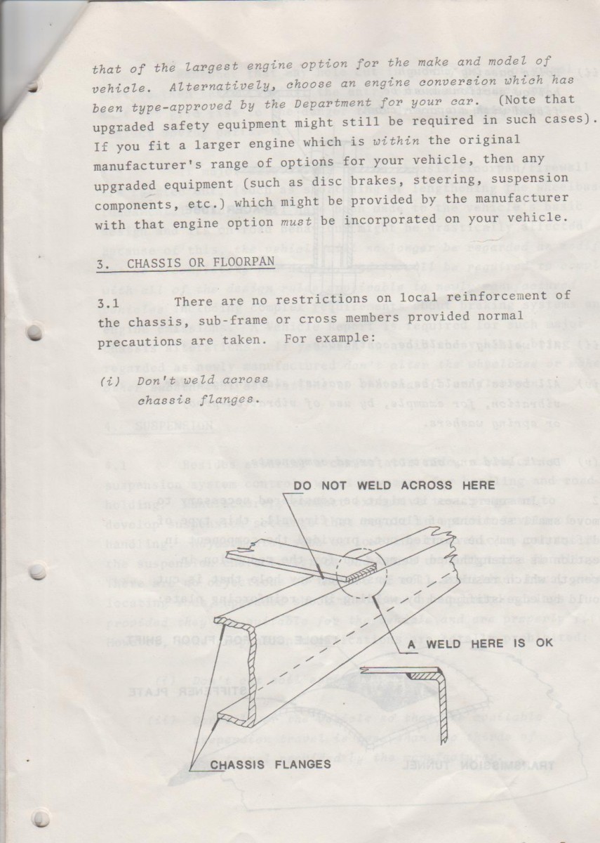

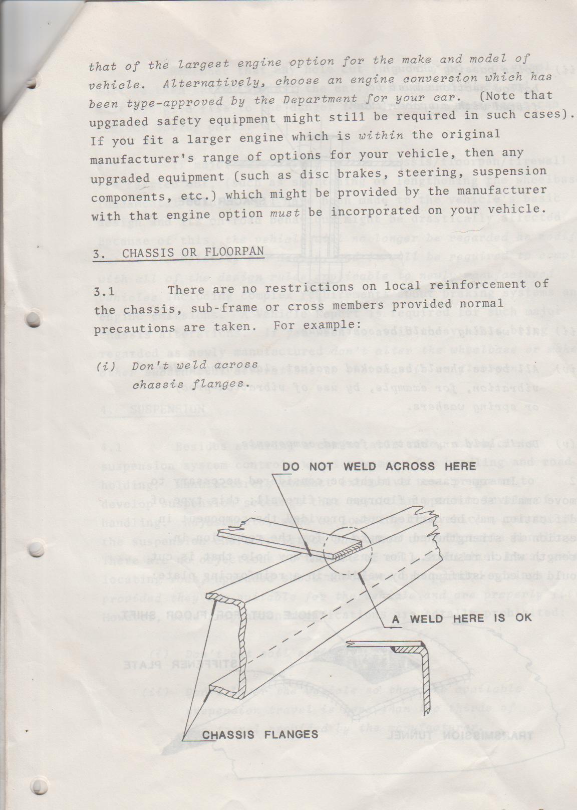

Good looking trailer indeed, good for another 25 at least.

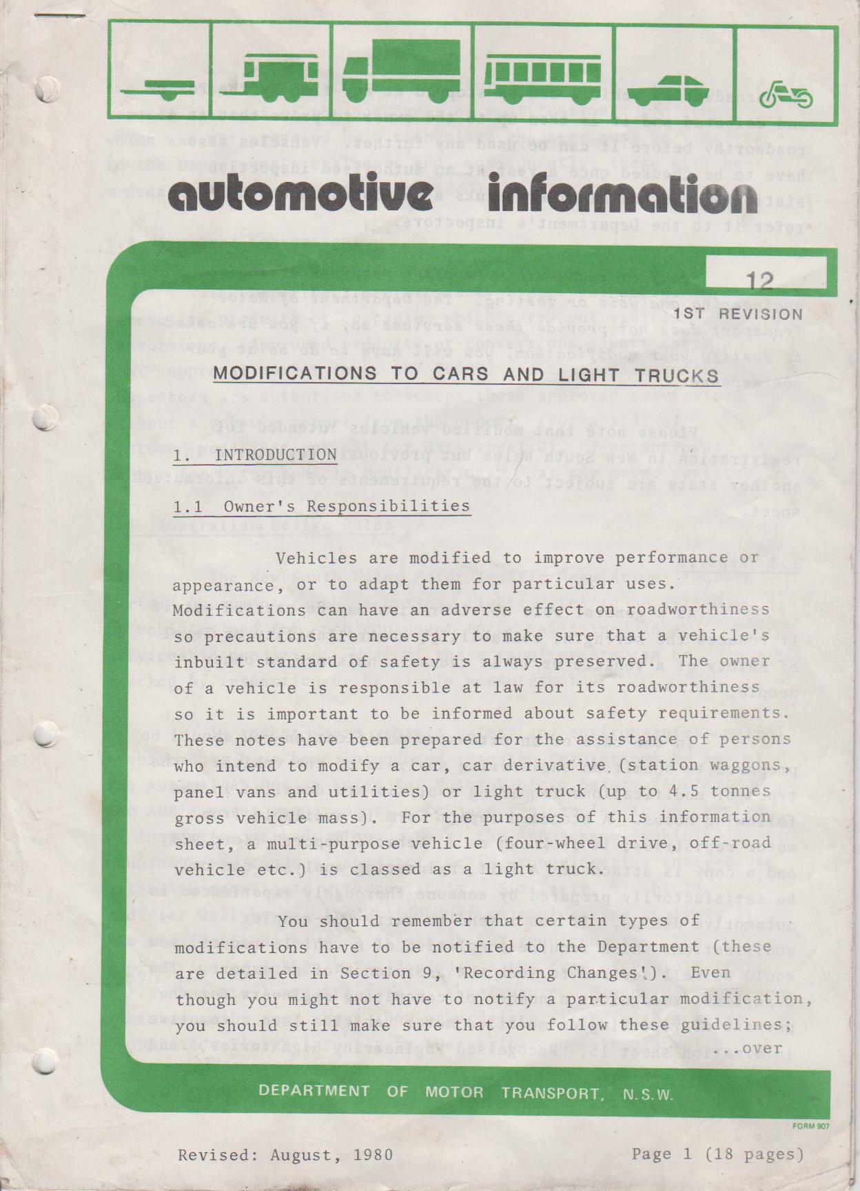

I stuck an SBC in a HR early 80's, had to get it engineer approved, which led to understanding of the do's & don'ts regarding welding of anything chassis related, welding across ways was one of the no-no's, welding had to be front to back only, actually found some of the relevant paperwork in the last cleanup here.psyolent wrote:man that come out awesome.
wow thats interesting, i guess my 6x4 i've had for the last 20 years is doomed huh? is there any FEA or engineering articles to support this dude?However, sorry to be the bearer of bad news but you have welded your draw bar the wrong way. By welding across the drawer bar you actually create a stress concentrator and it will generally crack right along the weld. This is a very common mistake and can lead to a serious failure.

Re: Box Trailer Rebuild
bewdiful. thanks ken.

I Have seen way too many accidents that are caused by welding the drawbar across the front. This does not mean every one will but it give a higher stress concentration. To err on the side of caution it is best practise to not weld there. Yes there is many documents on this and I could dig up the actual trailer standards which I have seen it is previously.psyolent wrote:wow thats interesting, i guess my 6x4 i've had for the last 20 years is doomed huh? is there any FEA or engineering articles to support this dude?
Here is a prime example. There are alot of people who state that HQ pattern is the same as commodore. It actually is not. The commodore is the closest metric equivalent but is not exactly the same. What this means is that HQ rims on a Commodore rotor stresses the stud in the worse way (shear). Unfortunately stud have stress concentrators in them due to the threads so any force in shear can result in the stud breaking through the threads. Does every stud break when hq is used, no. Has it happened where the studs do break, certainly, and have I experienced this.... YES.
All I am saying is being the mechanical eng and electrical eng I am there are some things i have just learnt to do a certain way to remove the risk. After all how would you feel if your draw bar fractured off and it ran into a human???
