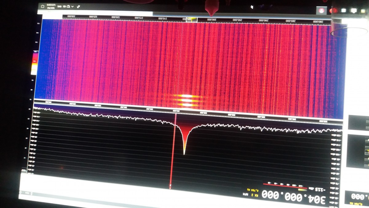

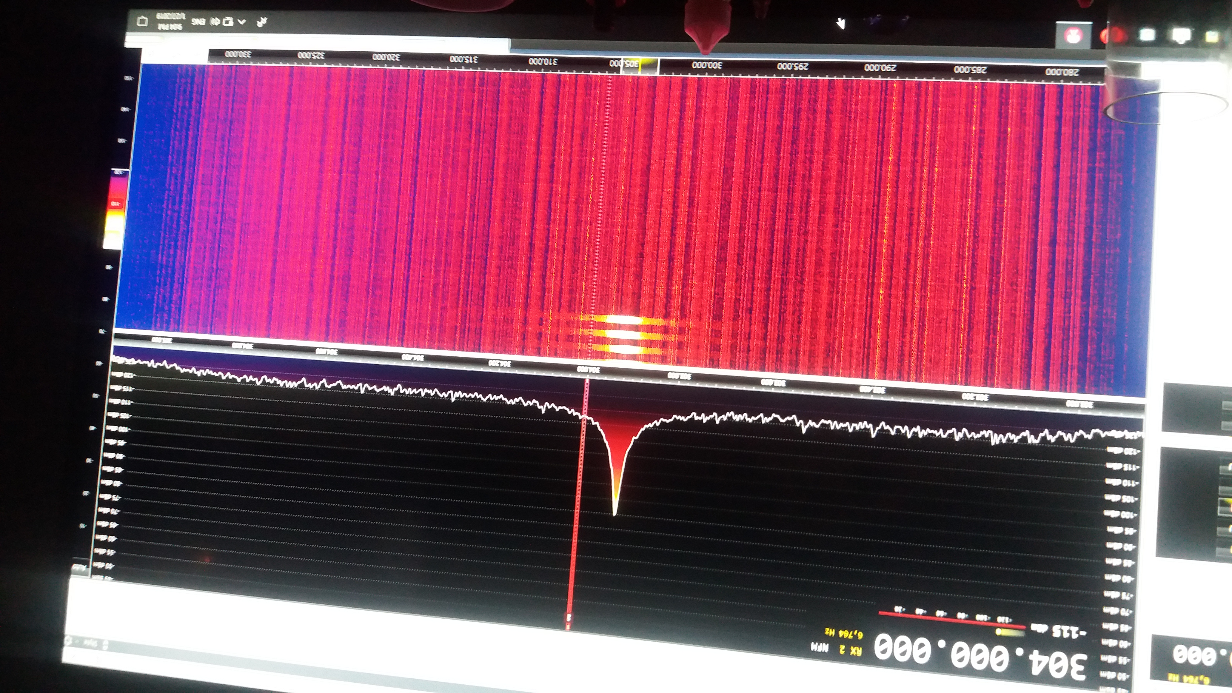

I can see it transmit on my sdr at 304mhz wonder if I can decode the data hmm
