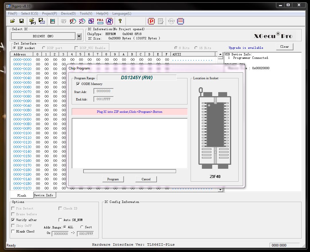

ok so after a couple of weeks of refusing to look at this again and wanting to take to it with sledgehammer ive come back to it finally but this time i thought i would upload a few pics of using the programmer to make sure im using it right so he we go
first off ensure correct chip is selected at top left DS1245y RW not test and a no bin info loaded

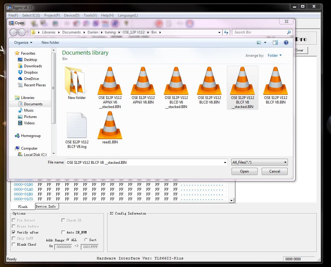

next find correct bin to load in this case OSE$12p V112 blcf V8 Stacked

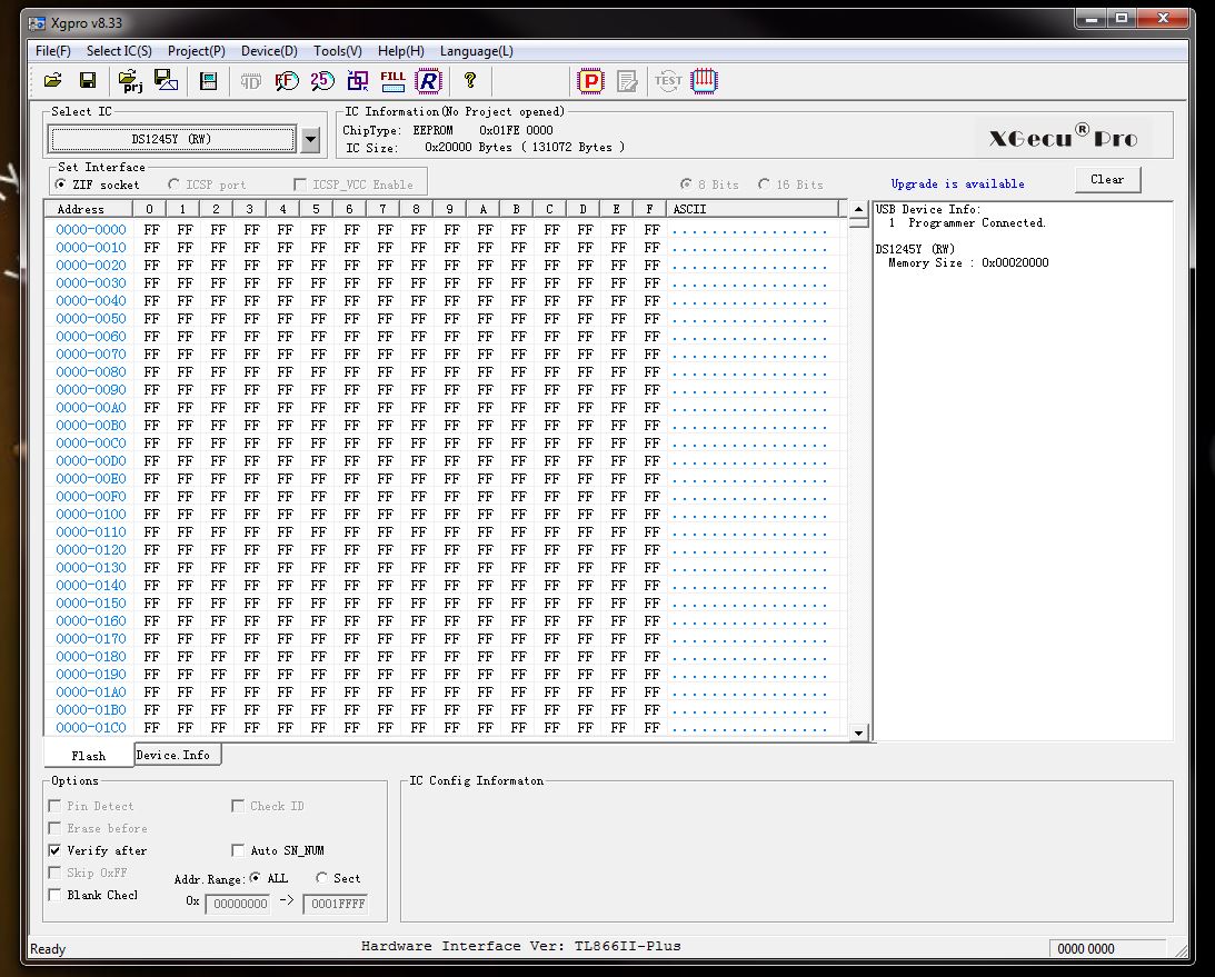

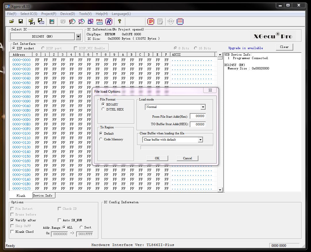

ensure there is hex data loaded start of the page shows FF but if i scroll down there seems to be 2 sections of data. hit program icon at top middle (P) then hit ok im sure i dont have to change any addressing here
programming 3.JPG (213.83 KiB) Viewed 6684 times
next check that its fitted in zif socket with correct orientation which it is as per pic at lock end with dot to lock hit program
programming 4.JPG (177.14 KiB) Viewed 6684 times

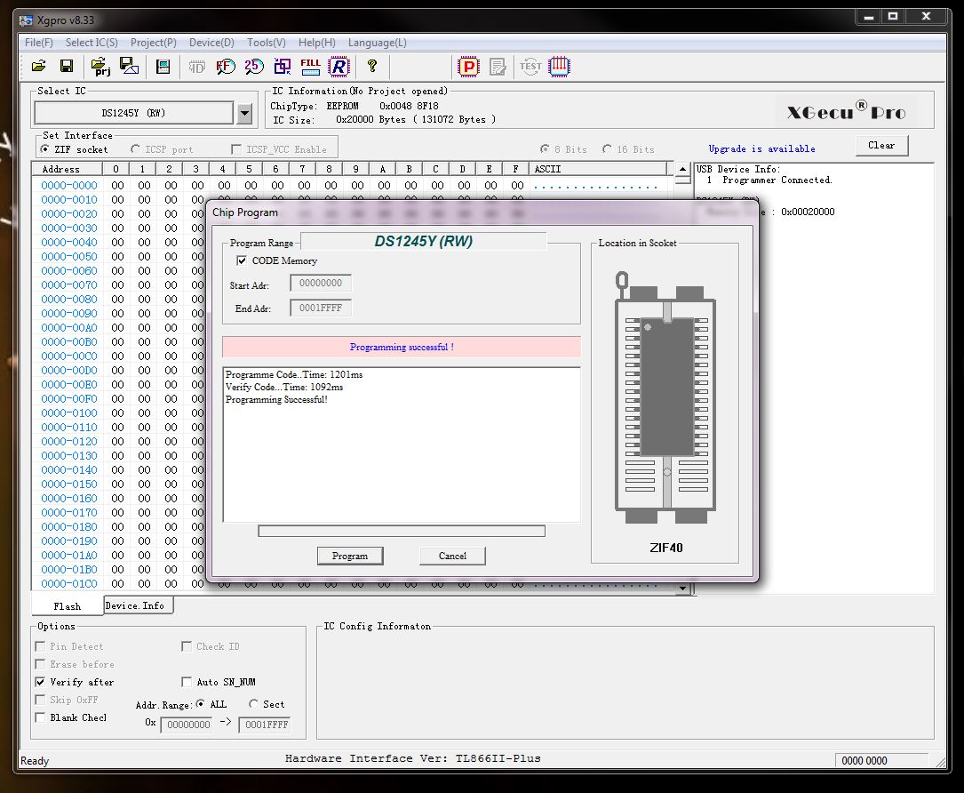

programmed and verified all ok
programming 5.JPG (177.28 KiB) Viewed 6684 times
please tell me im over looking something easy and small if not im just going to have to buy 2 more nvram units just seems a shame both are dead
thanks
Darren
