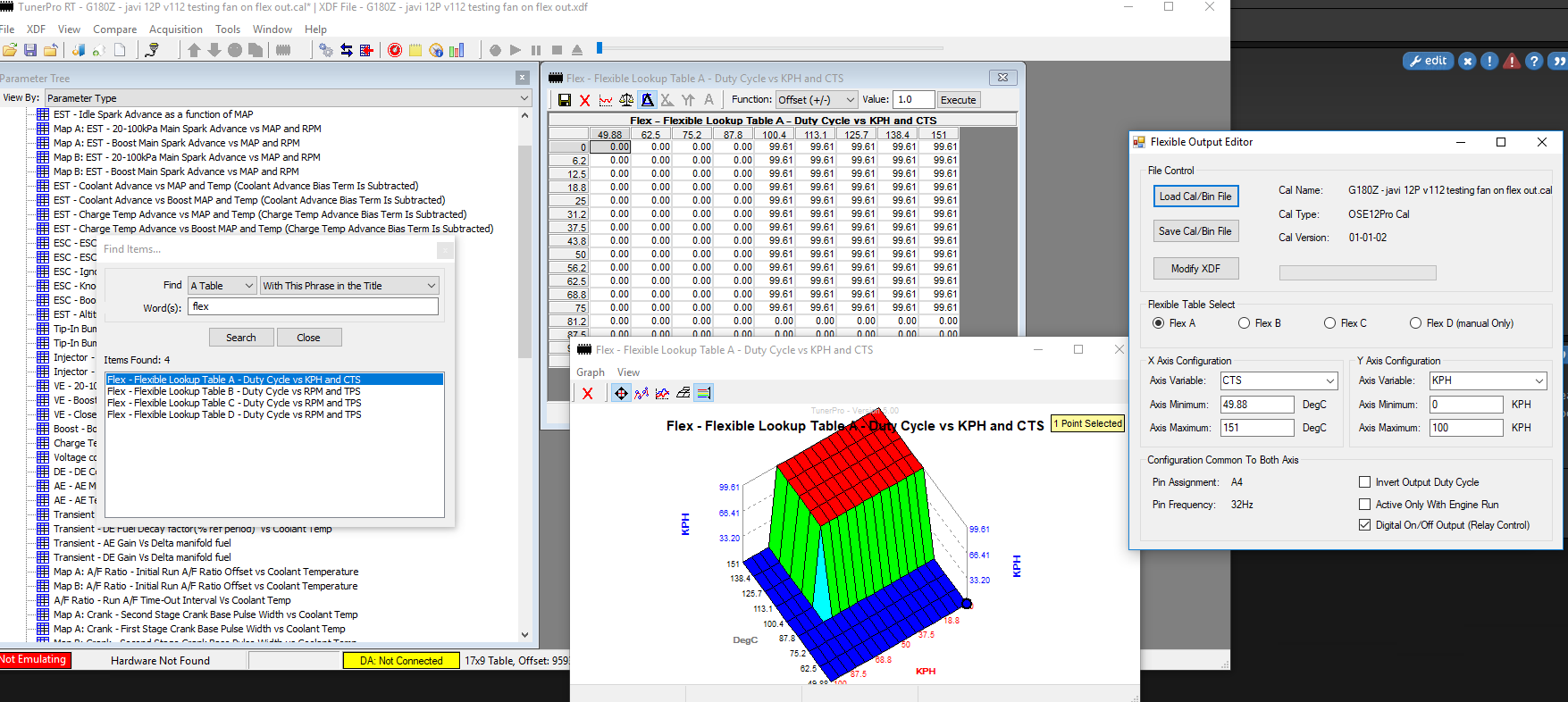

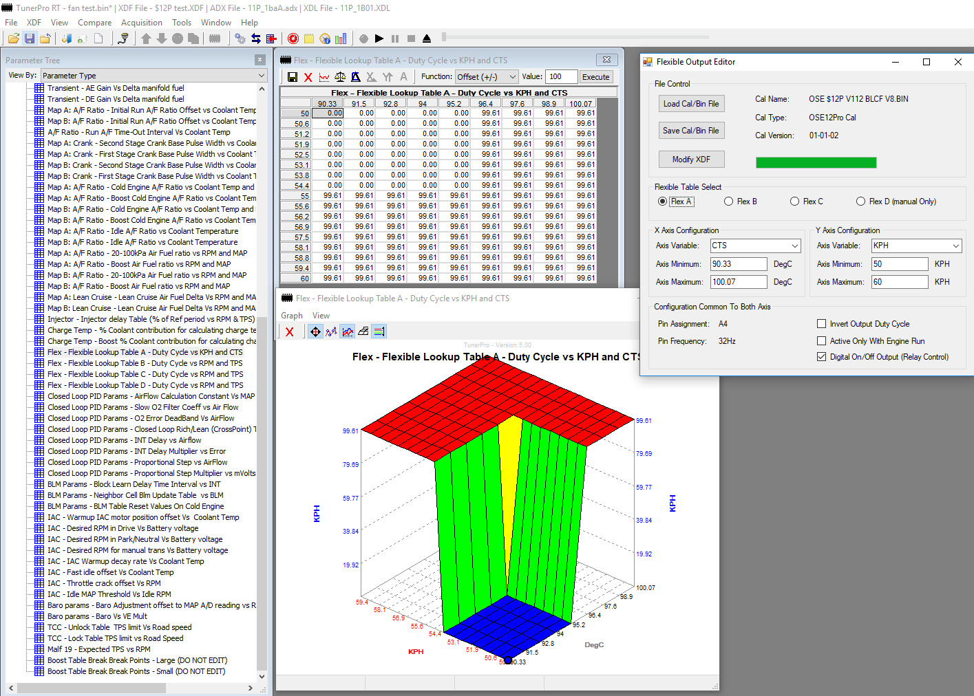

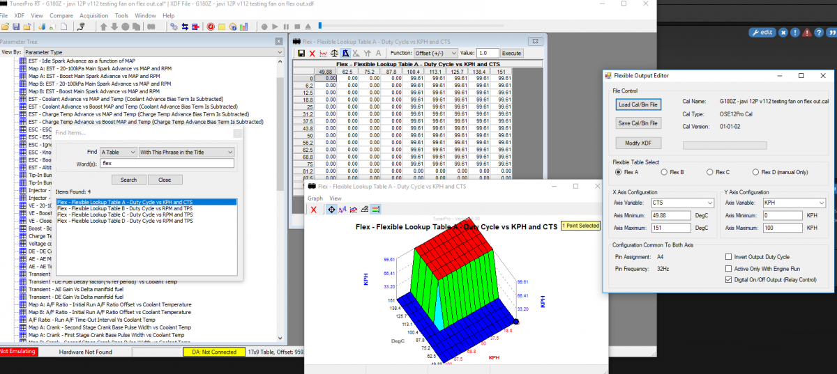

Just some more info on setting the flex table up.... you can see in Antus example the min and max of the CTX is set to 50 and 151, and this is fine, however it means you get less resolution in the cells of the table.Antus wrote:
if for example you set it to min = 90 & max = 100, this will give you almost 1 degree per cell.
you have to remember, outside of the table values it uses the last value, so you dont need to have the full range of numbers in the table, only enough to define your on/off points.
also to note, and i guess its personal preference, the option there to have it only work if the engine is running.

Now that my options on the two-speed fans have been explored, I have a few more questions:
Looks like the best way to go is to convert my current 5A bin (which seems to run somewhat against 12 xdf in Tunerpro) to 12P. Is this just a case of manually looking at each parameter/table in my current bin and copying it over to an existing 12P bin? What is the easiest way to do this? Run two instances of Tunerpro, one against the $12 xdf and another against $12P?
How do I open that "Flexible Output Editor"? I did play with the OSE Flashtool, but how do I get that to run in Tunerpro like Holden202T and Antus did? Edit: [I got this sorted, don't worry]

- Posts: 10016
Re: Two-speed fans on 16206305.
Yep, open 2 or more copies of tunerpro and copy what you need across (use the tools/custom tools/new tunerpro instance menu item to do this). Note that a $12 xdf on a 5A bin wont properly line up across everything, so you'll need to sanity check the data and dont copy across data that isnt mapped correctly and doesnt make sense. Better to use a $5A xdf, if there is one with what you want mapped.
