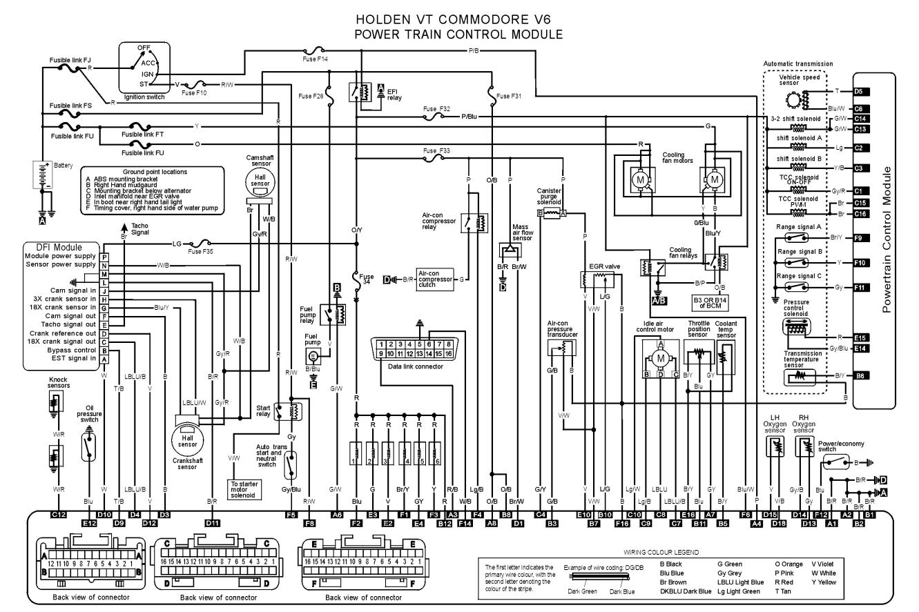

Ok have checked CAS connector looks ok.
Buzzed CAS to DFI plug 3X, 18X and ground and all connected.
X18 from dfi module is not connected to B7 on ECU but to D4 on ecu. So I found this wiring diagram which matches download/file.php?id=12834&mode=view
I still have not eliminated the DFI module as I could have 2 faulty ones. Is it worth just getting a new one or should I check more pins?

Oops, looks like I might have posted the VX V6 wiring diagram.
At this stage, been able to see what the PCM is doing is going to help. Need to see if it is getting the correct signals from the DFI when cranking.

Ok just checked Sensor power supply pin N on DFI and only have 2.7v. Is this normal?
series8rx7
Posts: 20
Joined: Sun Jun 30, 2019 1:33 am
cars: FC RX7
Bravo with VT V6
Hyabusa
Pajero
Re: Vt V6 no injector pulse has spark
Post by series8rx7 »
Well disconnected CAS and low and behold sensor power is back to 12v. So I have a faulty CAS. Anyone seen a CAS only do 1000kms or so?
Or could a faulty DFI unit cause the CAS to go bad?
