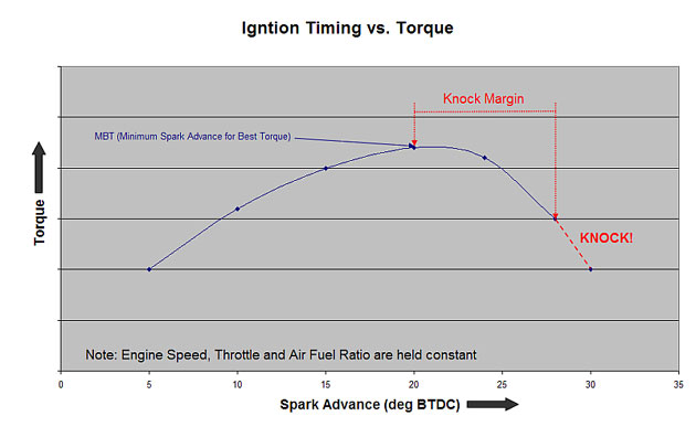

many of the areas in the spark map. 1. you don't have infinite and variable hills. 2. torque output in many areas can't be felt relative to the amount of timing changes input. eg the top plateau of the torque vs spark response curve. One one side of it is safe MBT and the other side is danger territory. Without a dyno its very hard to tell where you are.
This curve depends on the engine itself, some are more peaky and easier to dial in other like my engine were broad and had a large plateau making it impossible to find MBT without a dyno.

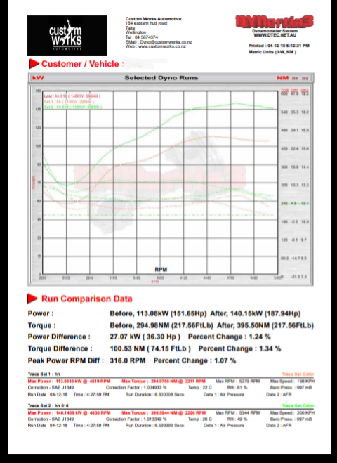

This was the difference on na v6 that 100nm made a huge difference

vlad01 wrote:many of the areas in the spark map. 1. you don't have infinite and variable hills. 2. torque output in many areas can't be felt relative to the amount of timing changes input. eg the top plateau of the torque vs spark response curve. One one side of it is safe MBT and the other side is danger territory. Without a dyno its very hard to tell where you are.
'1. you don't have infinite and variable hills."...…. How do you determine what cell the mapping is going to fall in when you try to duplicate infinite and variable hills on the dyno as compared to the loading on the road.
"2. torque output in many areas can't be felt relative to the amount of timing changes input." …….. This certainly can be logged on the road.
When using 98 octane fuel in the majority of vehicles they are "knock limited" in this case determining the MBT will be just before the knock threshold as determined by the factory knock sensor.

1. you define roller speed on the dyno for the rpm column, and load with your right foot to sweep down the other column to your desired cell. If you cant get it to sit right in one cell, you can land it in a block of 9 cells square, and realtime the lot of them up or down, then know the center point is correct, and smooth the changes out as you tune other areas.
2. I think agree seat of pants tuning can get you in the ballpark, but a hook test can get you right on MBT and you know when to stop before the knock occurs and the engine goes pop. Im sure different people people have different variations and a lot use knock ears rather than the numbers on a hook test so I guess you have options.
