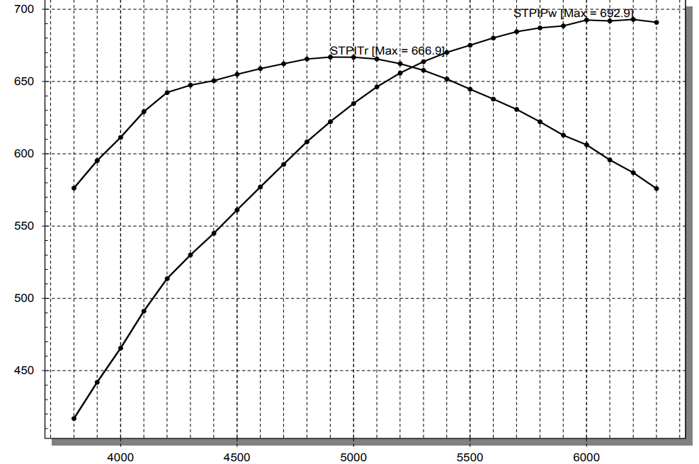

Sounds neat NSFW, just for my own curiousity, further cam specs with a screen shot of the dyno sheet would be really cool :)
NSFW
Posts: 804
Re: C5Z Track Toy
Post by NSFW »
The cam is 239/251 @ 114, +4. "HUC" lobes, originally created for marine performance engines.
This is the milder, broader-powerband of two options that Golen offers for 454s.
The torque peak ended up somewhat higher than I had hoped, but I'm not going to complain just yet. :)

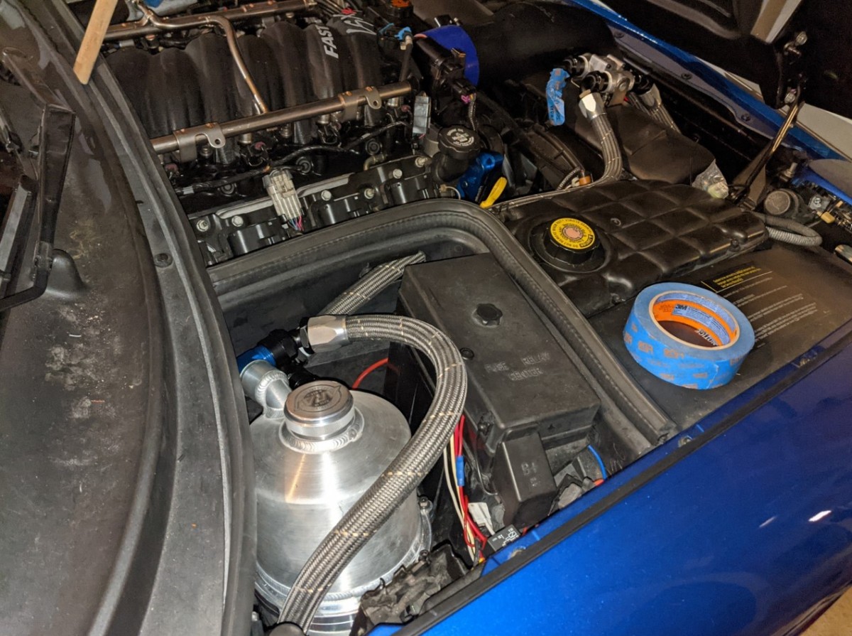

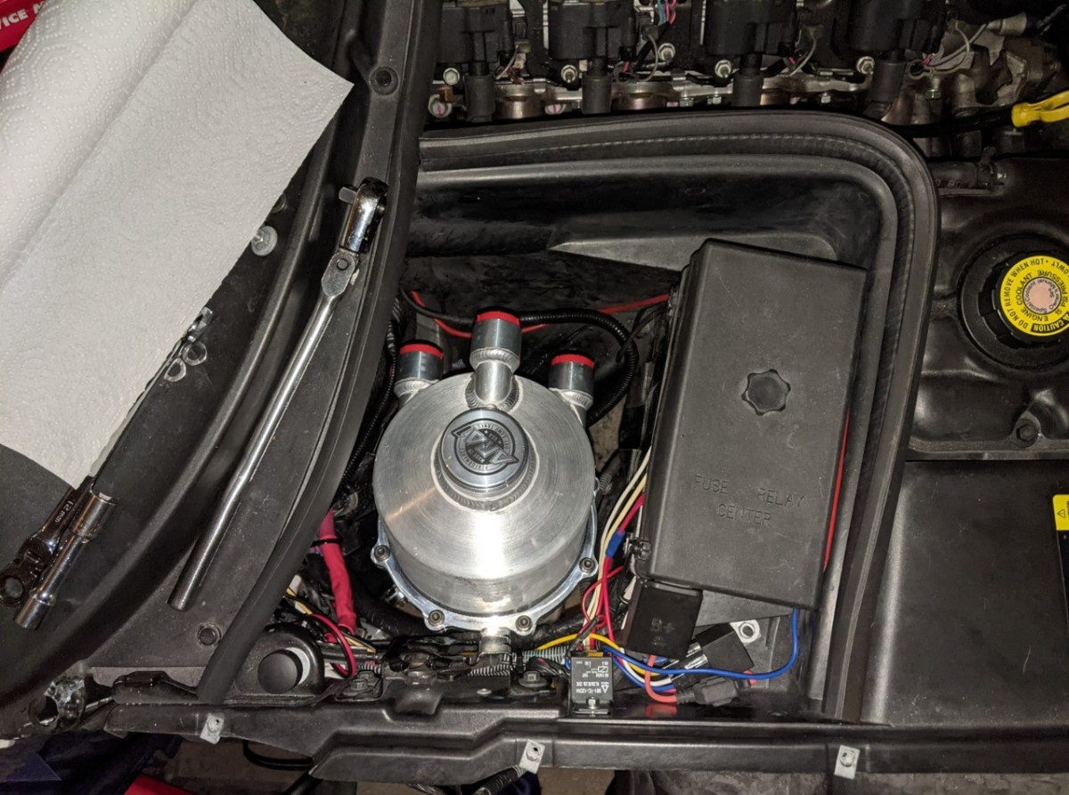

For no particular reason... here's everything I think I know about the returnless fuel systems in later C5s.
I gather that the main problem with the returnless fuel system is the regulator, or specifically the regulator's ability to bypass. In other words, as your fuel pump gets beyond a certain size, the regulator can't bypass enough fuel, and your fuel pressure starts increasing.
600whp is apparently right around the point where you need a fuel pump that moves more fuel than the regulator can bypass. Some people do OK, some people report problems.
I want to minimize surprises during the engine swap, so I'm starting to convert to a return system. OEM fuel rail, regulator in the engine bay, bought an aftermarket filter to replace the stock regulator/filter. Keeping the stock supply line, adding a return line that will connect where the stock regulator's bypass line connected. Racetronix wiring.
I haev a hunch that one could keep the stock regulator if you convert to a PWM fuel pump controller. Pantera EFI makes one for $200ish, and I almost bought one... I'm guessing it would solve the regulator bypass problem if the pump is only running at (for example) 25% at low throttle, and ramps up to 100% as MAP and RPM increase. But I don't want to be debugging the fuel system at the same time as doing the engine swap.
The other suprise while I geeked out on C5 fuel system is that the Aeromotive 340 pump has a terrible reputation in the GM world. Meanwhile everybody loves them in the Subaru world, including me - I've had one for about 40k miles with no issues. My only guess is that the pump is happy at 43psi (Subaru) but not at 60psi (GM). It was tempting to get one of those pump and run it at 43psi, since my injectors are oversized anyway. But, as much as I want to try to test that theory... I also don't want to bet my new motor on it. :)
So I am going to be using a Walbo / Ti 450 pump.
