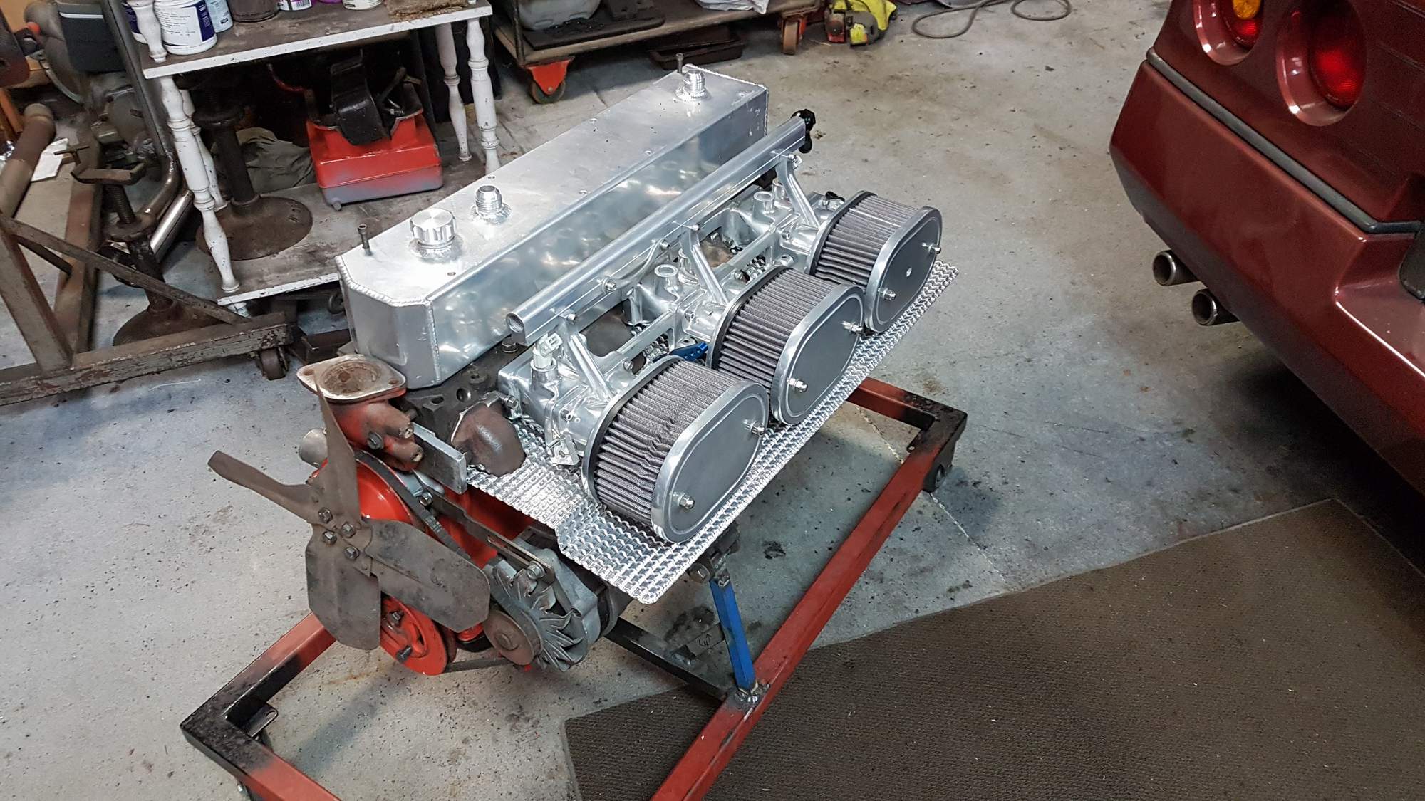

i notice your filler cap is on the other side, why is that ? to suit a certain type of tank ?

Very observant. It has a VC Commodore tank in it.

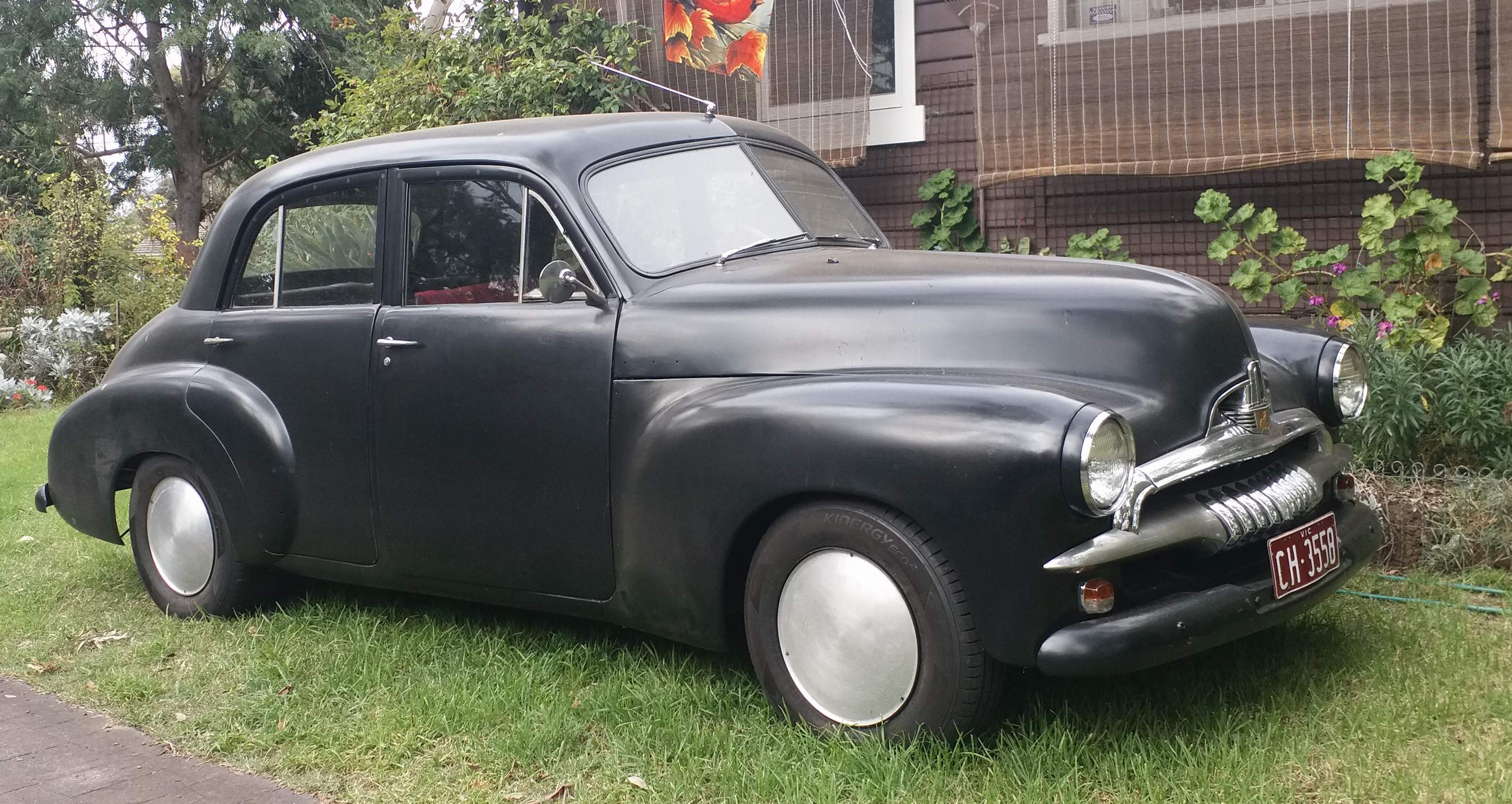

Hi all, here's a bit of an update. The FJ is engineered and registered. Only has a stock 173 with a 2 barrel Holly and X2 headers in it at the moment but shouldn't be long and the EFI 202 will be in it.

That heat shield is a great idea and really neat.
As for the IAC. Pretty sure you can just disconnect it and disable the error codes in the tune. Though if it was me I would plumb in IAC to all the ITBs and use it. having idle control is a handy feature. But if it works without it then don't bother adding it.

Yer, the old girl was really put together to be the test mule for the 202 EFI mill.Gareth wrote:Love the FJ, what a stunner![]()

Thanks for the compliment on the heat shield.vlad01 wrote:That heat shield is a great idea and really neat.
I have never had any experience with the IAC. I assume its just like a small butterfly valve controlled by a stepped motor. Would you build it into a small plenum with 6 outlets and plum them into the bodies behind the butterflys.
EFI Hardware sell a MAP sensor kit which is also a plenum with 6 inputs plumbed into each of the bodies and one output to the map sensor.
What if I built a plenum, fitted the IAC into it, 6 equal lengths hoses to the bodies and 1 outlet to a MAP sensor.
It should serve both requirements as the IAC should be closed under any throttle position except closed and the MAP sensor shouldn't be really doing anything at idle. Just thinking of of the box a bit. Your thoughts would be interesting.
