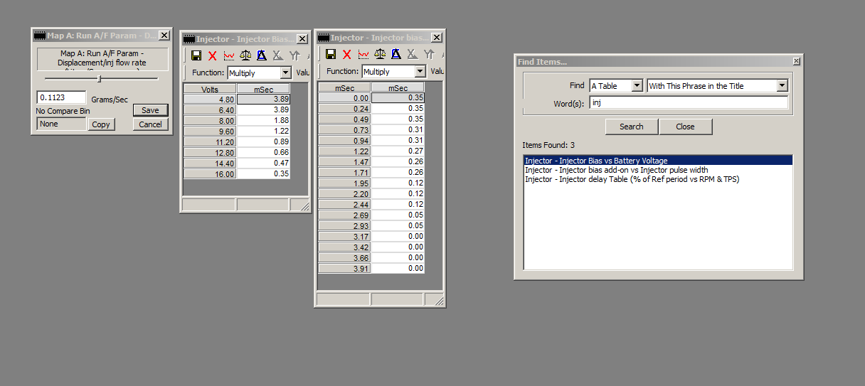

The flow rate is calculated different in 11p and 12p.
I would set the flow rate at 0.100 for that sized injector and start tuning the VE, if the max VE is over 100% then increase the number, if the max VE is under 80% then reduce the number until tuning the VE gets you in that usable range. I could be wrong on the direction, if so then change the number the other way to what I said.
Just search "flow" under scalars
Not sure what the terms are called in the MAF based tuned but in 11P you want to copy over the following if you can, otherwise maybe ask if The1 has the data for the super 6 injectors, if not he can generate the data if you send them to you.
The ones you want is. "Injector bias vs battery voltage" and "injector bias add on vs injector pulse width"
I just searched "inj" under tables

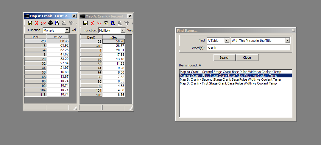

The other thing to consider is the cranking pulse with tables, 1st and 2nd stage tables. There you want to reduce the table by the difference in size of injector. So 36 lb / 19 lb = 1.895
So you want to divide the whole table by that value and for both tables. This with make sure the same amount of fuel is injected at each temp and for either stage 1 or 2 of the cranking as stock would be but with the bigger injectors. If you left this stock it would likely flood the engine from too much fuel when cranking.
It's these tables.

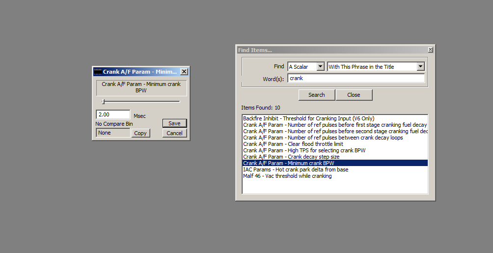

There is a minimum cranking pulse setting which really stuffed me up as I didn't know it existed. It basically overrides the tables and sets a min for cranking that is allowed. Too high and too will flood the engine. I set mine at 2ms.
I think that should be all that needs to be changed to suit the new injectors.

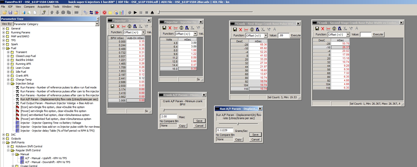

I have copied above vlads info into a 11p base tune.
Want to fit super 6 injectors to my stock vr v6 engine now and start it on the 1 bar map sensor. Make sure i have a half decent ready tune to get car started once i do the l67 swap.
Does all look good below. I have also unticked a and b boxes so the tune knows its on 1 bar map sensor also.
Hoping to get a starting running tune ready now so when i do swap i just fit 2 bar map sensor and super 6 injectors back onto my super 6 engine and it fires 1st shot.
Drive it a bit with wideband and adjust the a/f ratio and go from there.
I have been collecting most of the bits to do the swap soon.

You could just leave the battery compensation tables and it will run OK you have to be careful copying the Injector data out of later ecus there were things happening in the background that added extra delay in the maf ecus that makes the Injector data wrong for the early ecus
- Posts: 8549
Re: VR with l67 help needed
My data you copied is to suit Ford F series truck injectors. They are going to be different to L67 injectors.
