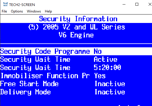

Now doing a reset.. its asking for an immo (Even though it doesnt have one programmed) and we get:
7E0 07 AE 7D 08 30 30 30 30 - requests reset command with immo 0000
7E8 03 7F AE A2 00 00 00 00 - ECU response with Nope, not right (Pretty sure thats A2 response)
7E0 07 AE 7D 08 30 00 00 00 - scantool then tried value of just 0
7E8 03 7F AE A4 00 00 00 00 - Gives an A4 response, pretty sure this is a second attempt fail.

Re: Why I hate VZ V6 ECUs...
Now after trying to reset.. and it saying nope.. we now have this situation. The security wait time is now active, wait time increased but security code not programmed
*Edit, ignition off then back on... security wait time now inactive.
