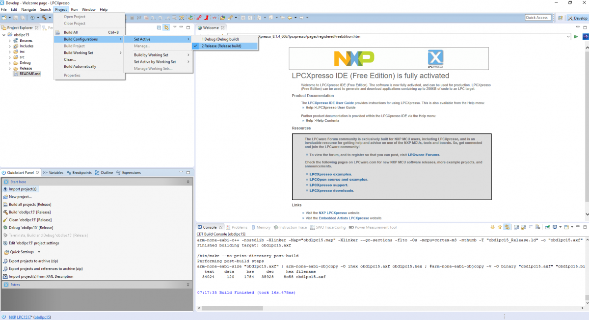

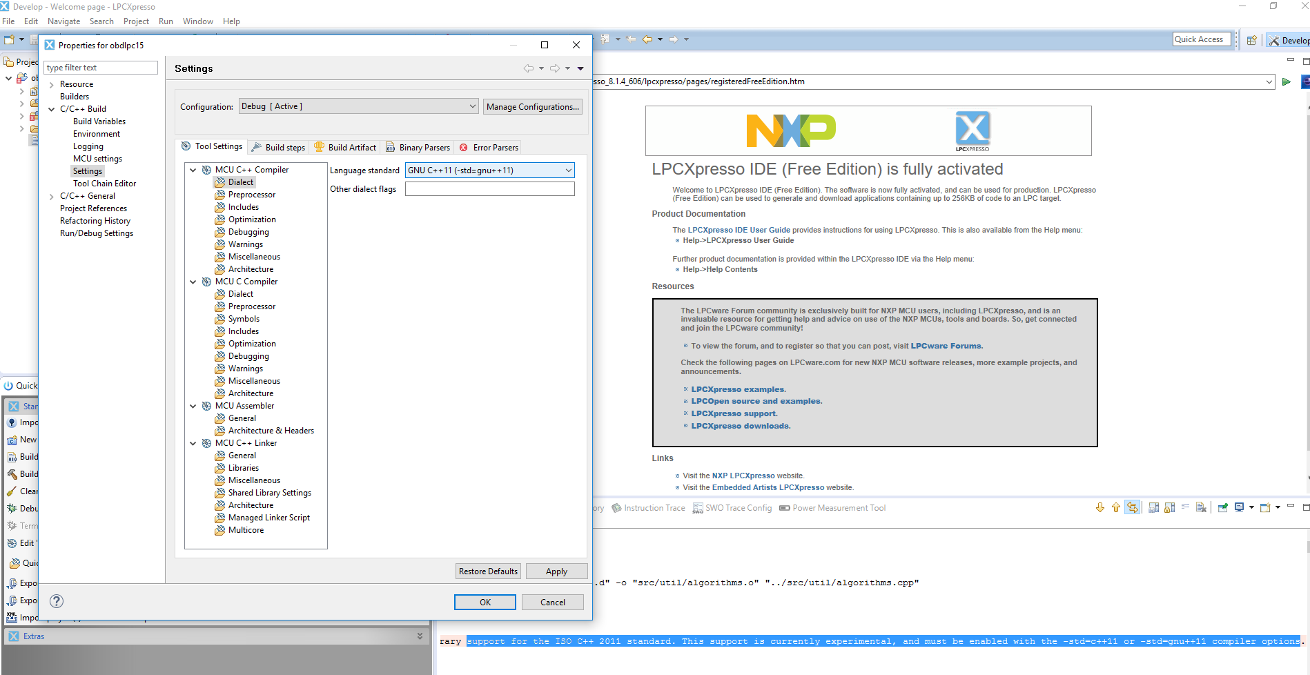

Hello, I have an original USB AllPro , and I too am looking to sniff the bus on a ~2000 Camaro system. Is there a specific set of commands to get it to do so ? It does not seem to support the ATMA (monitor) command that ELM327 devices do.
Posts: 9008
Re: J1850 VPW Sniffer

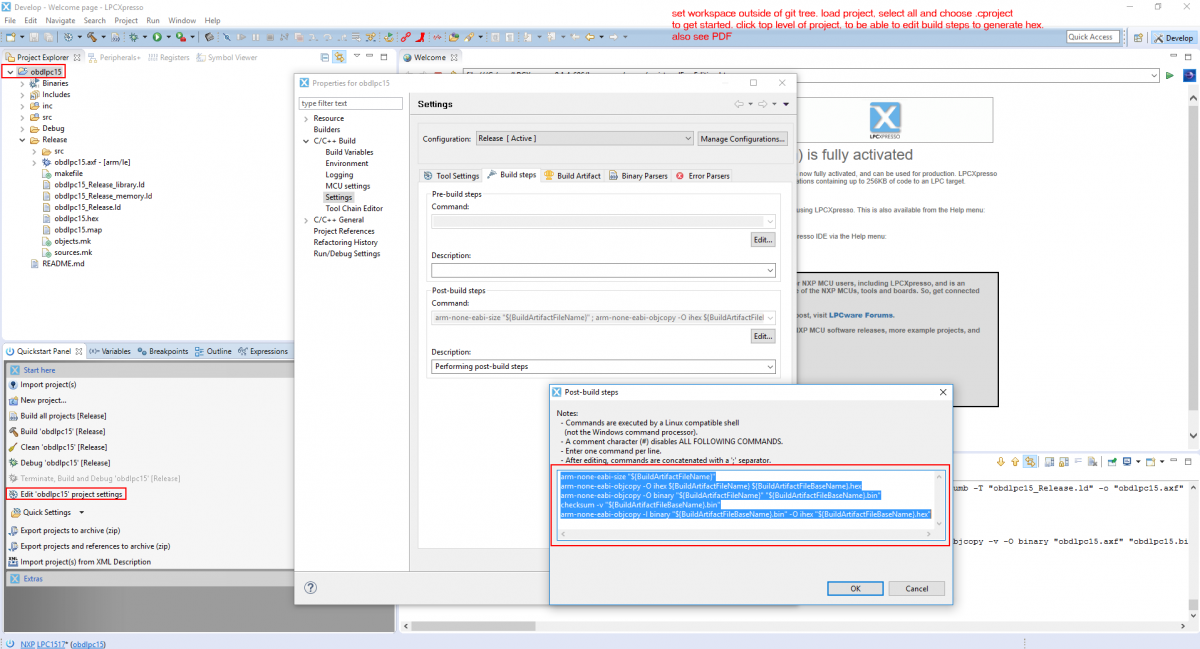

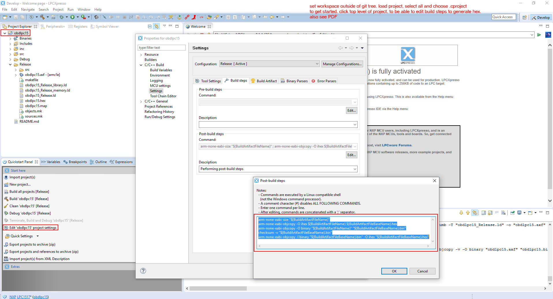

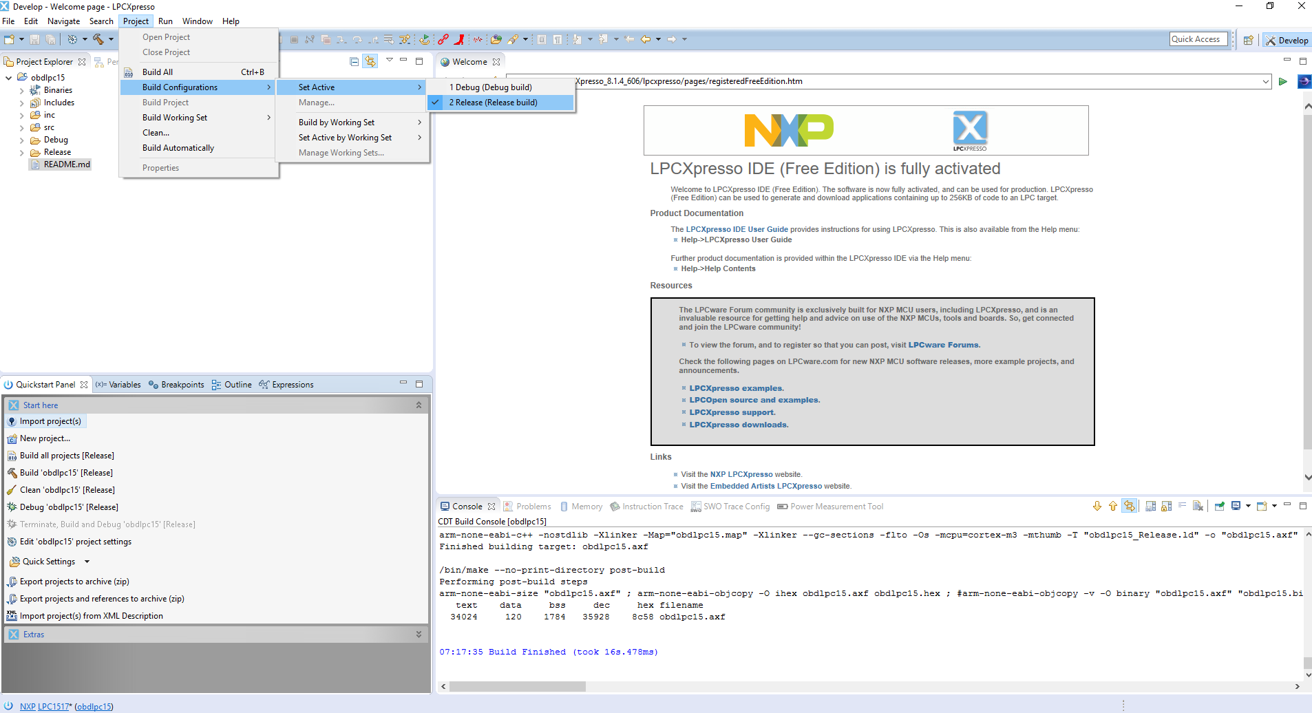

No it does not. You would need to get the firmware source code from github and modify it just keep calling the receive function, compile a bin, and put that firmware on the device. I have compiled firmware, depending on having the right versions of the software its not too hard. The biggest gotcha is there is an extra build step you need to put in the mcu xpresso IDE to get it to build a bin which can be uploaded by the firmware tool.
Here are some screen shots I took as notes for the environment setup, and the pdf where I found the information about the build changes. The flash tool to write to the adapter is called flashmagic and the free version is enough. https://www.flashmagictool.com/ There is more information on the official allpro page, although it seems to have changed again.
Its been a long time since I looked at this stuff, so I cant really help with further questions. I'd be looking at these same notes and trying to figure it out again myself. All of those images show some settings you need to set to get it to build, and provided it hasnt changed too much again, there shouldnt be any other settings. Note that lpc xpresso turned in to mcu xpresso - they are the same thing.
To create a monitor mode doesnt really fit with the firmware design, because the elm protocol is designed to trigger on a command from the PC side, so monitoring the other side doesnt really fit the code flow. The firmware can be set to read a number of responses, 5 at max over a short time, but that isnt really a monitor mode (and isnt enough for pcm hammer to see the response to switch to 4x from all modules either). To add a monitor mode you'd want to put a monitor command in the dispatch table to enable it, and call a function that probably sets a flag for monitor, which is calls straight in to the receive function (short circuiting the send a message part), and then keep it in the receive function while the monitor flag is set. To do it properly you'd need to add something so that every protocol checks the monitor flag and skips the transmit part, and doesnt exit the receive part. this would mean you'd need to power cycle the interface to get out of monitor mode, but being a single threaded firmware I cant see a way around this without the firmware ending up like spaghetti. A very simple way to do it would be to hack the receive loop in VPW only so that it never exits.... but that'd break your interface until you flashed back in the stock firmware.

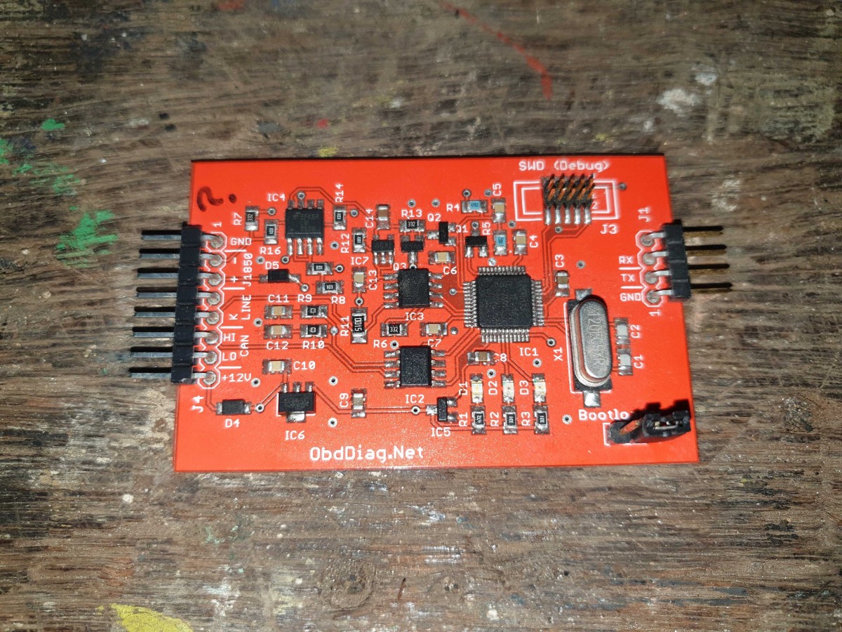

Your Allpro board looks different than the gerbers I had. I'll take some pics when I get my PCBs sent. The one I am having built has pinout for the bus side for a DB9 connector, or 2 rows of 100 mil headers, whichever you populate. Dropping LIN would be convenient and save some cost. I'd like to keep CAN on mine, since I have some newer vehicles with CAN that I may want to sniff as well. CAN i'm quite familiar with (electrically and transfer protocol layer, not so much with the application layer, though).
I'm actually an electrical engineer as my day job, and painfully familiar with soldering small things. Recently, I've been spoiled with access to my work's reflow bench for small QFNs, but I used to do it by hand with soldering iron and some desolder wick ;)
