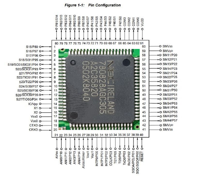

Well that was fun, found 1 module that had different chip markings in the pile that were more useful.
The brains of the unit is a NEC µPD780828A 8-bit Single-Chip Microcontroller
NEC IRELEAND 780828AGCxxx which would appear to have an internal mask rom
NEC JAPAN D78F0828A(A) hoping is µPD78F0828AGC(A)-8BT with internal flash memory (the uncommon module).
http://pdf.datasheetcatalog.com/datashe ... 3960_1.pdf
