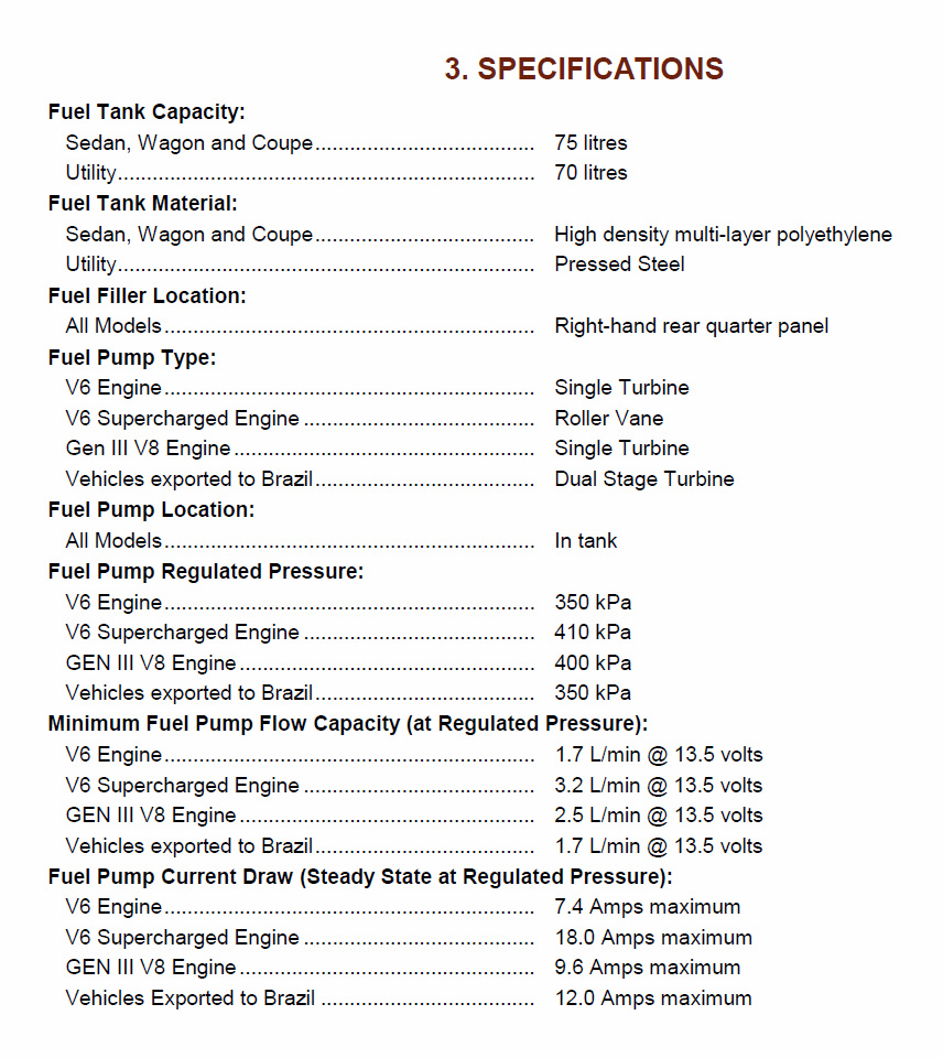

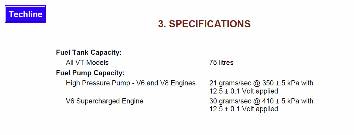

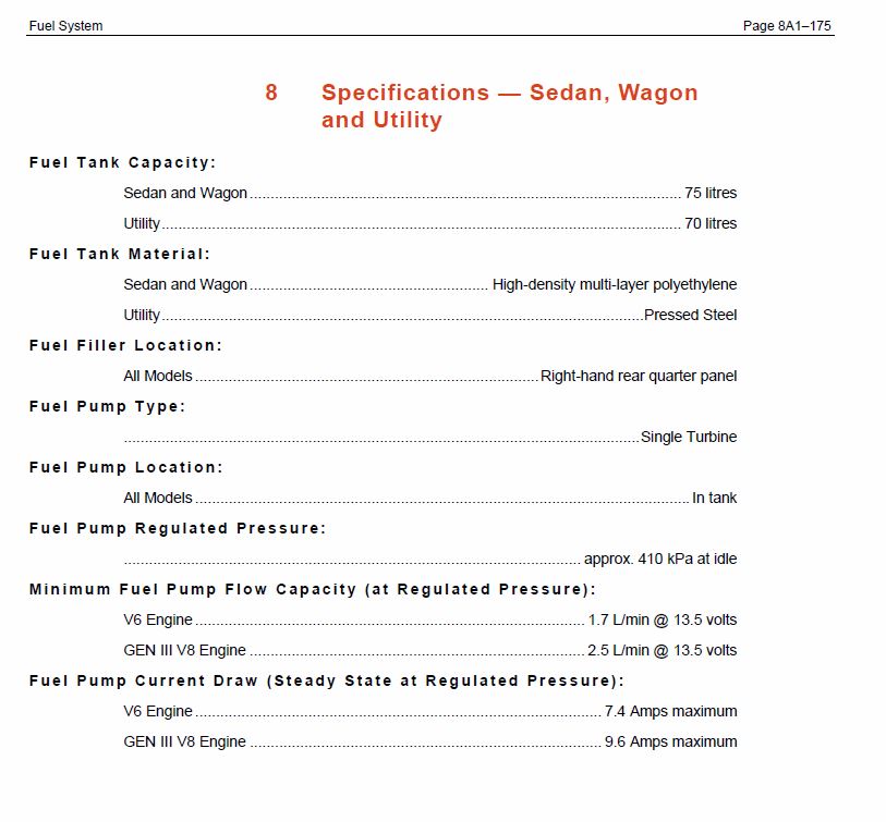

here's the Holden specs, VS is same as VT/VX except VS Series 1 N/A was 300kpa.
VT/VX
High Pressure Pump - V6 and V8 Engines 21 grams/sec @ 350 ± 5 kPa with
12.5 ± 0.1 Volt applied
V6 Supercharged Engine 30 grams/sec @ 410 ± 5 kPa with
VY
Fuel Pump Regulated Pressure:
V6 Engine................................................................ 350 kPa
V6 Supercharged Engine ........................................ 410 kPa
GEN III V8 Engine ................................................... 400 kPa
Minimum Fuel Pump Flow Capacity (at Regulated Pressure):
V6 Engine................................................................ 1.7 L/min @ 13.5 volts
V6 Supercharged Engine ........................................ 3.2 L/min @ 13.5 volts
GEN III V8 Engine ................................................... 2.5 L/min @ 13.5 volts
Fuel Pump Current Draw (Steady State at Regulated Pressure):
V6 Engine................................................................ 7.4 Amps maximum
V6 Supercharged Engine ........................................ 18.0 Amps maximum
GEN III V8 Engine ................................................... 9.6 Amps maximum
VZ
Fuel Pump Regulated Pressure: ............................... approx. 410 kPa at idle
V6 Engine ............................................................................................. 1.7 L/min @ 13.5 volts
GEN III V8 Engine ................................................................................ 2.5 L/min @ 13.5 volts
Fuel Pump Current Draw:
V6 Engine ................................................................................................. 7.4 Amps maximum
GEN III V8 Engine .................................................................................... 9.6 Amps maximum
VT/VX

out of the Holden workshop manuals.

The fuel flow of the L67 pump matches what I was told, but AC Delco's data sheet said the NA pump is 2.4L/min @ 200Kpa. Maybe the higher pressure of this table accounts for 1.7L/min?
yeah I agree on the current draws, seems like double what they should me.

Here's the PDF's for the fuel system from the Holden Workshop manual and screenshots.

That's interesting the standard pumps are listed as turbine where SC one is roller vane. I have cut open a few stock V6/V8 ones before to see why they failed and they were all roller vane as well.
Also the AC delco data sheet puts the VT v6 pump at 2L/min and 9.6 amps. Where as VN-VS non SC is 2.4L/min and 7.5 amps.
