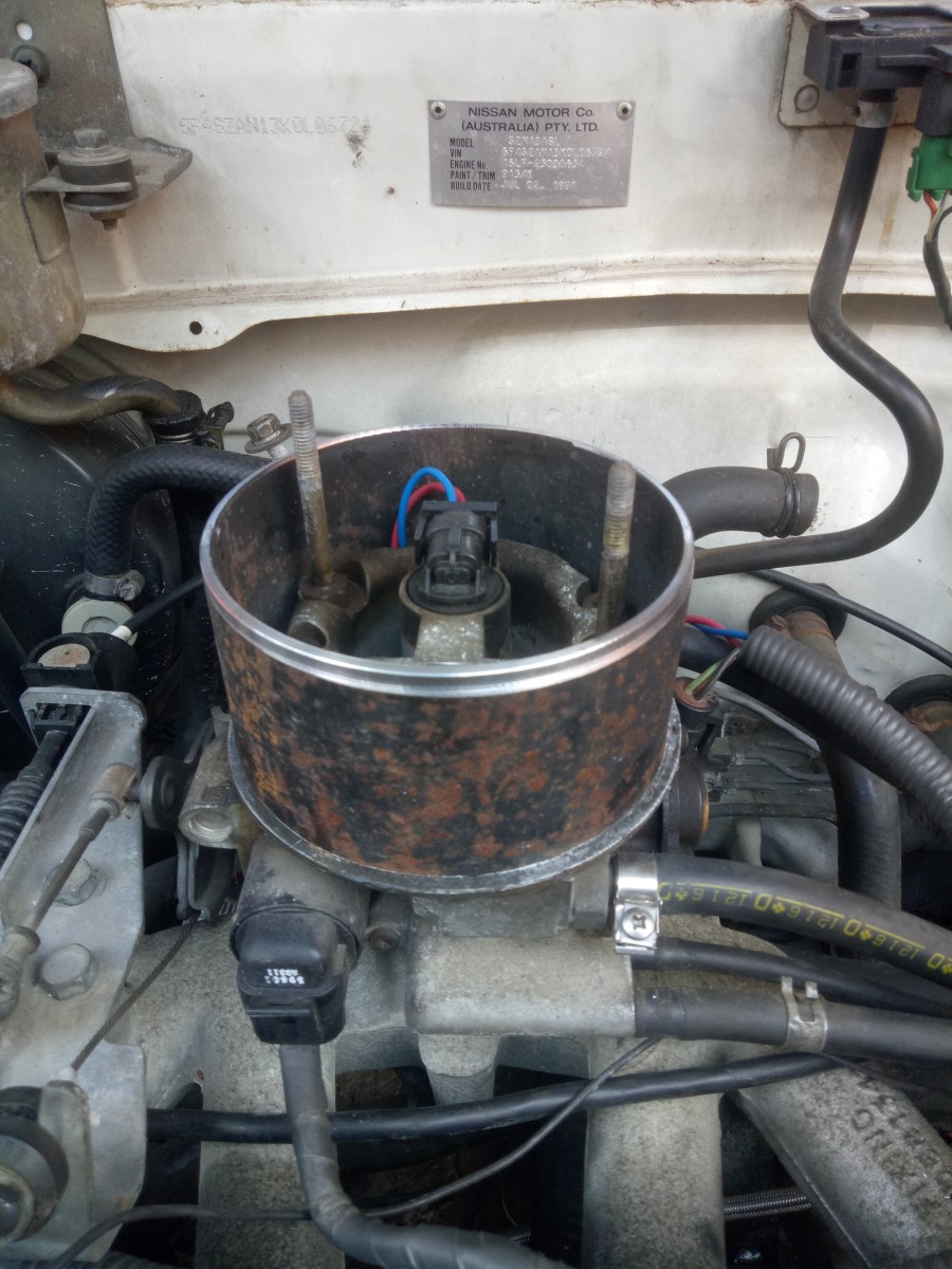

Hopefully have the TBI hat welded up today and a boost pipe bent and it'll be ready.

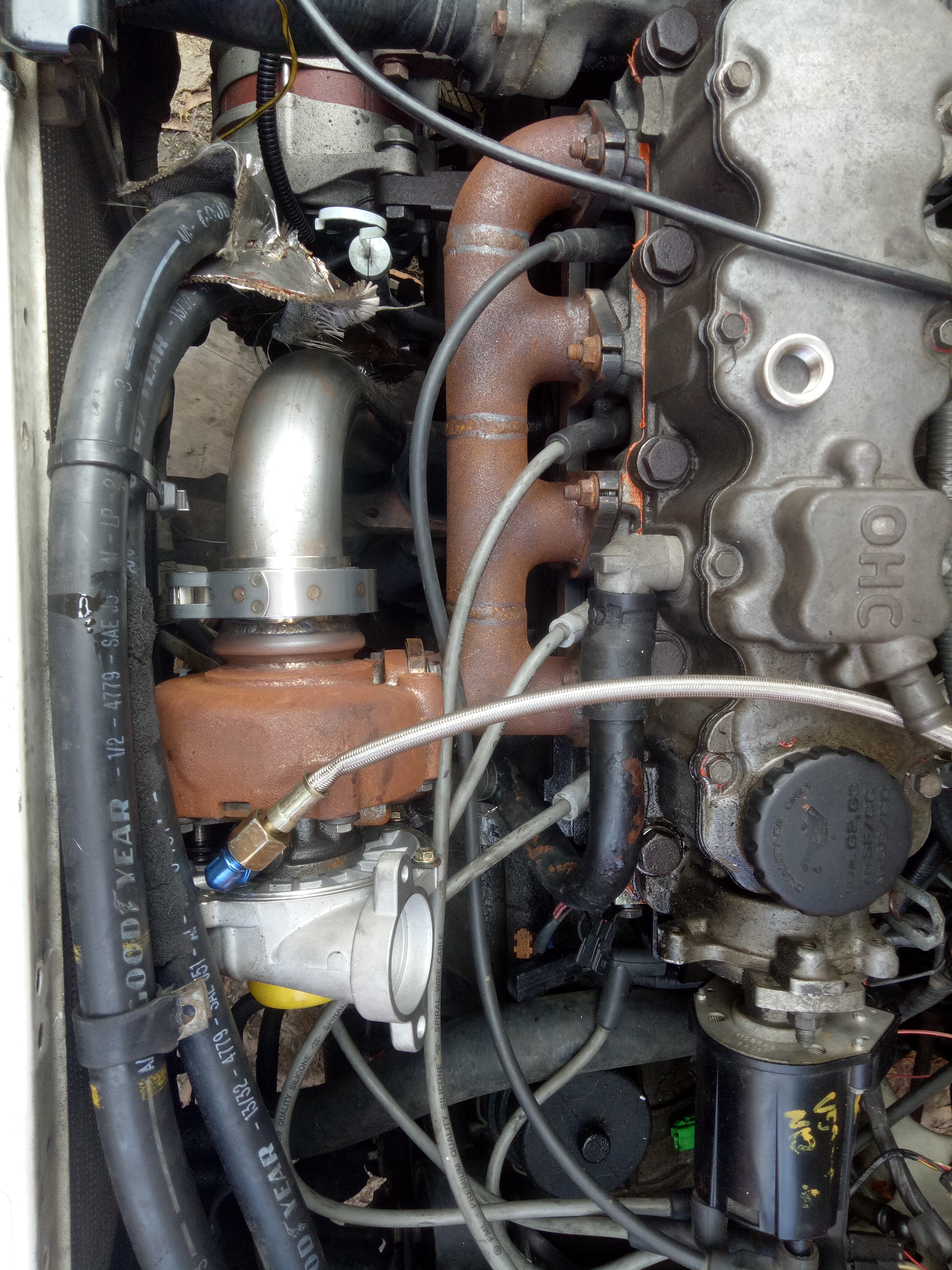

Need to grab some 120mm plate from town to finish the hat. My 38mm pipe looks far too small for the charge pipe so I'll get some 45mm stuff tomorrow (or maybe larger and squash it towards the hat end) . It's about as big as the hat will allow and will fit the turbo outlet nicely. The throttle plate also Looks to be 45mm

Another thing to consider is engine bay heat.
That is one very cosy confine, lots going on in a small space. Have you thought about a turbo blanket and header wrap.
To remove some engine bay heat you could add louvres or just cut a hole in the bonnet and use a scoop.
Are they A/C hoses, they will need wrapping/ insulating/ shielding as well.
MPI will fare better in terms of fuel delivery and distribution, is that worth thinking about.
Also, can that injector and the fuel pump supply enough fuel. Keep an eye out for 'salt and pepper' on the spark plugs.

A turbo blanket and heatwrap are planned. Yes that's the AC lines and will be about 2 inches away from the turbo when secured back to the chassis. They were originally that far from the headers in the stock config with some heatwrap so I guess they're OK with heat - within reason.
The tbi fuel system runs at 12psi. The pump used is the same for the mpi (3bar) and also same part number used in the ca18det version of the n13. I think flow should be OK. I won't change to mpi on this motor, I'll just drop the 1.8 in when the time comes.
I'm using an injector from a 2.2L motor. The 1.6 injector approaches 100% duty at wot at 6000rpm at 12.0AFR. I should be able to get away with 6psi up to 5000 on the larger injector... Maybe...
