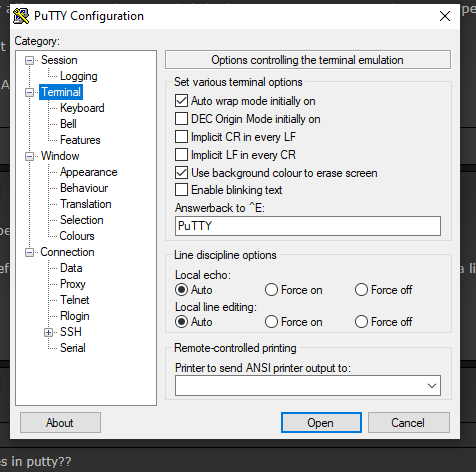

I took a quick look, is there any way to change what the enter key does in putty??
When I use termite I can tell it to send a carraige return(CR) or a linefeed(LF), or both.. I don't know the ford elm327 but maybe it needs a linefeed char AND a CR?? Might not be getting the message without it?

Yes, in the Category box under Terminal ...ironduke wrote:I took a quick look, is there any way to change what the enter key does in putty??

Thanks, I must have an older version then? or is it the implicit lines?? lol, what does implicit mean anyways??Gampy wrote:Yes, in the Category box under Terminal ...ironduke wrote:I took a quick look, is there any way to change what the enter key does in putty??
