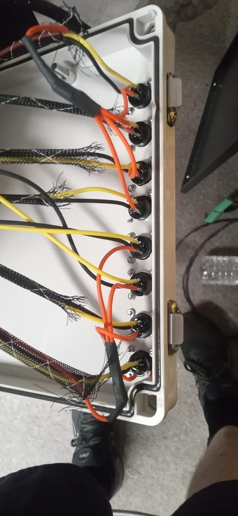

Spent $270 at jaycar during the week & picked up some IP67 plugs/connectors to pass wiring through the back of the cabinet.
Since I want to be able to unplug everything & since the power cable feed to retarders is unpluggable, the load cell, speed sensor also need to be to.
All 3 cables will then be put together & i'll use some heavy duty spiral wrap to protect them.
I will do a similar thing with the incoming power feed & some ethernet cabling which will be used to trigger inputs on Fan VSD's.

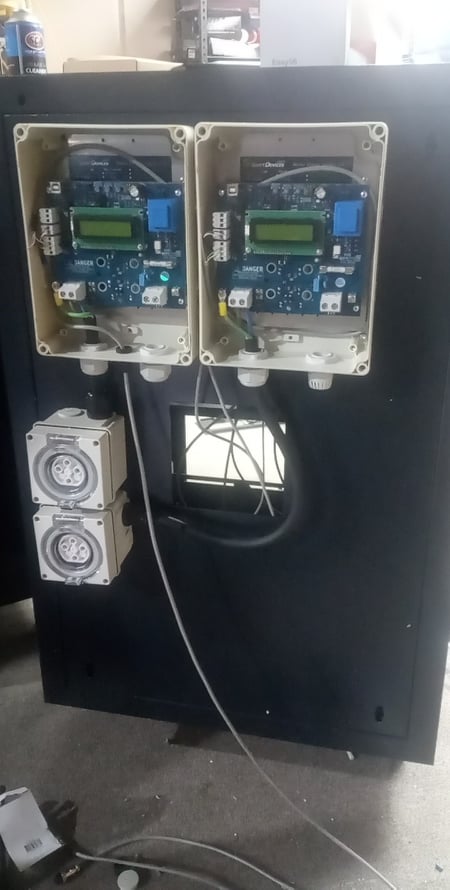

Picked up the 2nd Power supply & mounted/wired in the connectors.

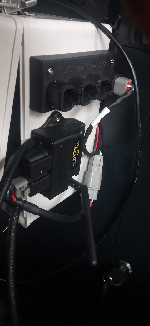

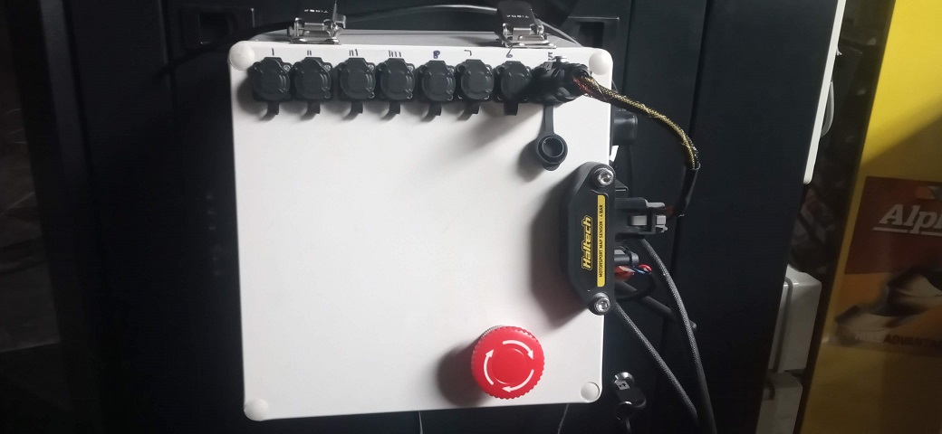

Latest photo's.
Wired in the analog sensor wires to some connectors & mounted on a box, which is then mounted to dyno cabinet.
Includes the emergency stop button & 4 bar map sensor, dual haltech wideband, can hub & bluetooth antenna for SP6 controller. Includes the emergency stop button & 4 bar map sensor
Dyno retarder is dummy assembled, doing some final mods tomorrow to level shaft.

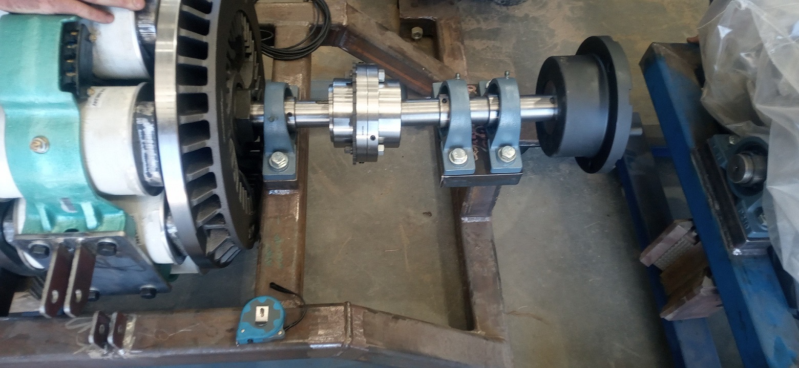

So i got the retarders to the workshop a couple of weeks ago, only had a chance to have a quick play before i flew out for work. Found that we had a bit of a vibration happening on 1 of the retarders before it eventually moved in the pillow block & made slight contact with the frame.
On easter friday i moved retarder back into position, drilled pillow block grub screws a bit deeper into the shaft, then attempted to fix the alignment problem by eye-balling it. Ended up shimming 1 side of the retarder and 1st pillow block before the end. No more vibrations & the coupler no longer moves around a whole bunch.
Put my ute back on for some testing again, before i started messing with the boost controller, didn't really make any changes to the tune since the wideband sensor appears to have shit it-self, but love the repeatable power runs it does.
Anyway i took my garmin virb camera down on sunday & recorded this video.
https://youtu.be/1iJSnMotyZU
