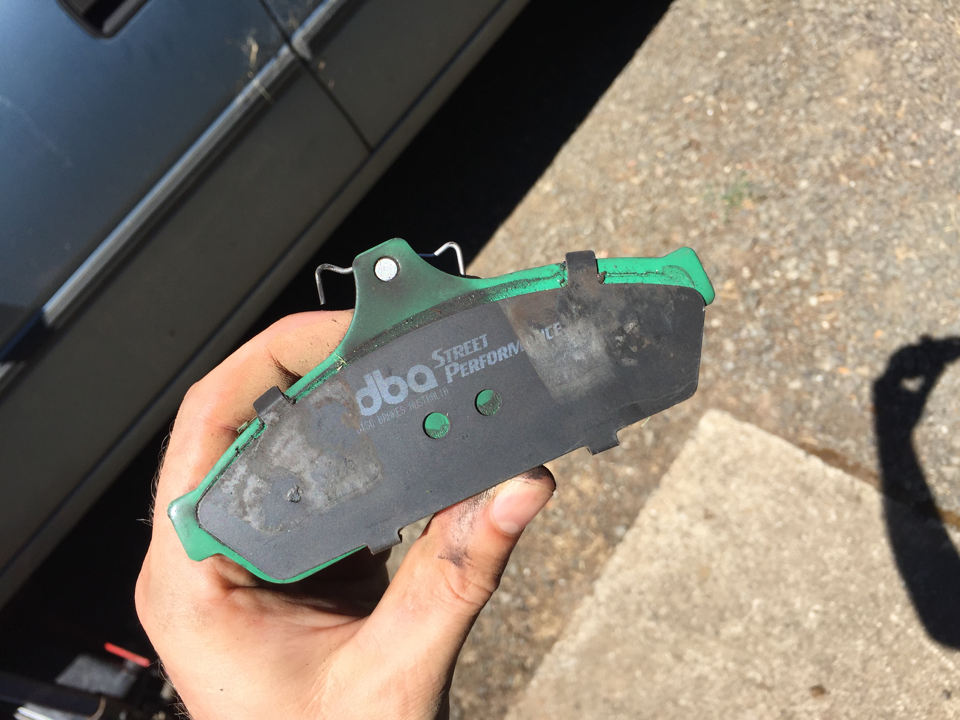

Re: Brake pads.
Pads arrived, funny thing is they are the same green like the EBC green stuff pads I used over 10 years back.
- Posts: 8114
Re: Brake pads.
Very happy with the pads, they out perform the Maxistop out of the box despite needing another 1000km or so to fully wear to the taper caused by caliper flex, no machining of the disks were done either.
Also they are way more fade resistant too. Would recommend as a drop in upgrade.

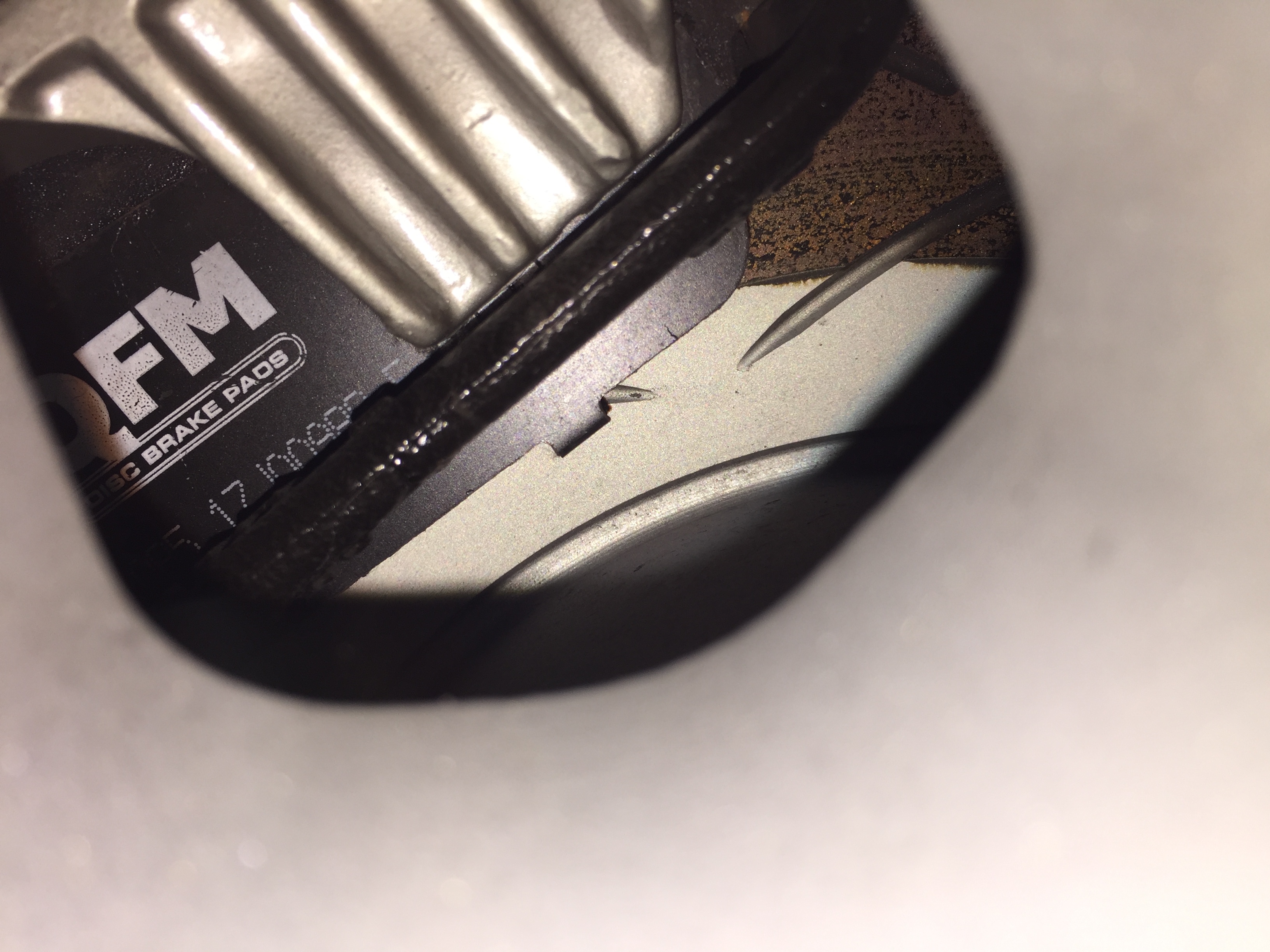

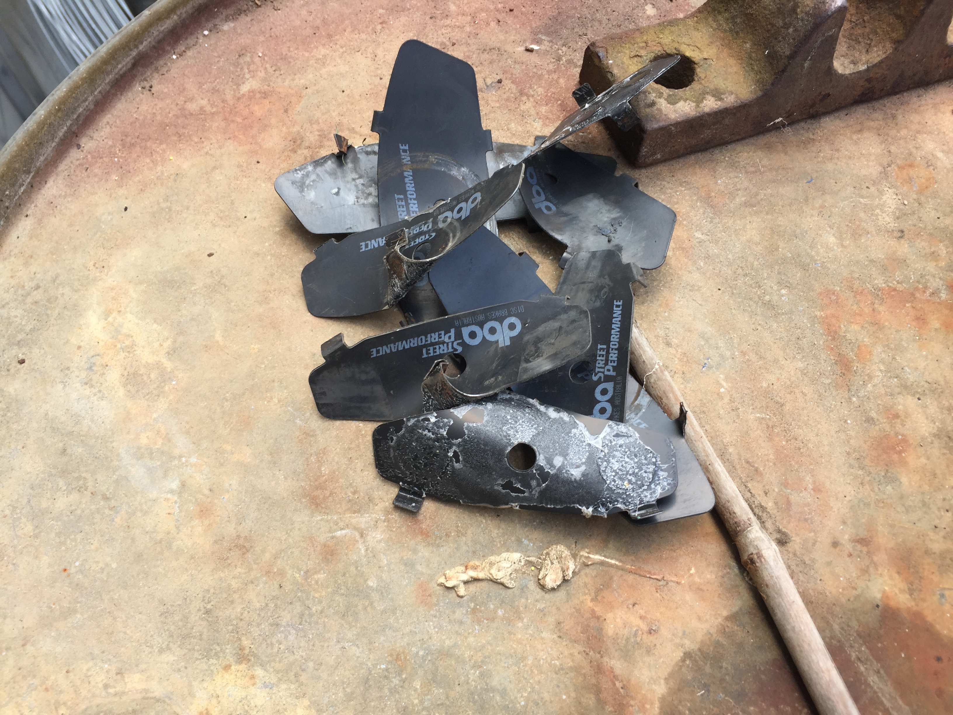

- Posts: 8114
Re: Brake pads.
So, the brakes were great out of the box but did seem a little spongy but I thought that was becasue the pads weren't worn in yet as they tend to have to wear on a taper due to the caliper flex and then the pedal normally firms up after 1000-2000k.
Well the brakes were getting worse and worse and more spongy and making heaps of creaking sounds when pressing the pedal.
Worked out what the issue was. Turns out all new pads come with a rubbery backing plate. They were forcing themselves out. I removed them all.
This made a huge difference, stopping good again and the pedal drop is like half of what it was before and feels firm and not spongy.
Then I had a light bulb moment
Maybe this is why the red VP brakes were so spongy and shit compared to the VR with the same setup and pads.
Sure enough.
Plates! and they have worked themselves out just like the shitbox ones. I checked the VR which has the same setup but done 4-5 years prior with exactly the same model of QFM pads, yep! no plates on them.
Now I know why and can fix the lack of brakes on the red VP with ease.
So I highly recommend if you get new pads is to remove the backing plates, they only cause issues. Ironically removing them from the shitbox actually stopped the creaking sounds on pedal depression.
Sure enough.
