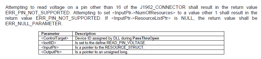

Voltage should be checked before opening a protocol. No point opening a protocol if you know battery voltage is 0v ect. PCMHammer doesn't do that check, but its an easy check to put in.
Once voltage is confirmed to be acceptable, only then should a protocol be opened.
Your assumption is for reading pins when connected to a protocol, When reading battery voltage, you pass the device id.
Please see below snipit as per J2534 document:
Ok, must be error in dotnet library. j2534-sharp uses DeviceID.
Thanks for correction.
