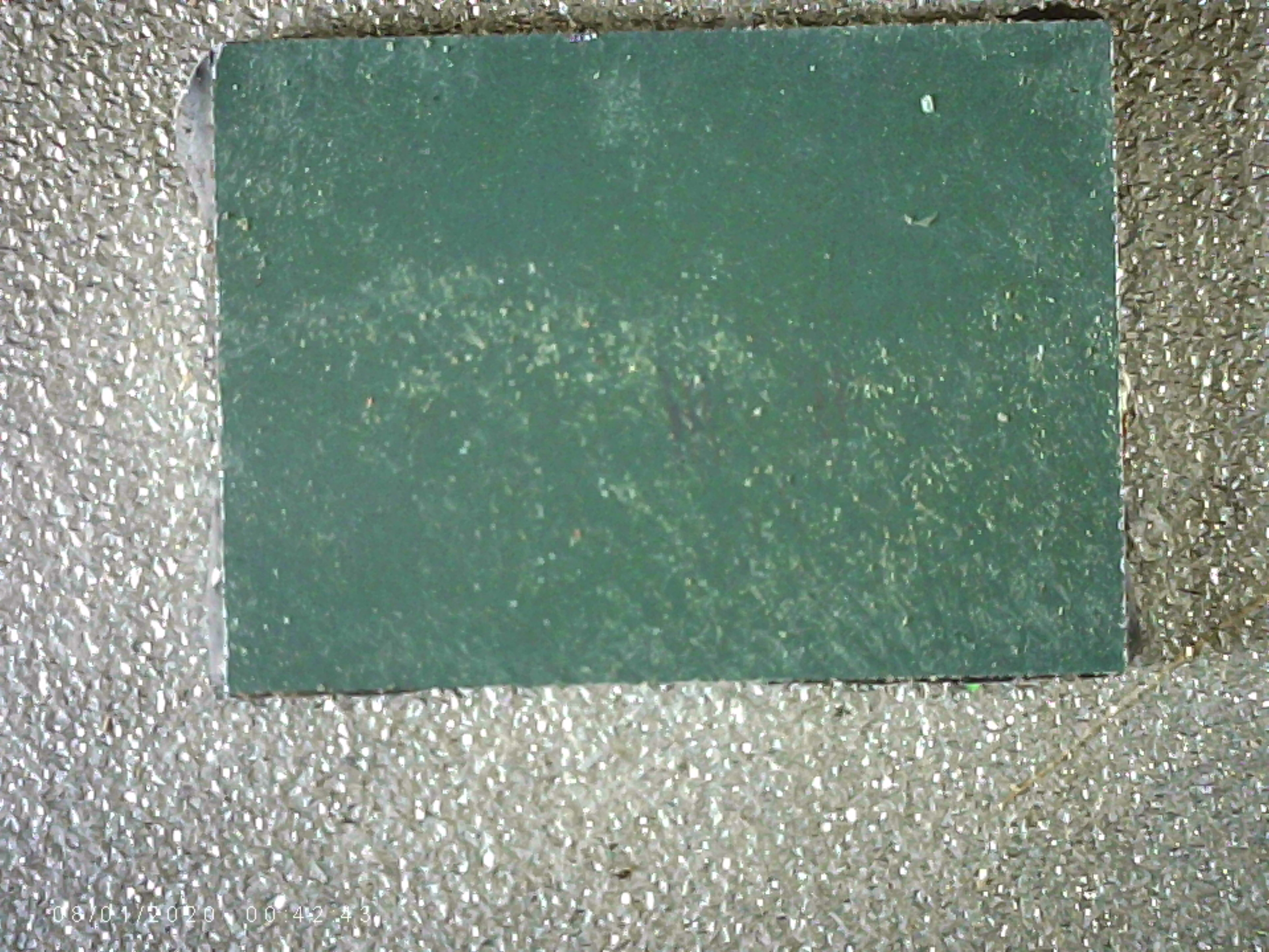

Re: Delphi P10 PCM (used for GM Inline 4.2L)

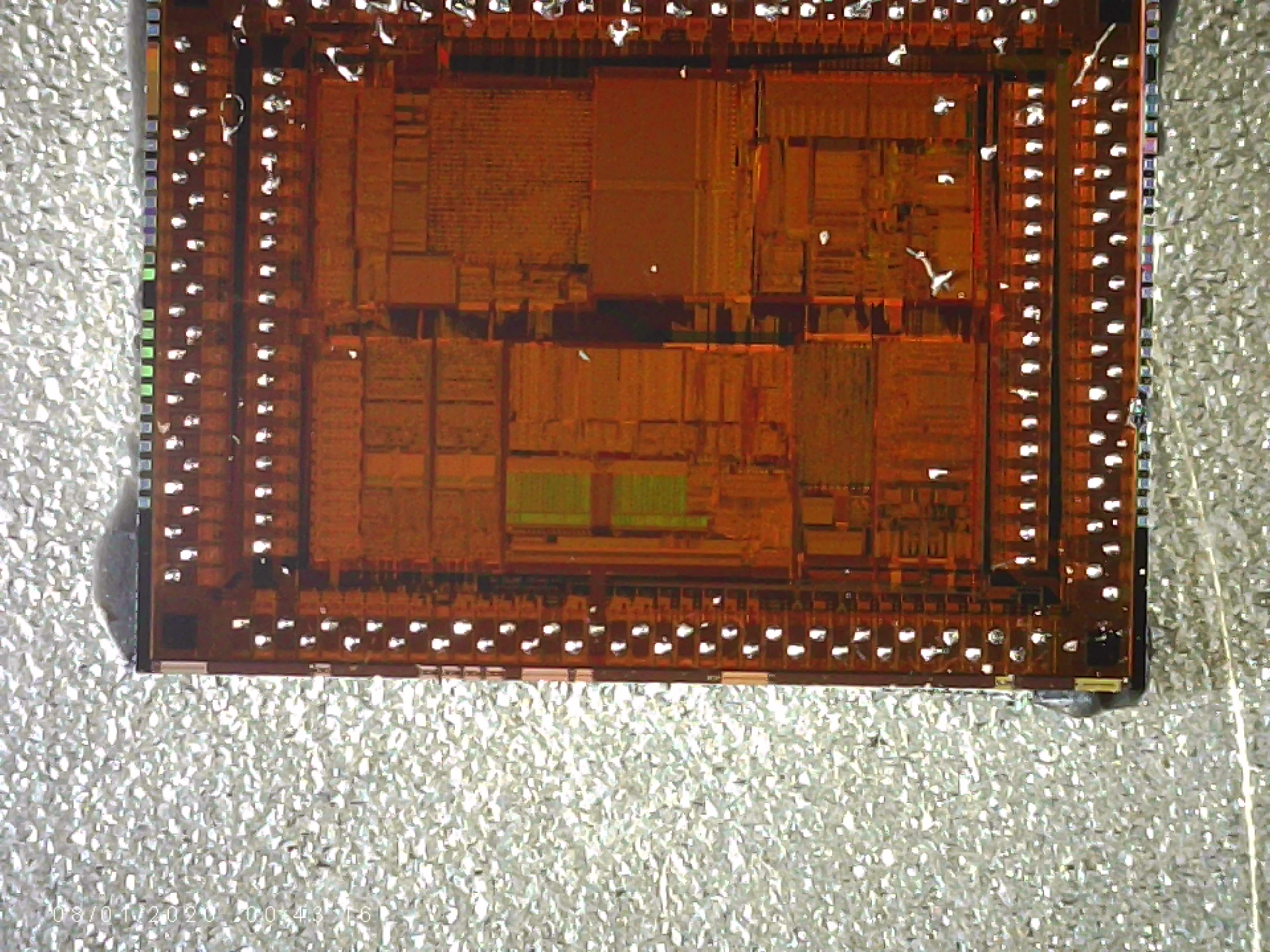

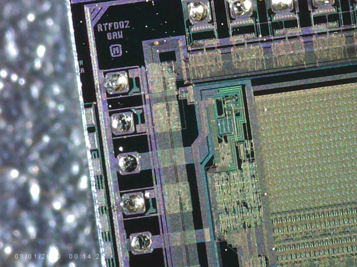

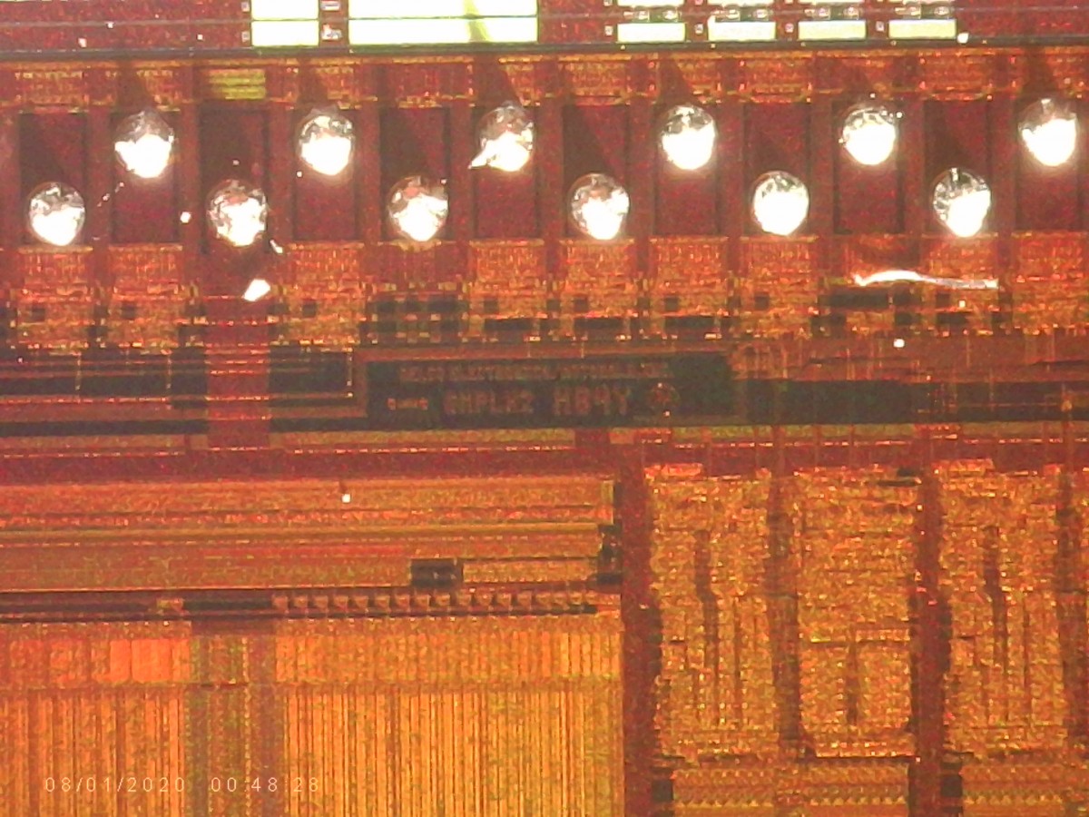

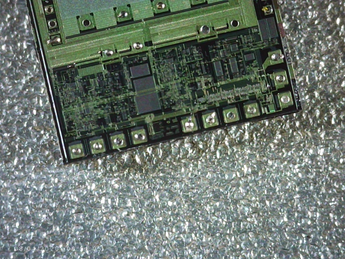

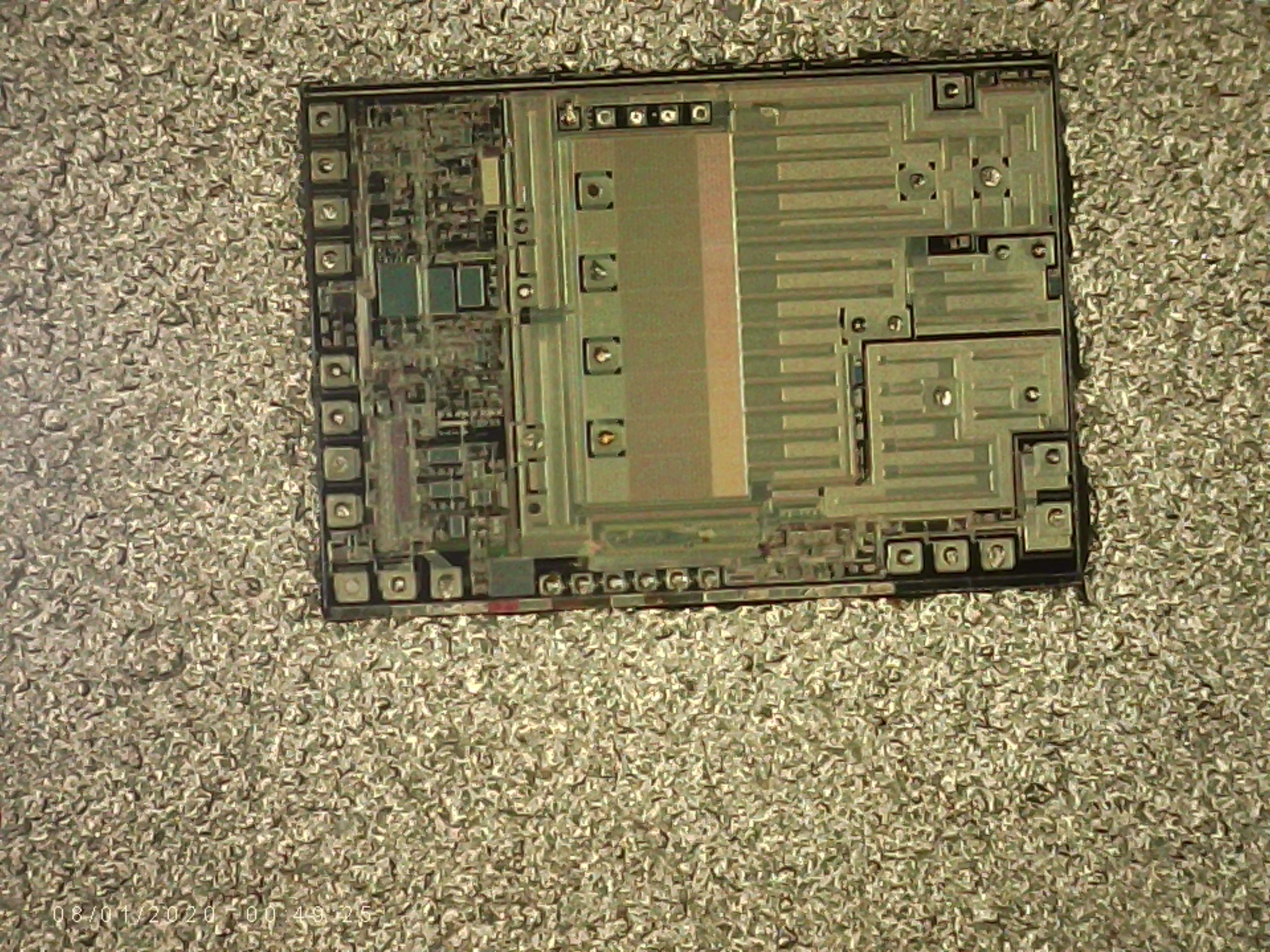

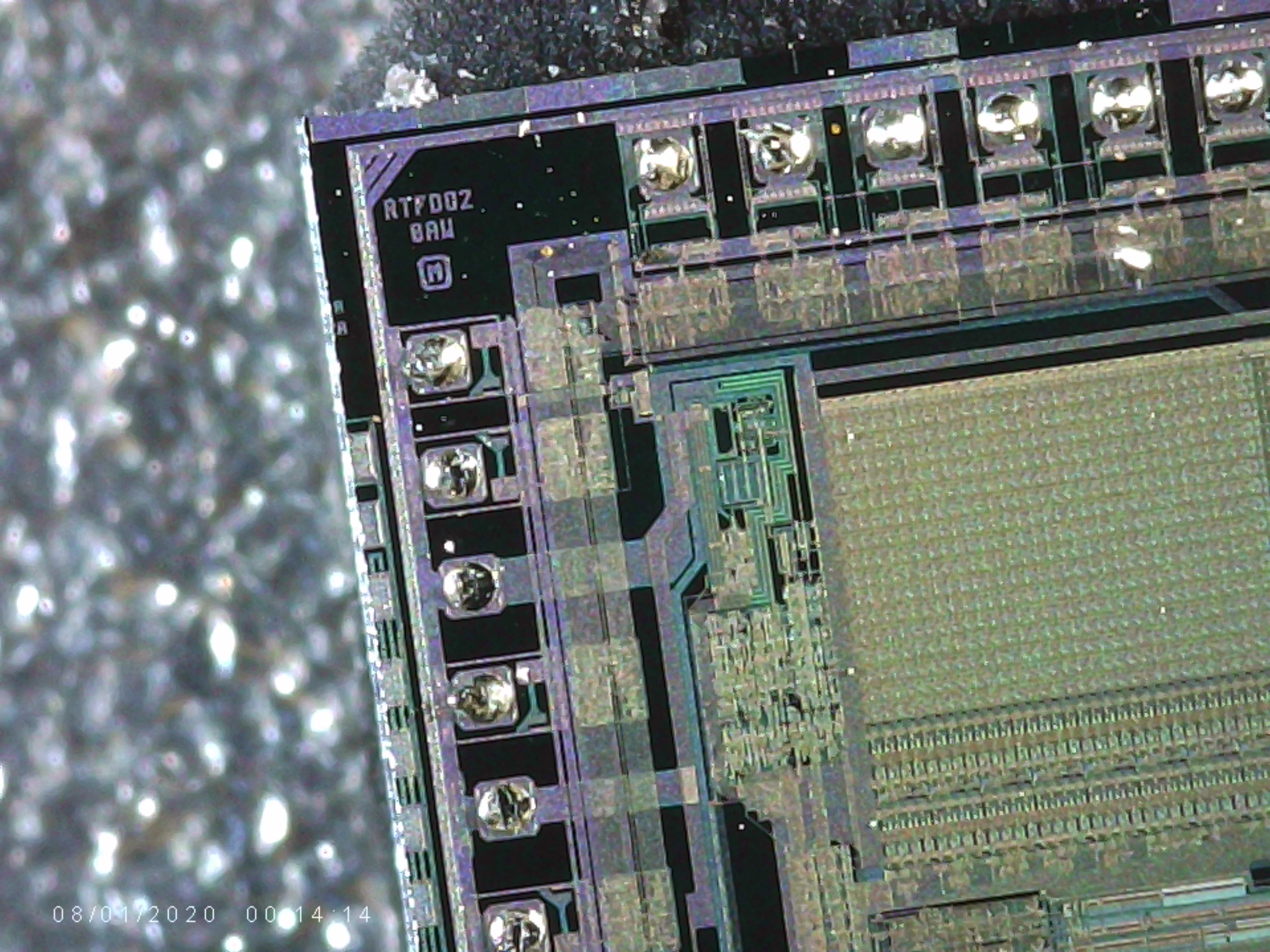

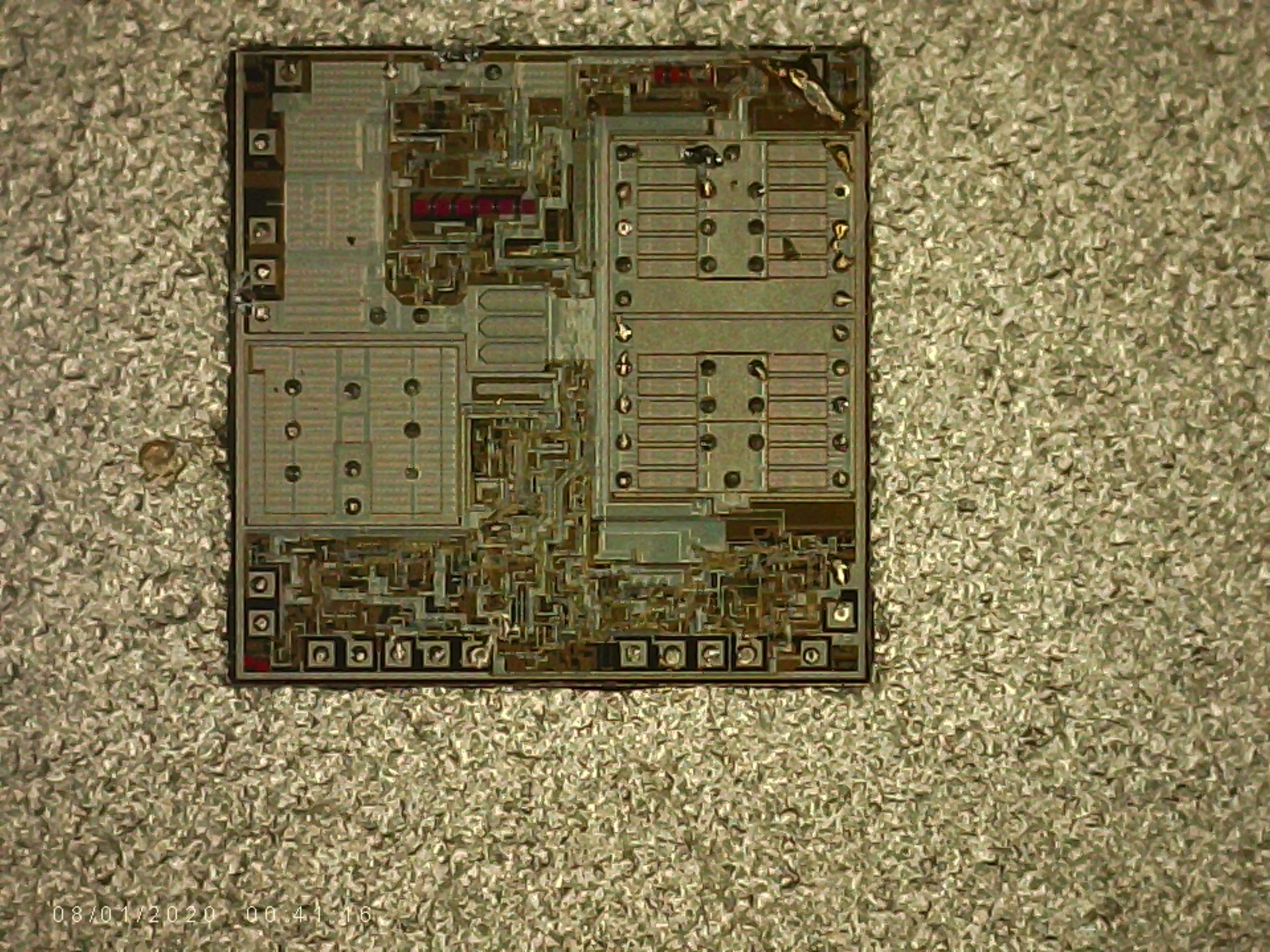

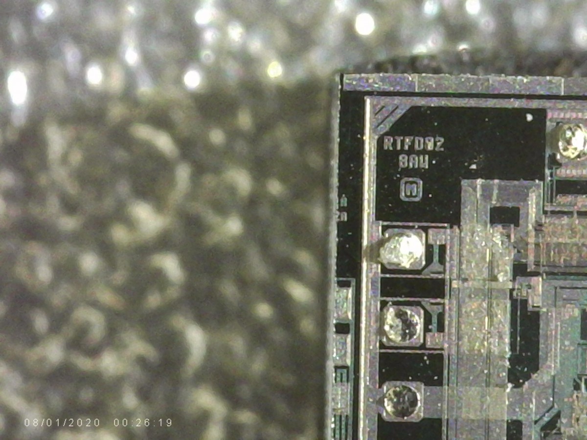

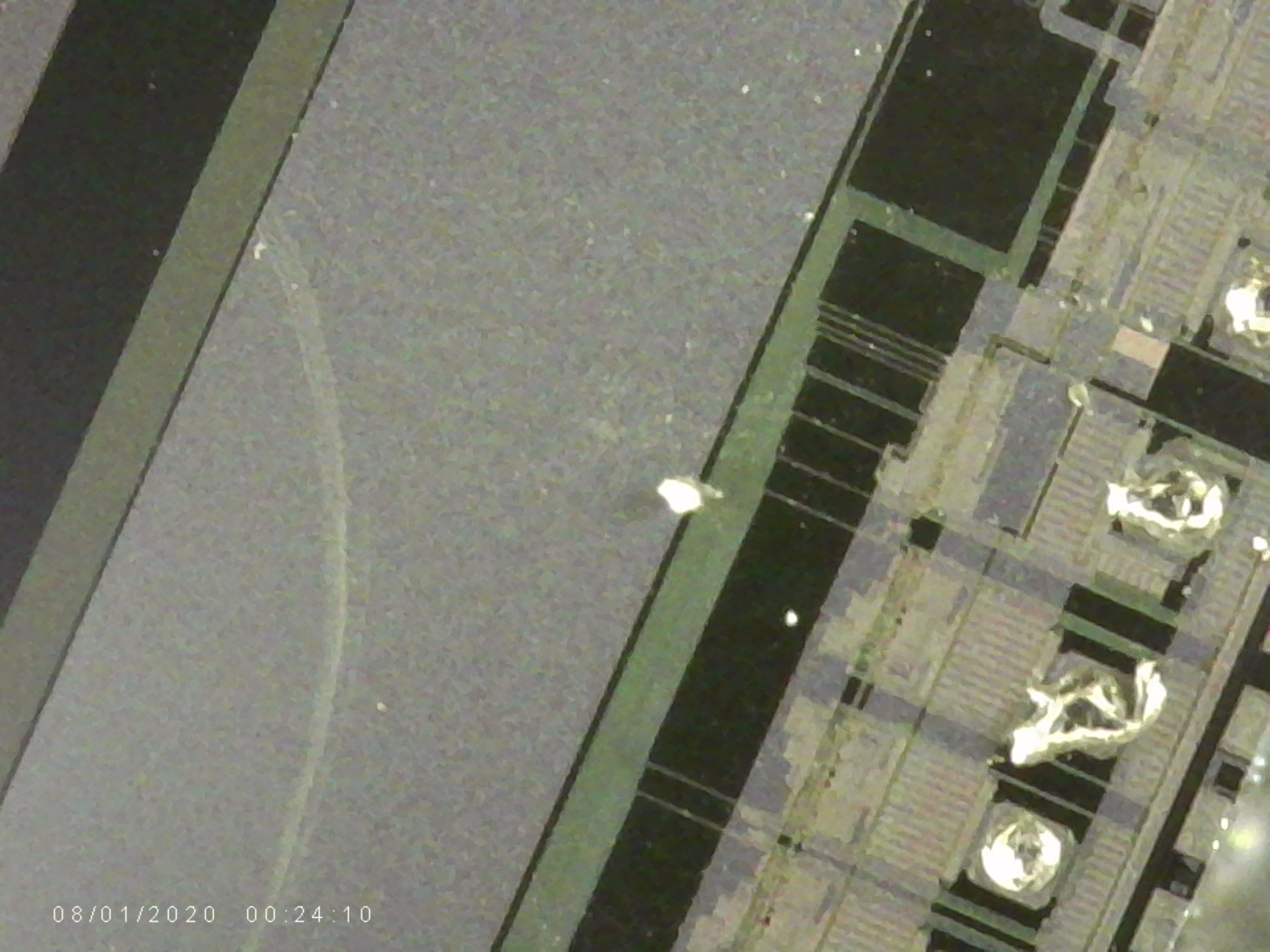

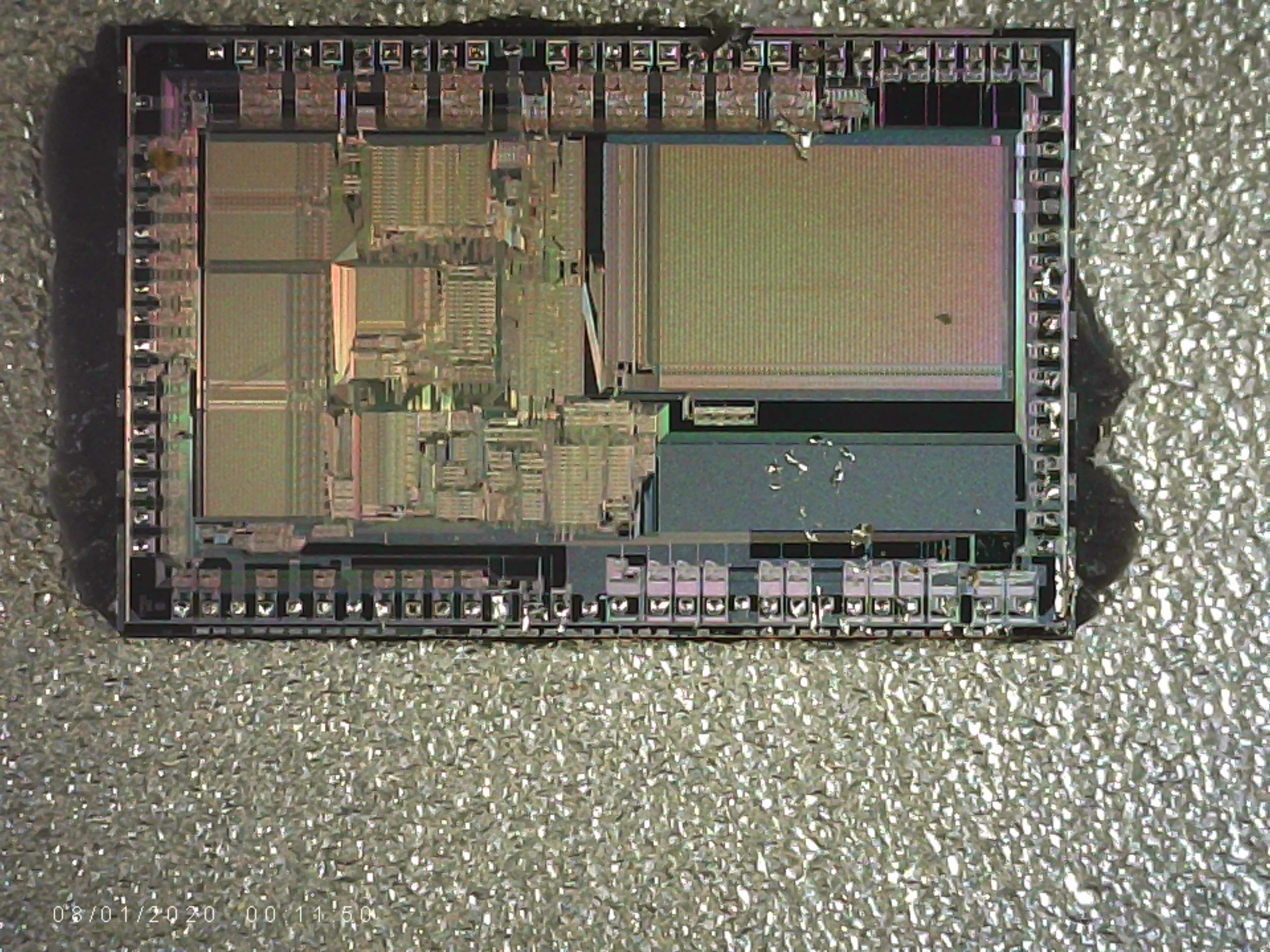

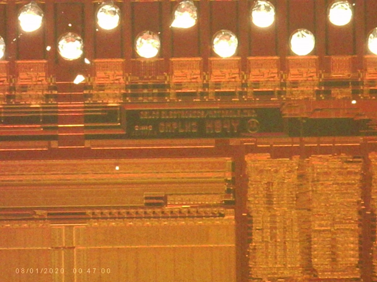

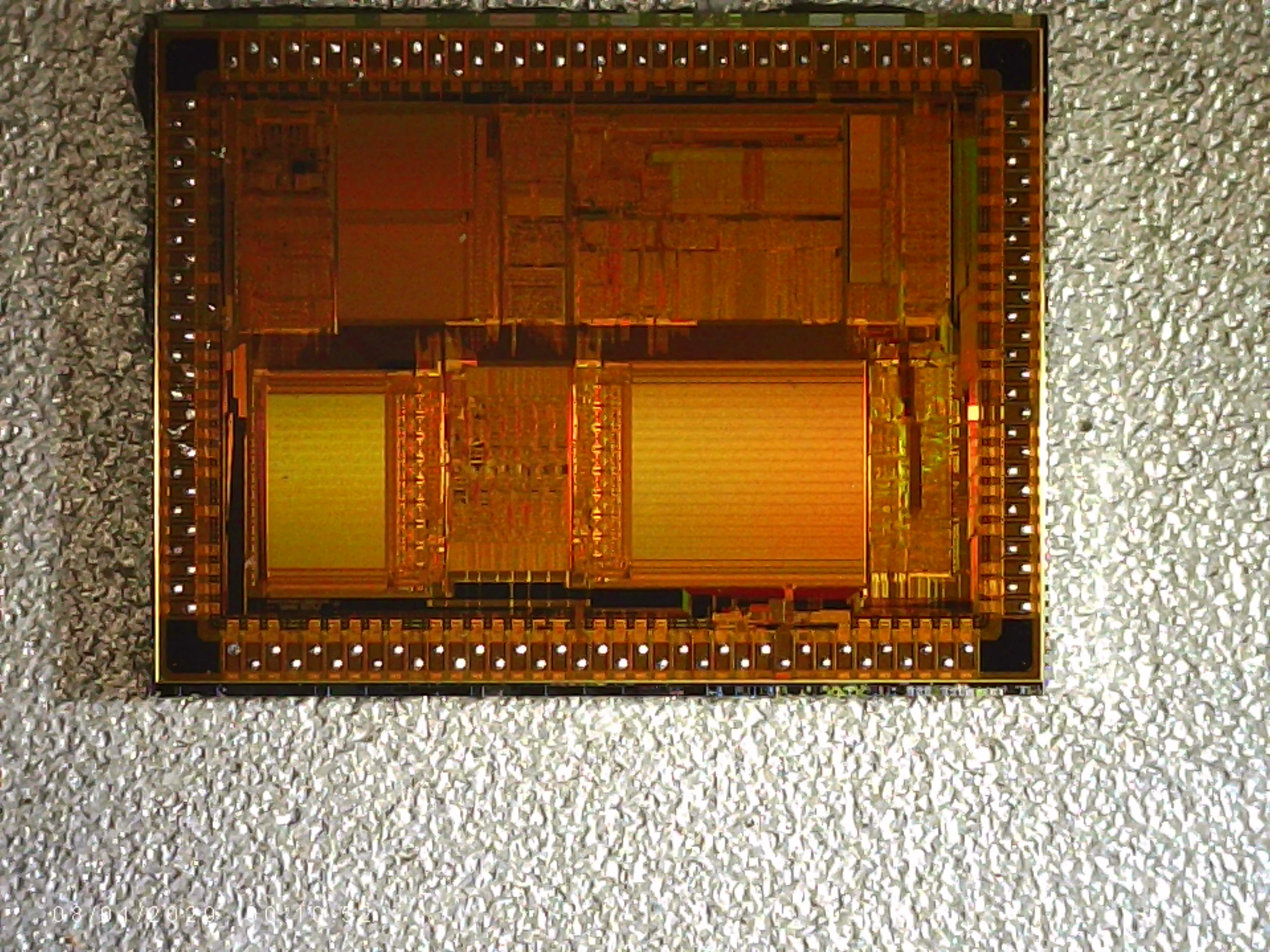

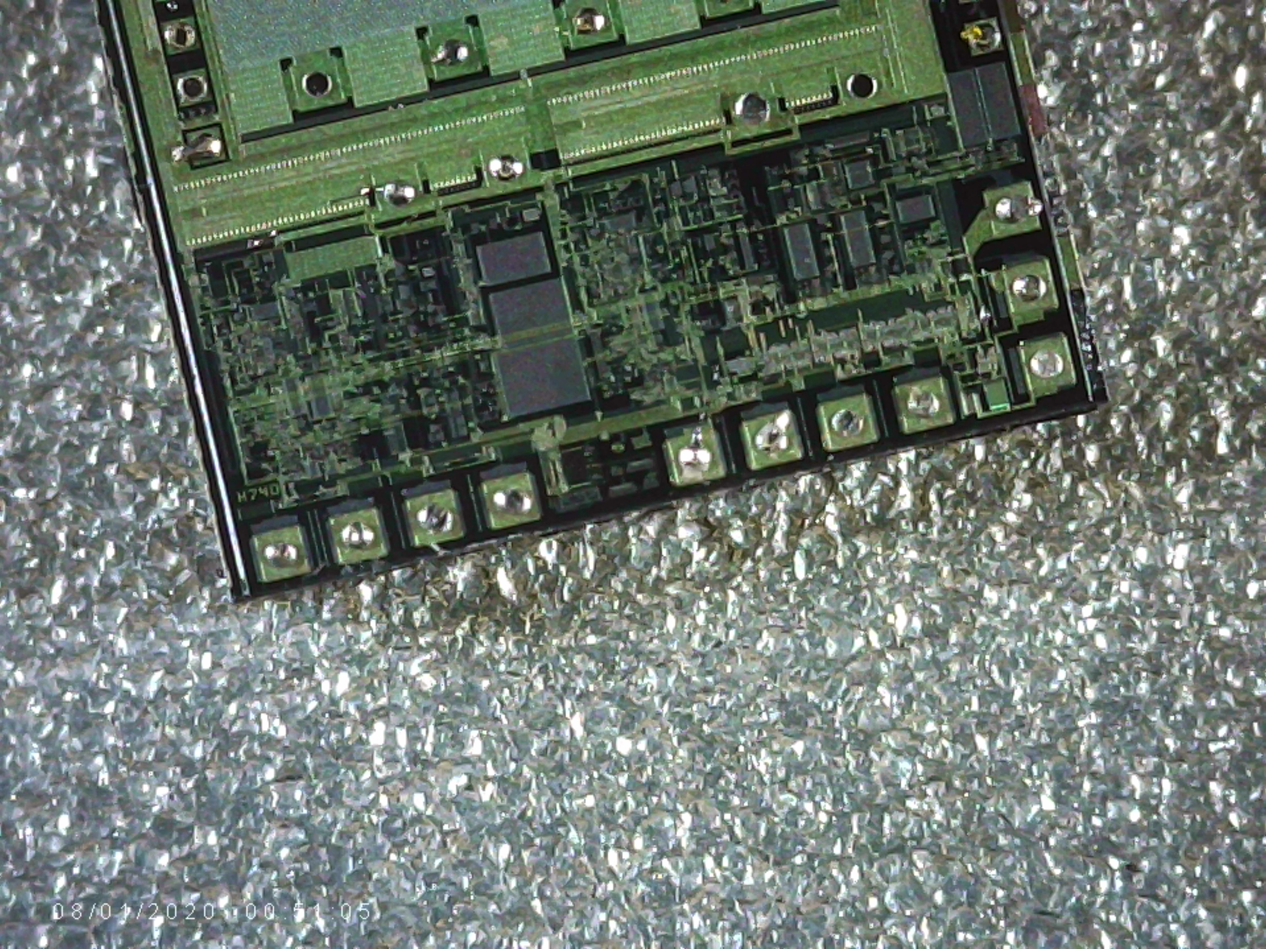

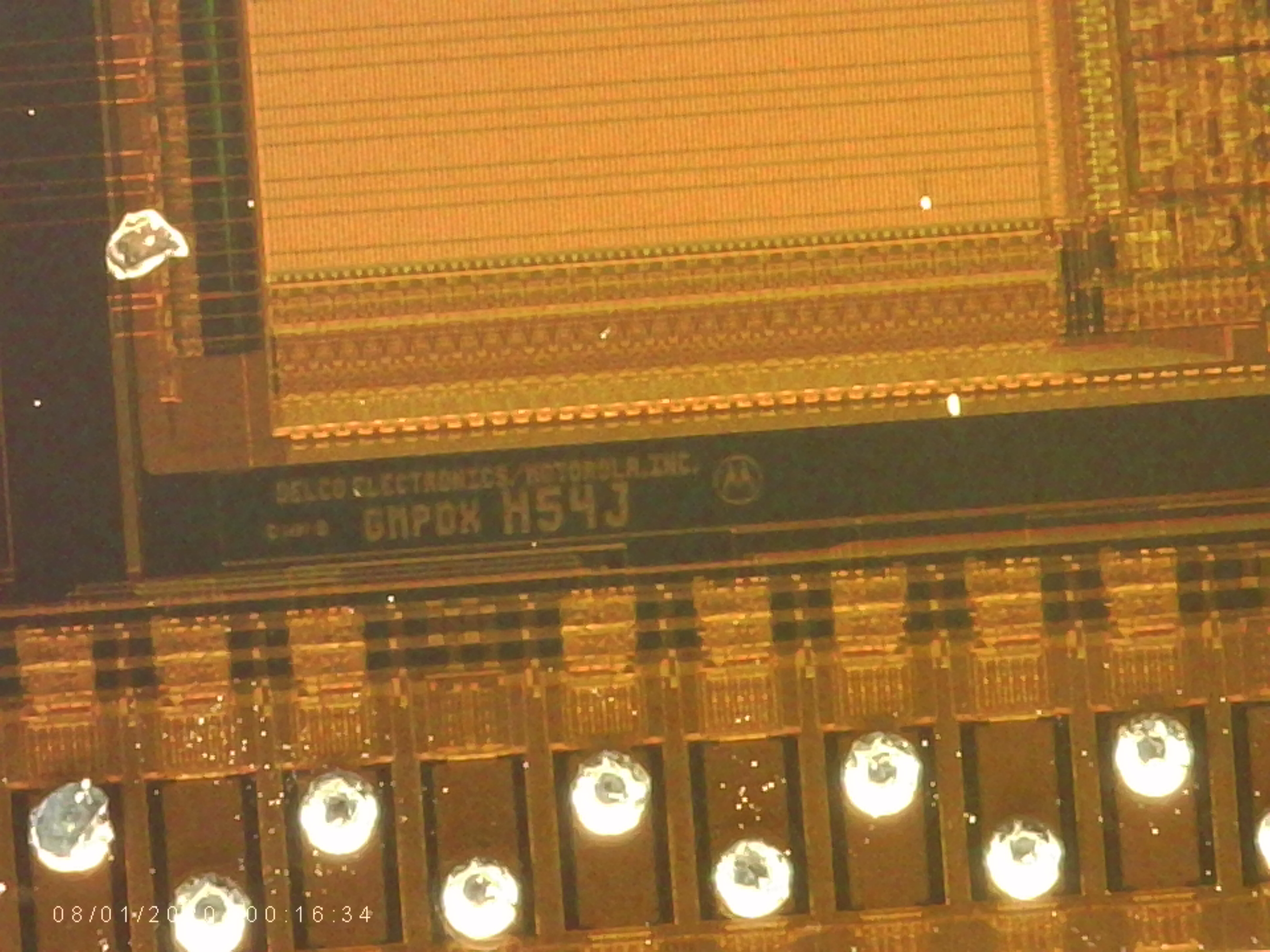

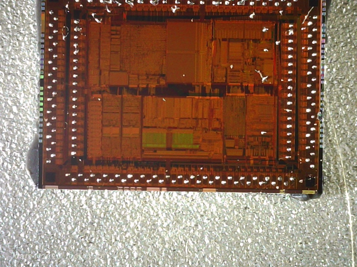

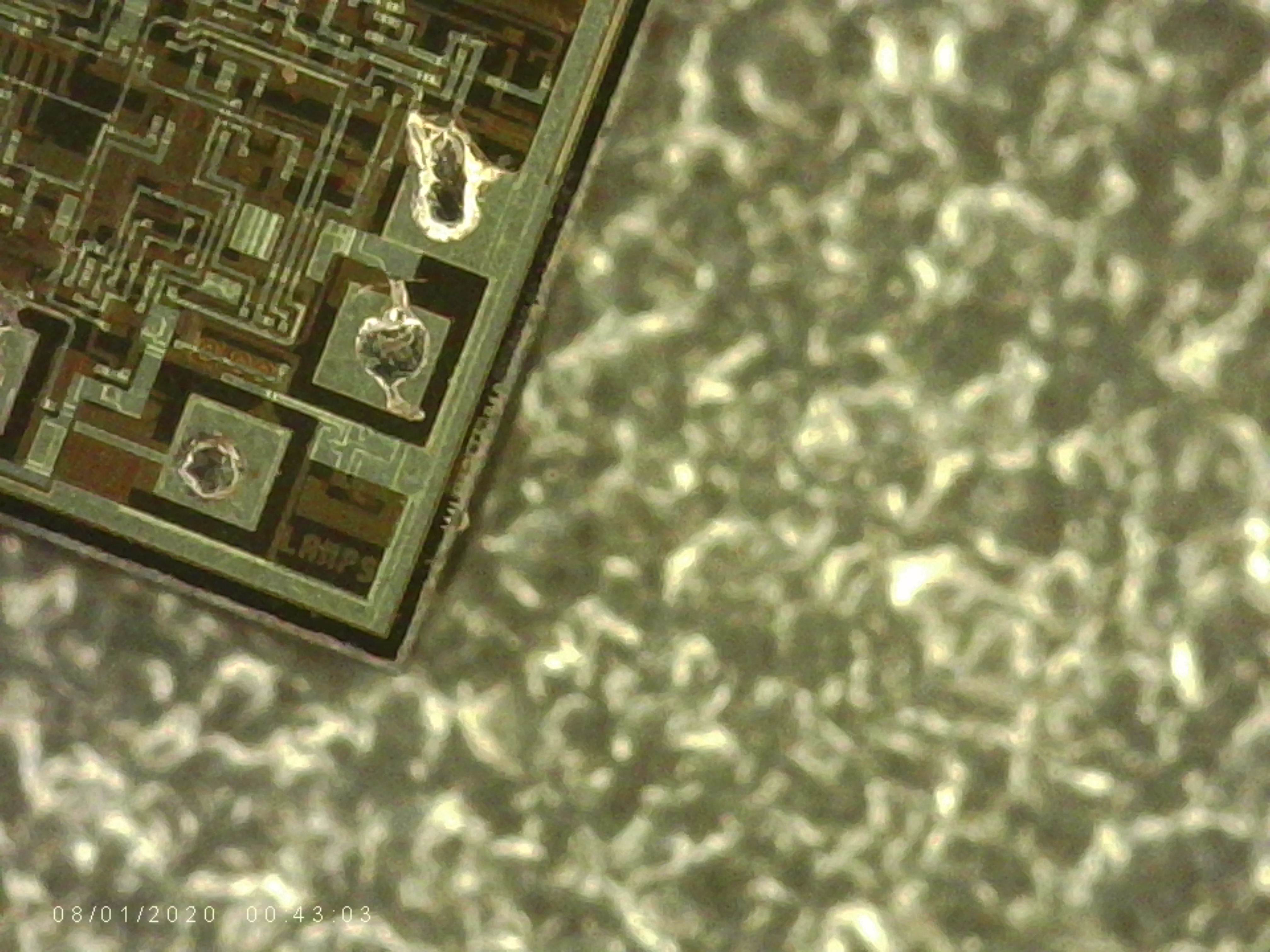

I have pulled quite a few of the flip-chips on this board and examined them under my microscope. I am in the process of trying to ID them. Hopefully if we learn it's hardware and learn it's similarities with other GM PCM hardware, it will be easier to crack.
darkman5001
- Posts: 276
- Joined: Fri Dec 17, 2021 10:15 pm
- Location: New Jersey, USA
More
darkman5001
- Posts: 276
more
darkman5001
- Posts: 276
more
darkman5001
- Posts: 276
Last one for now...

I know it's been a few weeks since I have uploaded anything else on the P10, but good news... The circuit board I needed to solder the flash chip to has arrived. I soldered it on tonight and already pulled the contents of the chip. Hopefully someone can pull this bin apart and find some info that will help us test the P10 with PCM Hammer and Universal Patcher.
