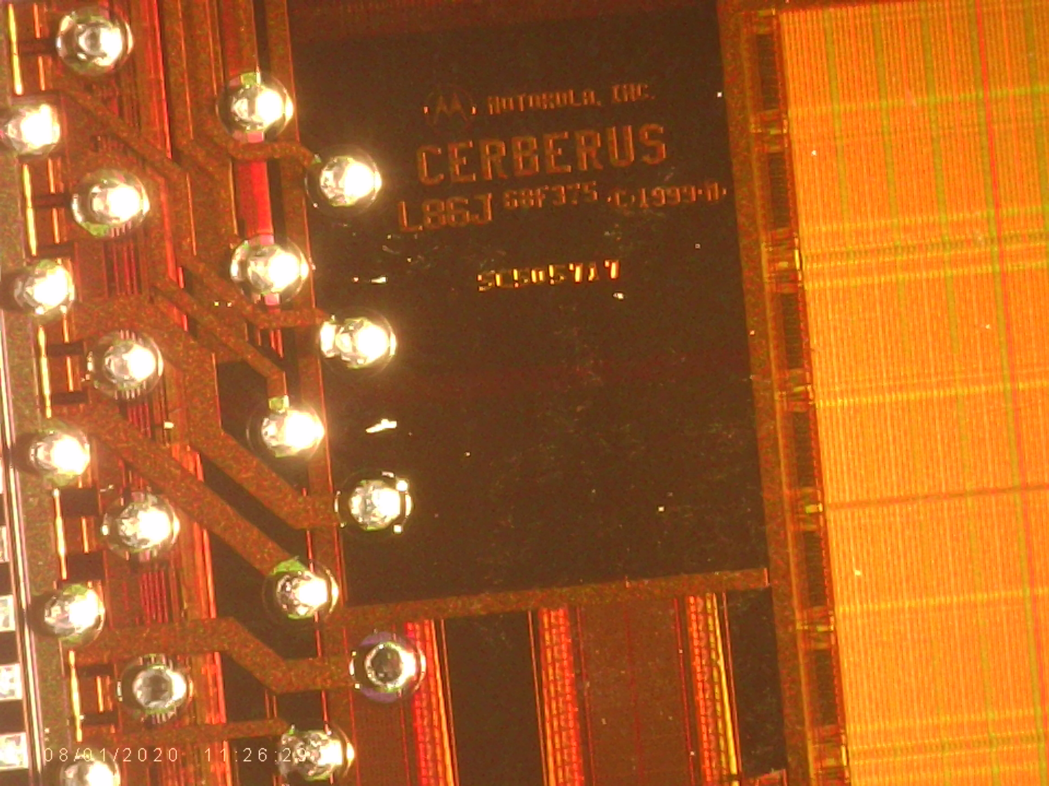

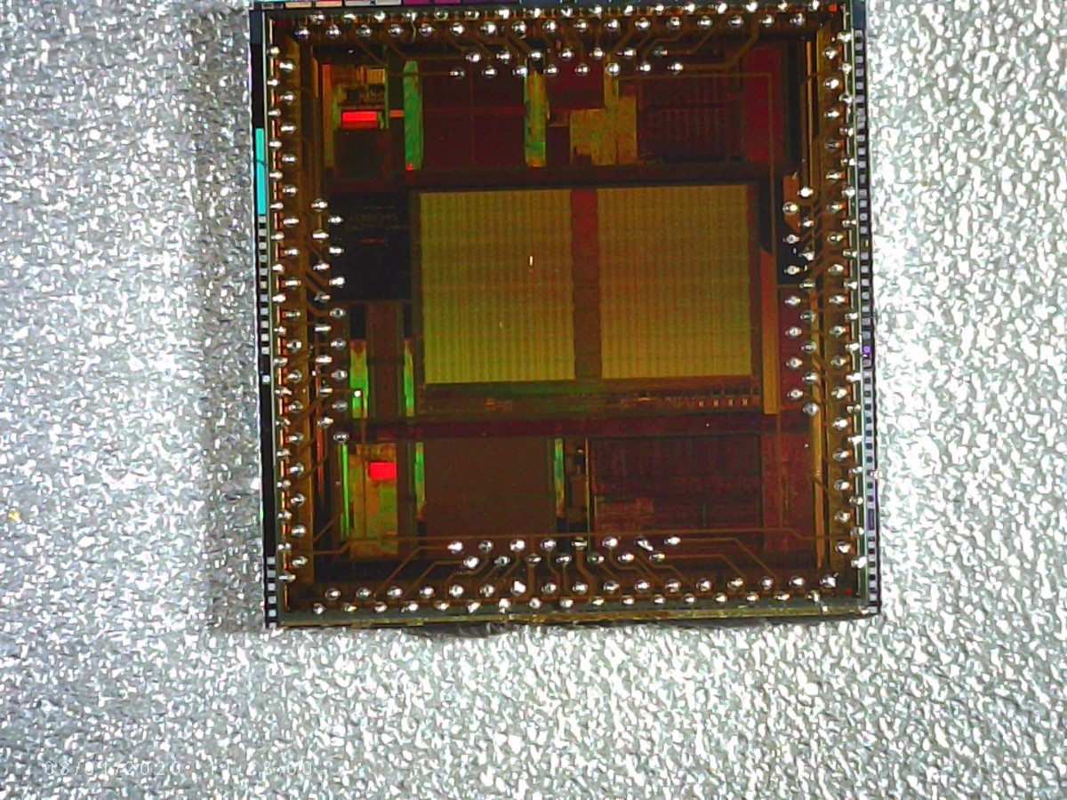

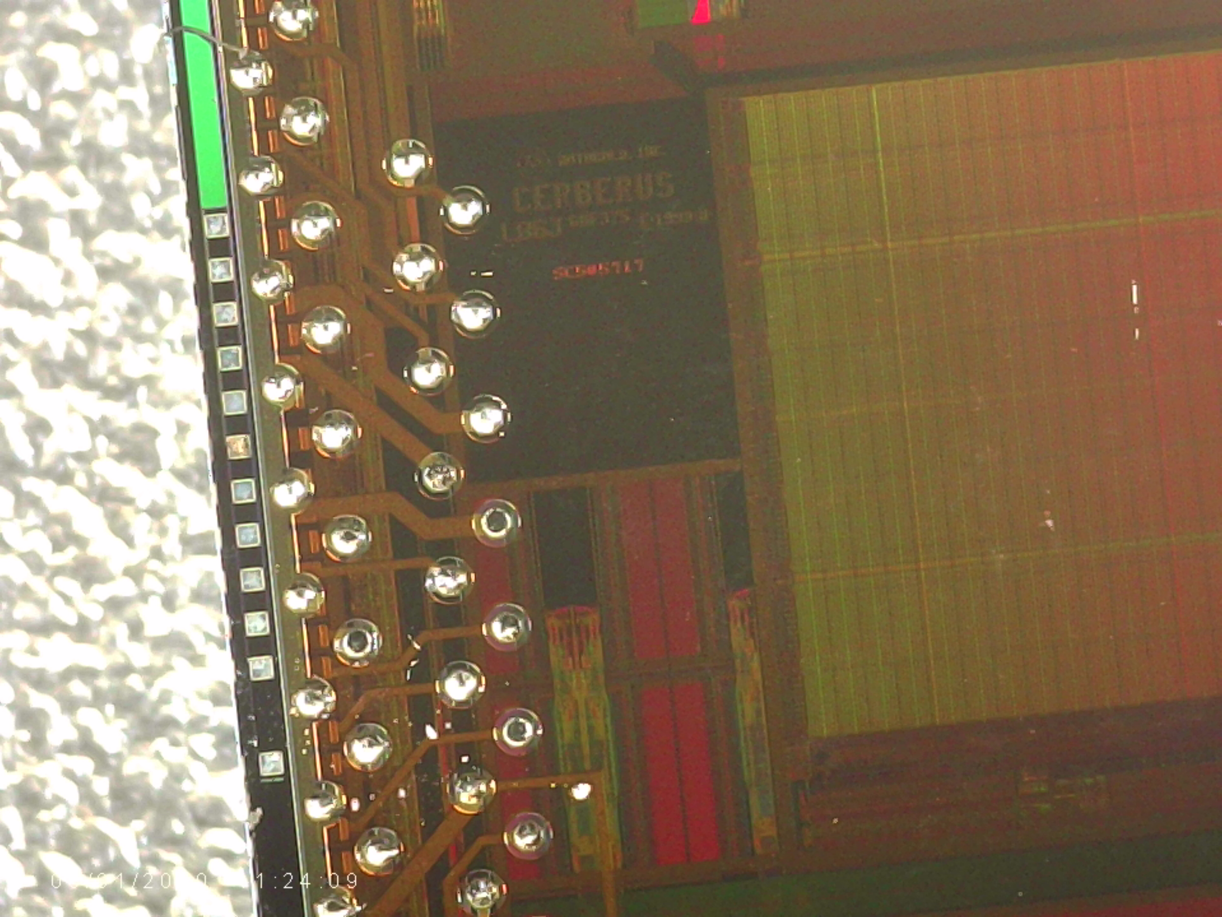

Update. I have pulled some flip-chips from the P12 PCM and observed them under a microscope. I haven't taken pics of the other chips yet, however this is the most complex flip-chip on the board.
