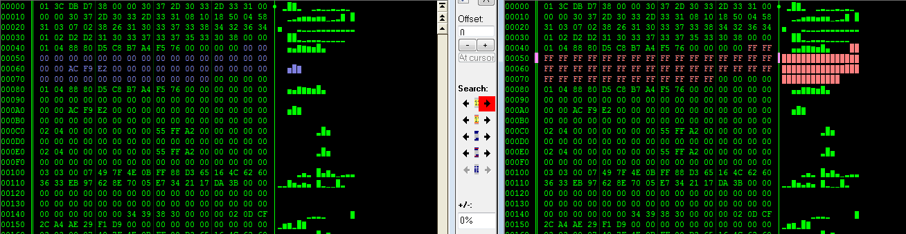

I also can confirm that it works, we have the ECU as a standalone now with no known issues (haven't hit the dyno yet)
The process was simple, BDM read EEPROM with KTAG, write Julespatch's IMMO off file from MHHauto, job done.
Having looked deep into this it appears that PCMflash can read the EEPROM via OBD, that will be the way I do this next time.

I found another thread relating to immo off on med9.6.1 and it looks like all they did was fill in the whole block with FF. I'm assuming you just have to disable some kind of jump?

Are you thinking this is code? I think its parameter data, and one or more of those fields are the VATS flag. First person probably just cleared a chunk of it and hit the right flags with a sledge hammer, next person narrowed it down better, but maybe there is only 2 or 3 bits that need to be set or cleared. Strange that one person cleared the data, the other set the data. I have a feeling both are not right, and we know the clear one is verified.

I believe this data is in a small stand alone eeprom of to the side of the main flash and ram, its not a logical place for code, and is not written at boot. Yes there will have to be code somewhere else, but this is about setting the flags.
