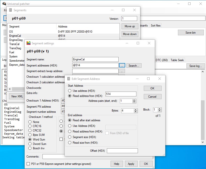

Re: Finding maps and tables in Universal Patcher
You can use GUI for segment settings, if not familiar with text-mode setup.
Patcher -> Open "Original file" -> Settings -> Edit Segment config (XML)
- Segment-settings-2022-06-03 065834.jpg (127.2 KiB) Viewed 3722 times
