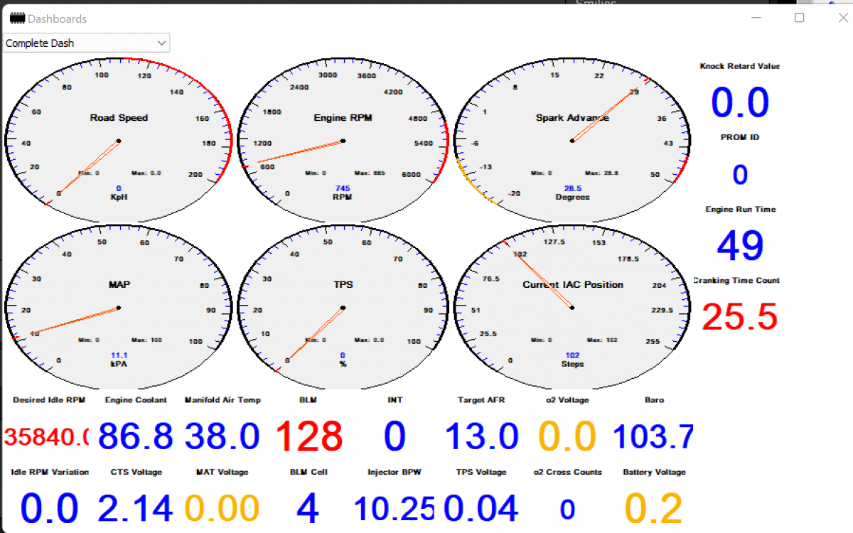

thats good news then! just on the wideband, do you know why i dont have it in my dashboard? Also there are a couple of issues with the displayed parameters, ie. MAP doesnt display (just stuck) but its definitely working, and desired RPM is maxed out.
obviously at this stage i need the wideband and MAP but i cant find how to display them correctly.
Thanks!

see attachment for detail

Looks like you have the wrong ADX loaded, check the XDF as well.
36,000 RPM! F**k yeah! :lol:

yep looks like youre right - managed to find the newer adx OSE_12P_V112 and that worked straight up!
finally making progress!
ill check the xdf, but happy that things are working now!
thanks again!
