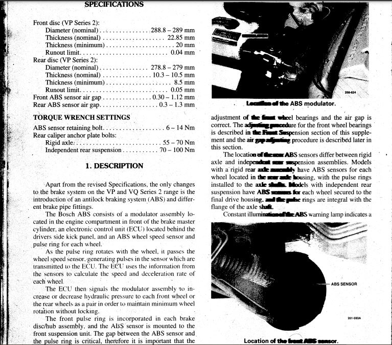

Just in case you don't already have this info. This is from my old Gregory's manual for vn/vp. Sorry for poor quality.

Vtxu8 thanks for those scans.
Got any scans showing what the gap for the abs sensor to ring should be

vp304 wrote:Vtxu8 thanks for those scans.
Air gap between abs sensor and pulse ring?
Front- 0.30-1.12mm
Rear- 0.3- 1.3mm
