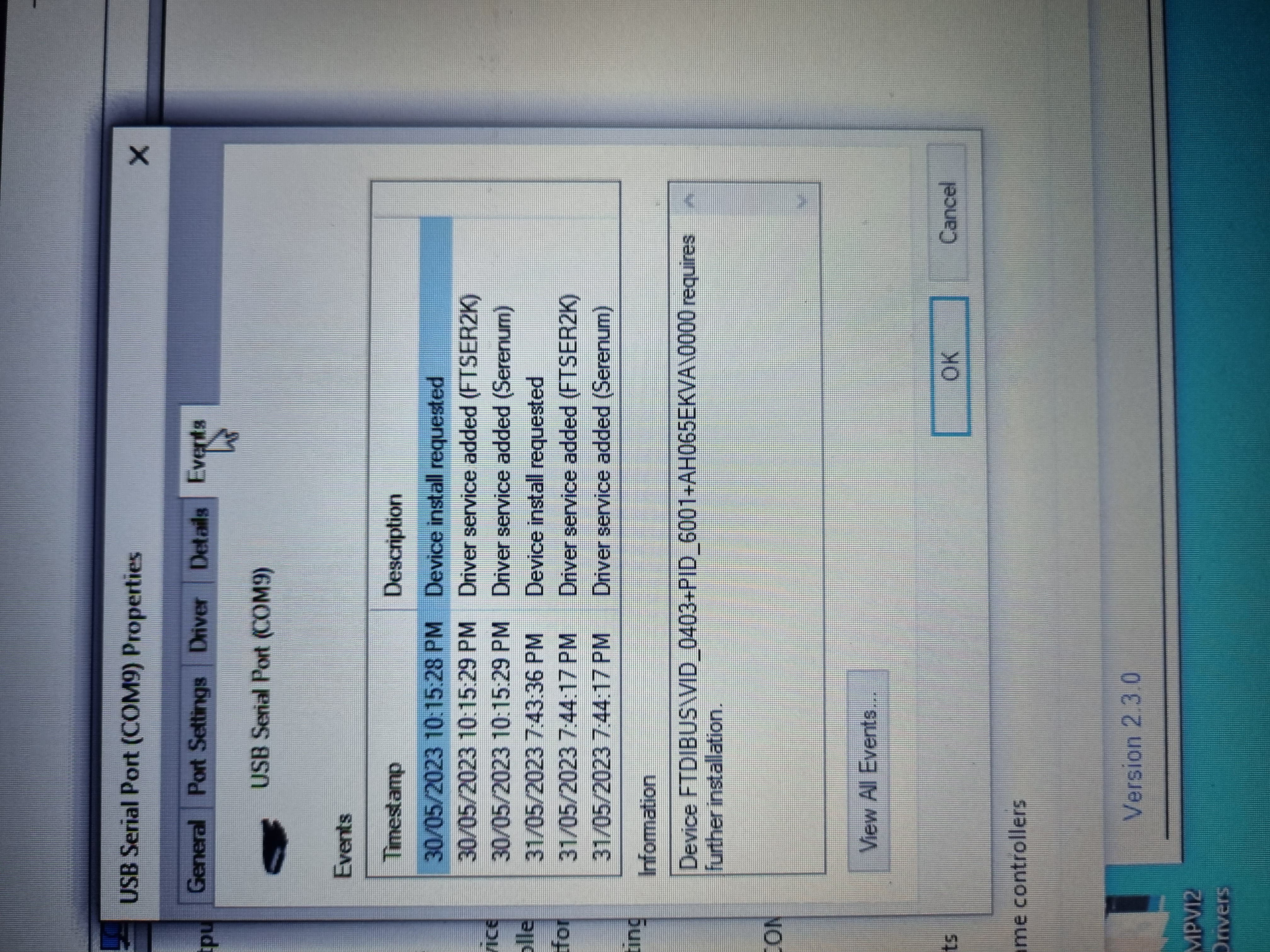

Will the cable I use for bmw stuff that I haven't used in ages or on this laptop. Says it's all working and drivers installed etc. Got my old bench loom out and can't connect to that now either and that setup was solid did many a dme back in the day. Only thing I've noticed is in properties > events in the information it now has \0000 requires further installation...? Could that be related to what you are talking about?

Yeah that could be a clone chip and drivers are detecting it and wont work with it. Its not a windows problem, I assure you that, unless you count WQHL drivers with clone detection in them. Its a hardware problem. You can google the subject and find random third party sites with old pre-clone detecting drivers and try that, but the risk is that it could have malware and do nasty things on / to your pc or your network.

Yeah that's kinda where I ended up. I found all the drivers that used to work on my old laptop and even with those which some are from 2008 it still doesn't work. So I'll go with all old cables I have are junk now. Only thing I haven't tried is running it all on a win7 VM which I have for Ford ids and some other things. But doubt that would help either.
