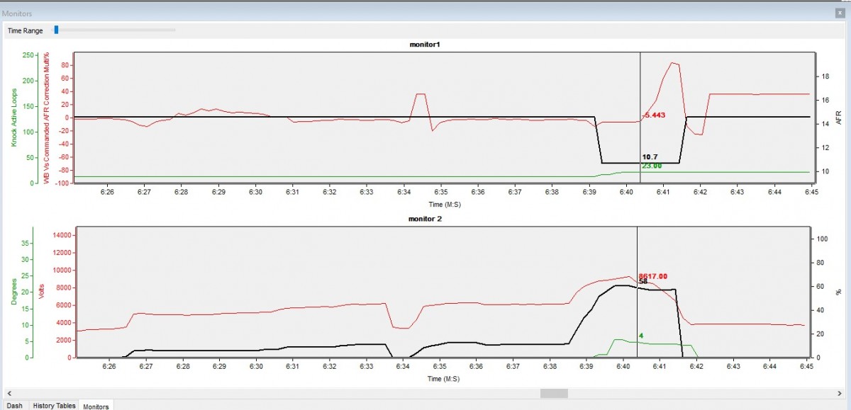

Charlescrown wrote:What I see in the graph is a problem with the commanded air fuel ratio not the actual reading from a wideband. Have a close look thru your tune at that point and I'm sure you will find it.
That's what I don't get. I can't see anywhere in the tune where it would command an AFR of 25.5. At that point the actual AFR goes to nearly 20. Which is the max limit readout of my gauge Spartan 3 WB kit.

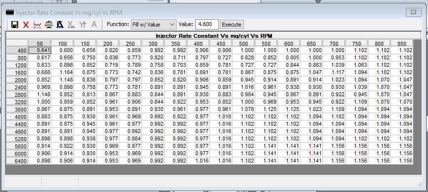

With The 1's Enhanced code, he has made the Maf tables linear up to 510G/s @ 16,000Hz and you don't really need to touch those table unless you go to a Card type maf setup where you would play with the maf scalars. At least, that's my understanding of it.
Instead, you use the INJ. Rate Constant vs mg/cyl vs Rpm table(after you set your Base Injector rate) to fine tune to desired AFR's. Plus there are many other variables that will need to be tweaked such as batt. offset etc. But that's the main table you would use.
inj.multi table.jpg (159.7 KiB) Viewed 3527 times

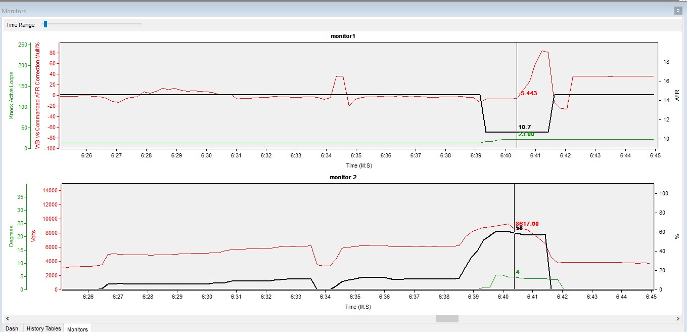

Adjusted PE tables and finally got the car to go into PE. This time at 40% tp. I still need to tweak the PE tables a bit as now the ECU is commanding 10.7 instead of 11.5 afr in PE. Better than 25.5 :D Goes to show you need to be careful of zeroing out parts of PE tables.
Looking back at the log I can now easily see I need to adjust my Inj. Constant table a lot in the higher end of the table as the car still cuts out and leans out badly. But I can now go over 50%tp and can see where she needs more fuel.
I do have a DTC 97 now (CCP Driver Failure). Is this an ECU or a mechanical issue with the Purge Solenoid?

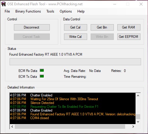

@The1.
I tried to flash whole BIN via OSE tool. But the 'Write Bin' option is greyed out. I'm sure it was before.
These are the settings i'm using in Preferences below:
EDIT:
Looking at the Flashtool instructions. It looks like you can only write Bin on 12p or Flash based pcm's. So I will need a re burn.

Went for a drive and logged it. I now have much better data coming through and can see that it needs a lot of work on the inj. multiply table in the high end. You can see when it goes into PE and is commanding afr correctly but it leans out dramatically at that point and basically cuts out until i back off the peddle.

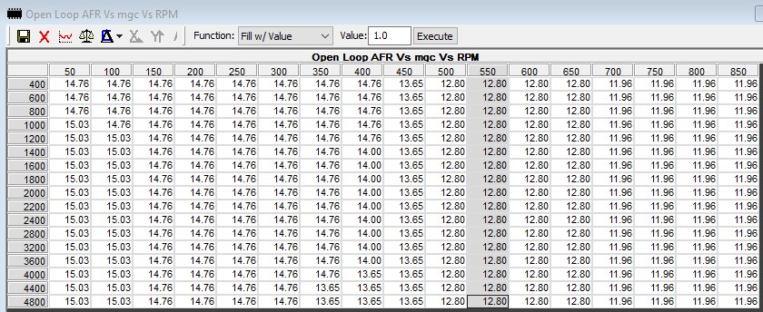

I have set Open Loop AFR's but in TP, The commanded afr is always showing 14.6 when it should be for e.g. 12.8 etc at certain points. Commanded afr will only change correctly when I'm in PE. Then goes back to 14.6 when it should be showing 12.8 or what ever I have set Open Loop afr's to. Is this normal?
So with that in mind. My WB CORRECTION AFR vs TARGET AFR History table is only correcting the fueling to achieve 14.6 afr instead of whatever I have commanded in Open Loop afr table? How do I adjust my INJ. Constant tables to reflect the afr's I'm asking for? Just get all the tables set correctly to achieve 14.6-14.7afr then add more adjustments after till I achieve the desired afr's?

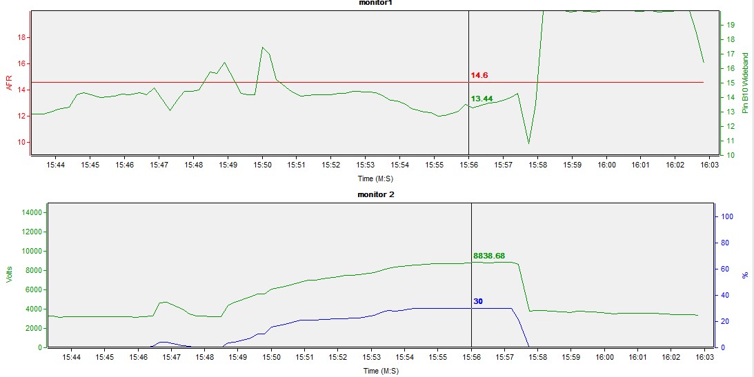

Looking at my last log.

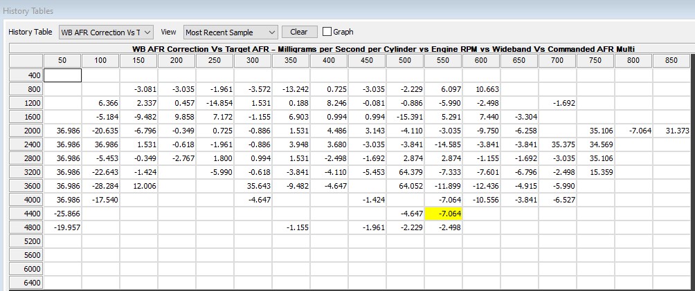

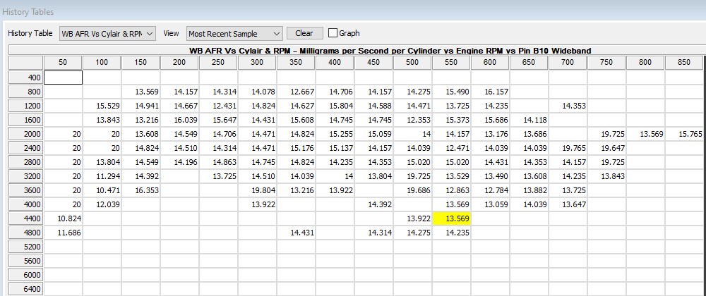

It seems that the ECU might possibly be stuck in Closed Loop. Right from the start I have been making my fuel adjustments based on my WB AFR Correction histogram table. I realised that the corrections are based on a constant afr of 14.6 and not what I have commanded in the Open Loop AFR table.
If you look below, you can see the WB AFR Correction table. And at the highlighted Cel it shows a figure of -7.064. The actual afr at that Cel is 13.569:1(pic below). Doing the simple math of 14.6-7.064% = 13.569(rounded to) or 13.569+7.069 = 14.6(rounded to).
new widebband correction.jpg (129.79 KiB) Viewed 3228 times
new wb afr table.jpg (135.62 KiB) Viewed 3228 times
At these points. The commanded afr is always showing 14.6 when it should be 12.8.
new monitor 12.8 afr.jpg (78.07 KiB) Viewed 3228 times
new open loop.jpg (145.78 KiB) Viewed 3228 times

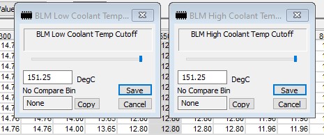

Below are the settings to turn off Closed Loop. But looking at them, I think that they may need to be set in the opposite direction.
E.g.BLM High Temp Cut Off should be set to 0 degC not 151 degC?
new blms.jpg (35.42 KiB) Viewed 3228 times

Posts: 9009
Re: Need help with crazy AFR issue with dead spot
I am not too familiar with the MAF stuff, but I think those BLM settings are temperatures that stop it collecting data for the long term fuel trim, not the closed loop. BLM is Block Learn Multiplier, which is your long term fuel trim (LTFT). It is possible that it affects more than just BLMs but you should check that. And I think you should be applying correction to the injector multiplier table, not an AFR table. If I am not right someone will correct me.
