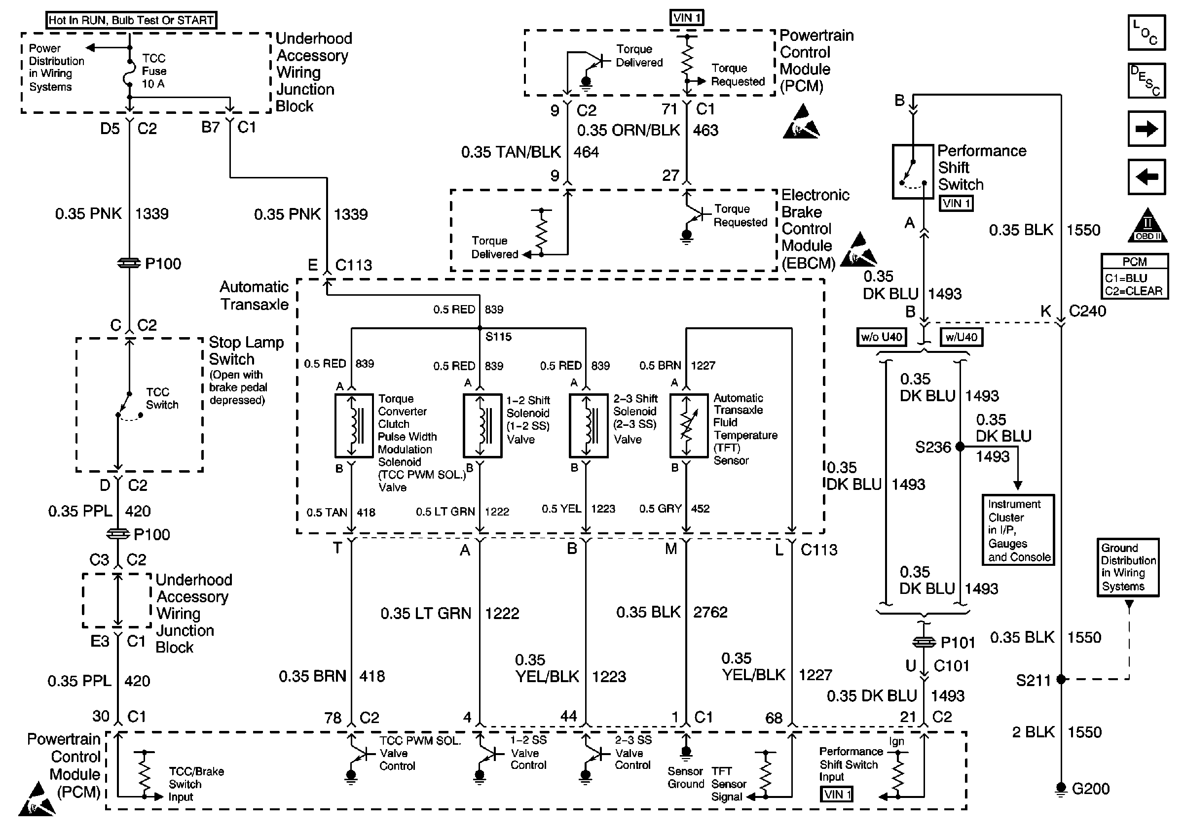

I think it is time to find the performance switch pin. I will dig for some schematics.

kur4o wrote:I think it is time to find the performance switch pin. I will dig for some schematics.
FFFFFD17 I believe is the 'MUX' read pin.
Just need to set the correct channel when reading it.

Maybe trace where it get saved and monitor that value.
Found some 2nd gear switch that use the same logic as 4Low/tow and performance switches. Might give you good starting point to figure all the inputs, tracing the board.
It is from 2002 v6 firebird pcm

FFFFFDxx is the address range for the ad in/out.

I mean when pcm read MUX it saves it somewhere as software register. Trace that software register, That manipulate different pins and monitor the software register. Usually you need to apply ground to some of it.

I got you. I followed that software register. There’s nothing else with that pin I don’t think. I’ll double check. I’ll look around for any pins that do weird trans options.

kur4o wrote:Maybe trace where it get saved and monitor that value.
C2 pin21 is the same pin used for the performance shift switch in a 2000 Grand Prix
Here's a presumably stock bin I have from a GTP, it appears to have the performance switch enabled if it's worth taking a look at one where it's actually used. I would recommend only using this for reference and don't attempt flashing it with PCM Hammer, I think this one has blank parameter segment.
